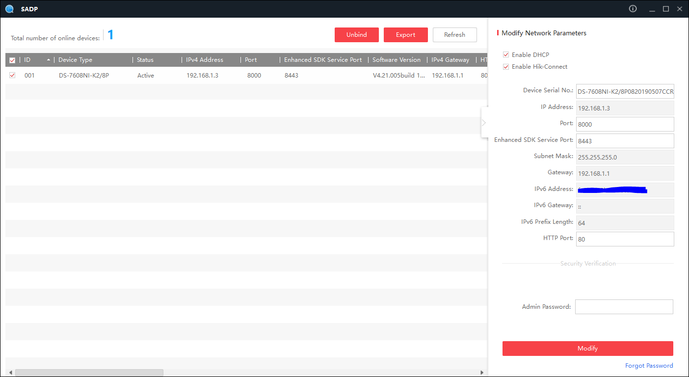

Can you download the SADP tool and send a screenshot of the home page and each of the camera's settings (by ticking the box for the device in the list) please?
Connected directly to the NVR.... NVR is connected to a switch that connects to the router. All other devices recover if the network goes down (i.e. say Virgin Media has an outage) - Echos, Ring Doorbells, etc all work after it. Just the Hikvision needs a restart to work again.

We would still recommend disabling DHCP because after a reboot or a network cycle all sorts of network settings can change and with DHCP disabled none of these settings will change. Once you have it disabled we would also recommend that you change the device's IP address to a completely different IP that is further away from the gateway's IP address, this is just so we can make sure the IP address is not the issue.
