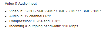

The model is Jovision JVS-ND7932-DV - 32-Channel Full HD H.265 NVR and the camera's are HIKVISION
Incoming & outgoing bandwidth is 150Mbps. Can you measure usage of that NVR? Maybe if you lower cameras bit rate?
