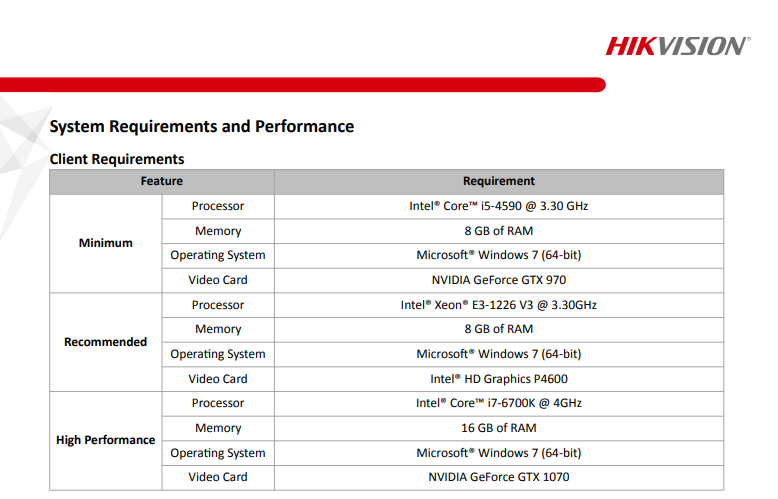

Hikvision's PC spec for running the iVMS-4200 client software is shown below:
(the full spec document is attached)

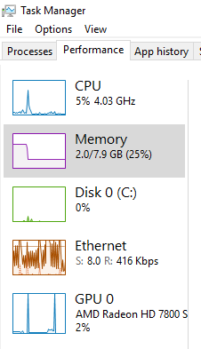

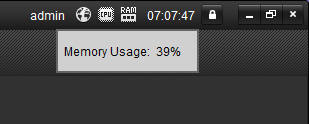

BTW - I'm not sure what iVMS-4200 is actually measuring in its system usage indicators e.g. on my home PC with the iVMS-4200 client displaying just a single camera it indicates that it is using about 40% of the system RAM:
Whereas Windows Task Manager shows that only about 25% of the PC RAM is being used:
