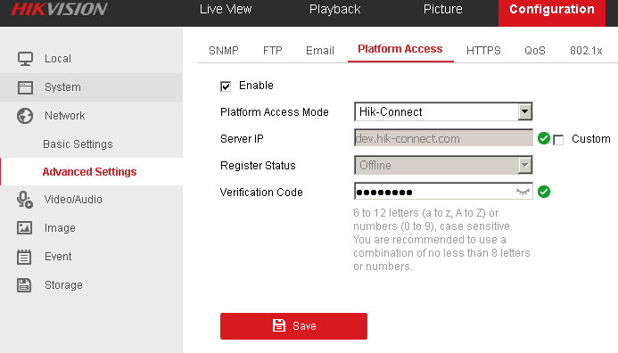

Enable Platform Access on the camera. Set a verification code.

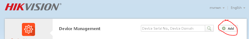

Go to:
Register an account.
Click Add
Enter the camera serial number and the verification code when asked. Give the camera an alias(description) and a domain if asked. I use a abbreviated description for my domains by the cameras locations. Open the Hik-Connect app on your phone and use the same login details you used to register with their website.

I used v3.54 hik-Connect
Platform Access is turned back on

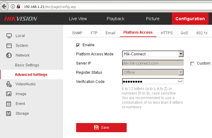

Disconnect your phone from your LAN, mobile data only. If you don't it will find the camera on the local LAN and might not work remotely.
Make sure your Platform Access is still enabled:
Open the EZVIZ app on your phone. It will ask permission for your location/access to phone ect. Set your location. Sign in with email and password (it didn't even ask me to register). Press Add Device and scan the QR code on the underside of the camera. Enter the verification code you set on the platform access page on the camera and add the camera.This actually worked for me, it didn't go via the Hik-Connect site. Hope this helps.
