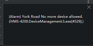

I seem to have reached my maximum devices but my understanding is I should be allowed more. Is there a way around this?
Currently I have 43 NVRs, each having 4 cameras and 16 Ax Pro's added.

Have you seen maximum devices stated anywhere?
What are you seeing that prompts you to believe that you have hit their maximum allowed limit?
Each time I add a new device to IVMS, i get this error in the bottom right corner. It does add it, but it is offline and I have no access.
