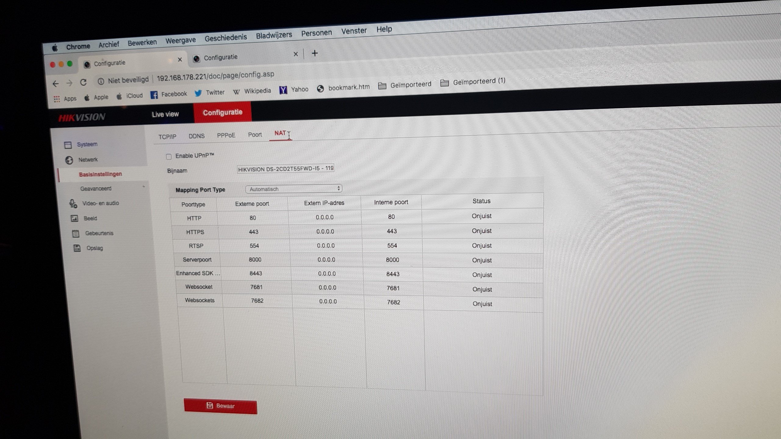

I can view the streams in my browser using the most recent version of Chrome. Maybe also good to mention that my IPC are running firmware version V5.5.83 build 190221 with Websocket enabled in the config. My IPC's are of the type DS-2CD2385FWD-I.

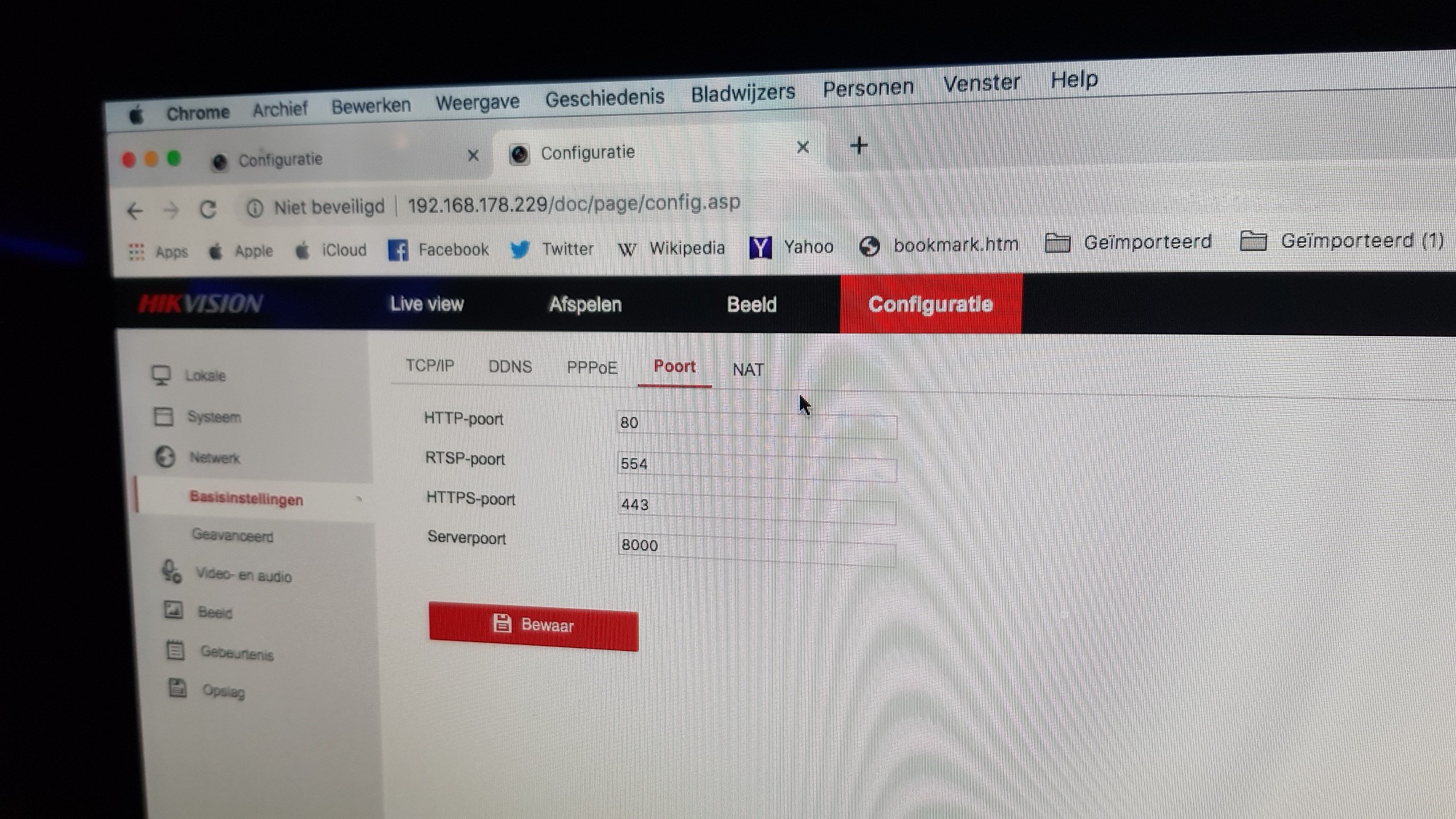

I also have the latest Chrome browser (V74.0.3729.131Official build 64bit).
However this behaves just like FireFox in that it only presents the in-page links Live View & Configuration (which both work).
Chrome does not present in-page links Playback or Picture.
Do you get all four in Chrome? (- ie HIKVISION logo Live View Playback Picture Configuration)

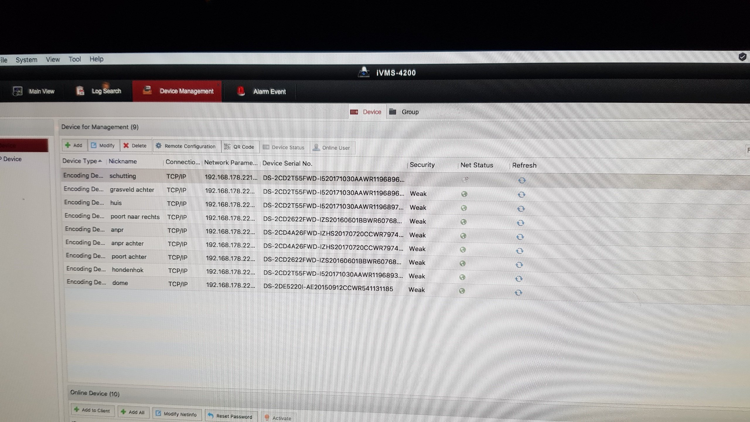

i have the same problem with firmware v5 5.82 build 181211 and v5.5.83 build 190221.
when downgrading the camera (DS-2CD2T55FWD-I5) to firmware version _V5.5.51_Build180314 the error is gone and the camera is working fine again. i see that they added a sdk port and some other changes in the firmware.
with new firmware i have live image in the webbrowser on my mac, on the old firmware no live image.
so it looks like they change some stuff, but i cant point the finger at the problem.
if you look at in the device manager the security status is blank, and netstatus grayed.
camera works on the recorder, hik-connect and webrowser but no on ivms for mac after upgrading firmware to latest version.

I have a same problem. But starter problem with disconnect every 20sec, I was thing upgrade to latest firmware, but problem not solved. Even one more problem added libHCNetSDK.dylib11.
Hikvision DS-2CD1323G0-I with base firmware 5.5.4, updated V5.5.92 build 190227 and have problem Code error libHCNetSDK.dylib11
my problem was solved to to a factory reset after the firmware upgrade.
the connection to the nvr and ivms4200 works ok now on firmware 5.6.0.
cam model DS-2CD2T55FWD-I5
