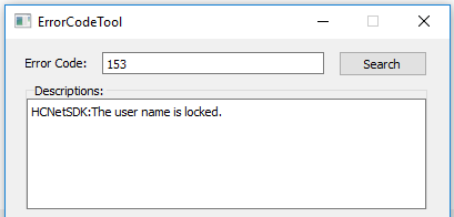

It was a stone alone system and connect it to a router and tried using the iVMS software and had these issues. So thought going direct from my Mac to the DVR would eliminate the possible incorrect router settings but I still get these errors connecting directly. I've tried logging out of the DVR and then using the iVMS client but still get this 153 error. I've looked everywhere within the DVR to see if there are any setting that would LOCK remote access as the screen shot you provided says "user name is locked". There is only one user and that the Admin.

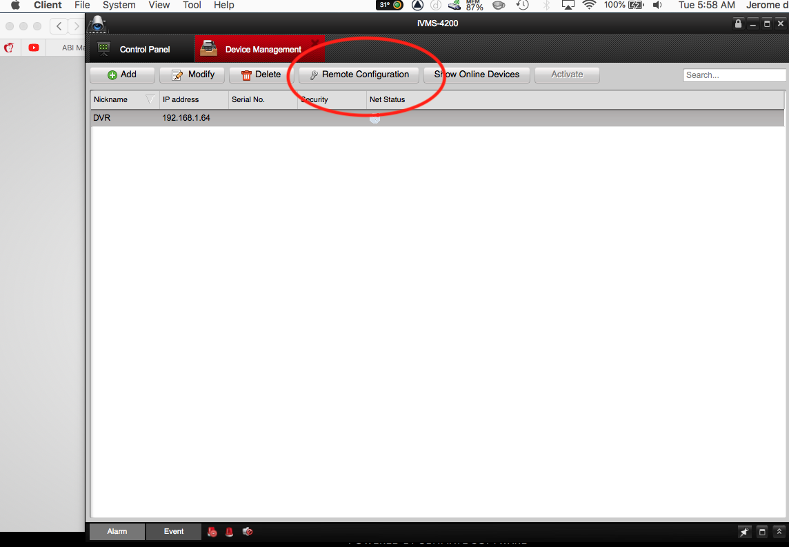

As per screen shot. I can change things with SADP Tool, but when I use the iVMS and "Remote Configuration" I get that error. I need the iVMS to see the DVR and associated cameras to view and retrieve video files.
Jd
