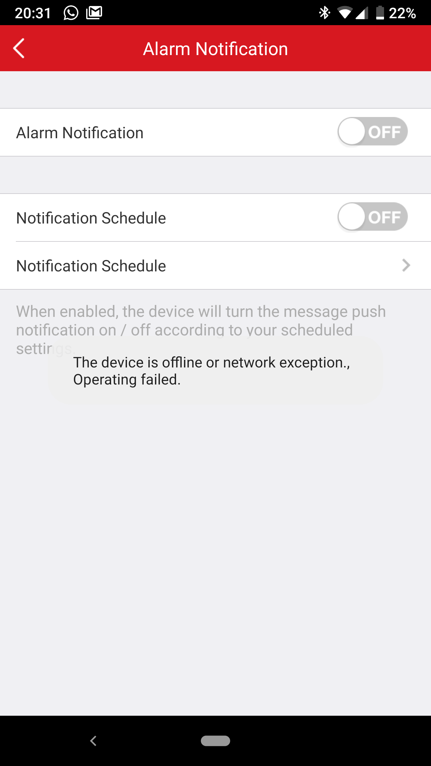

I'd like to know if anyone is experiencing any issues with the new version of Hik-Connect (3.7.6.0417).......... I updated my Android Hik-Connect app to the new version and I've been experiencing issues with changing Alarm Notifications ever since.
If I go into the settings for my NVR (within the Hik-Connect App) and try and enable or disable Alarm Notifications, I get the error in the attached screenshot. I also get the same issue if I try and enable/disable Notification Schedules or edit the Schedules. I find that once the error occurs, the NVR shows as offline for 10-30 seconds - I can also see the NVR itself going offline (it looks to be rebooting). Looks to me like there's an incompatibility between the NVR and the new Hik-Connect app version which causes the NVR to crash & reboot whenever I try and do anything with Notifications.
My phone is an Android Pixel XL running version 9 (5th April 2019 Security Patch).
The NVR is a DS-7604NI-K1 / 4P(B) running firmware V3.4.100 build 180310
I tried lots of things with the app - clearing cache/data, re-installing etc. Nothing helped. I've now re-installed the older version of the app (3.7.4.0308) and all is working normally again. I've logged it with Hikvision support and they're passed it to their 3rd line support.

Thanks Phil. I've tried the new app version on a different tablet that I have and the same issue occurs, so not directly related to my phone. If I re-create the issue while I'm stood by the NVR, I can here it rebooting and the HDD stopping/starting, so it does appear to be something in the new version that causes my NVR to crash/reboot - maybe it's specific to the (B) at V3.4.100.

I have the same issue with my NVR B series and the Android App. The I phone app is fine as are the other series NVRS
