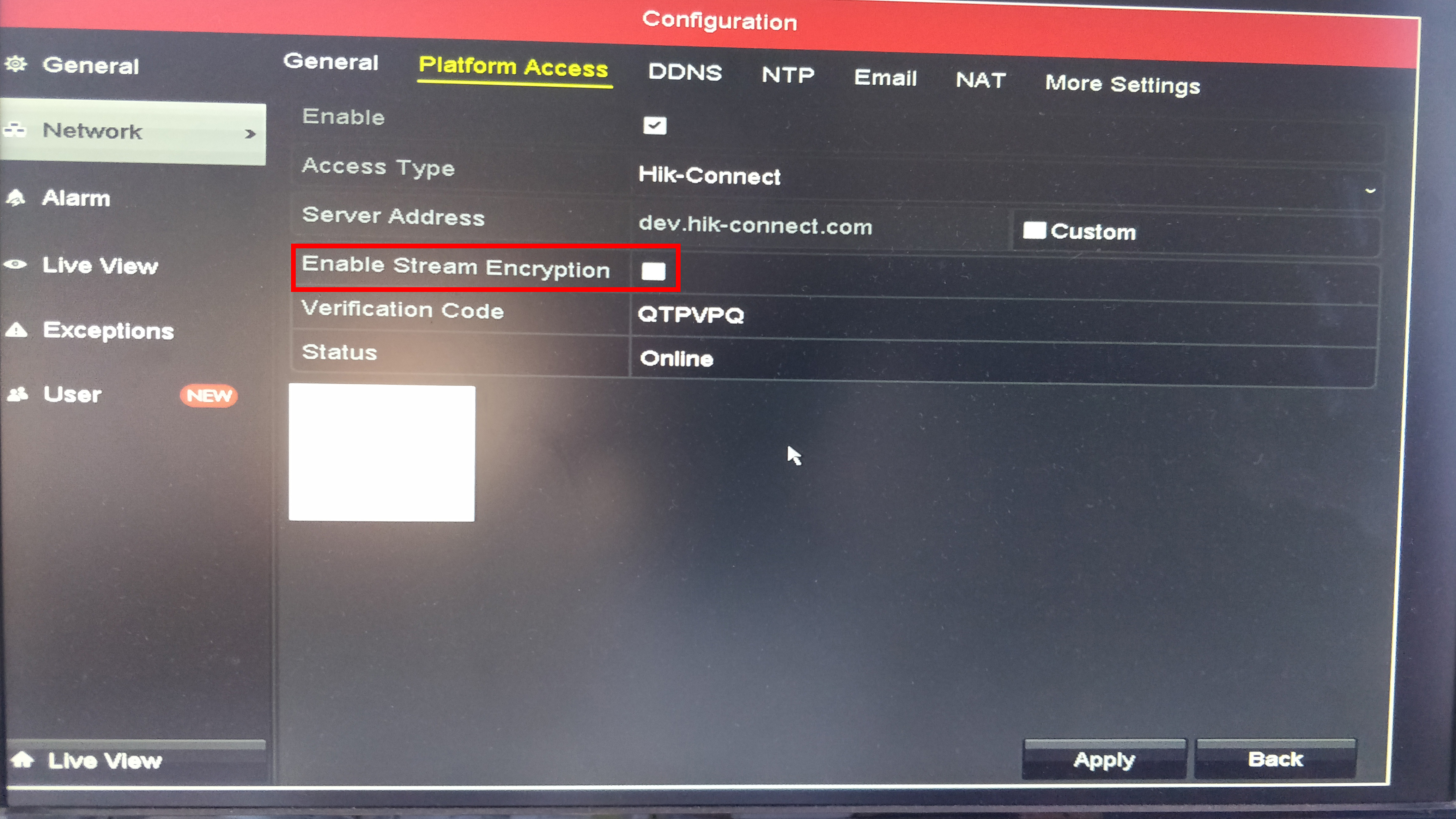

If you have an existing system that is already encrypted and you now want to access that NVR via 4200 on a Mac you will have to disable the encryption key, to do this you will have to access the NVR via a directly connected monitor. When logged in via a monitor you will want to go to Configuration->Network->Platform Access where you should see a page that looks like this:
You will want to make sure the Enable Stream Encryption tick box is unticked and then click Apply, now when you return to the iVMS-4200 software you will now be able to live view & playback the cameras connected to the NVR.
