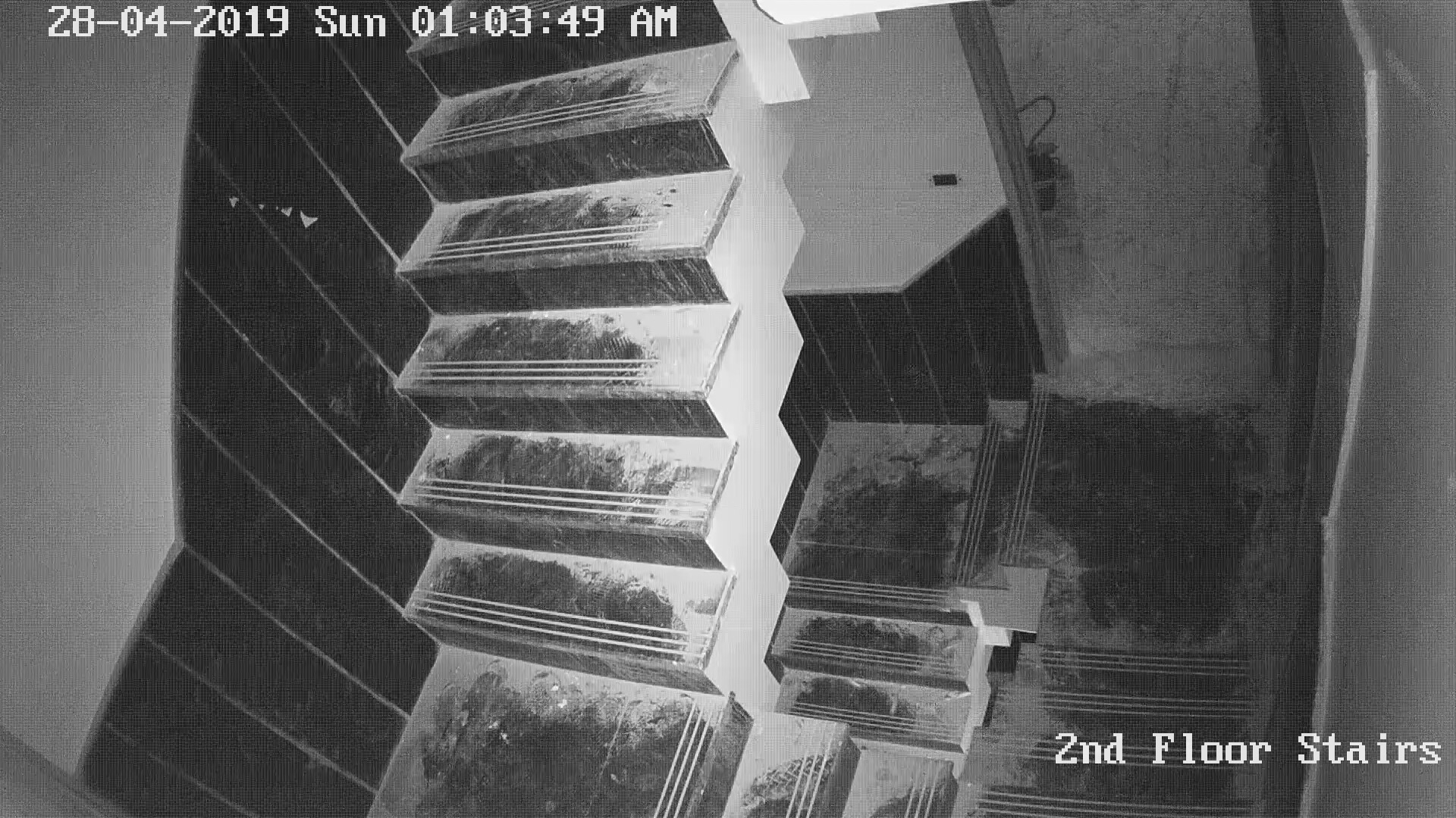

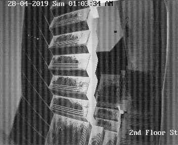

During the day I get amazing clarity on the cameras. But during the night the cameras start out clear and fine initially, but in about 20-30 mins a few cameras start developing vertical lines. Please find pics below.
This is the image when the night vision starts. Its clear and absolutely fine.
After a few minutes, this starts happening:
This is the non-HD version:
This is the HD version of the same:
Can someone please tell me what's happening and how to solve it?

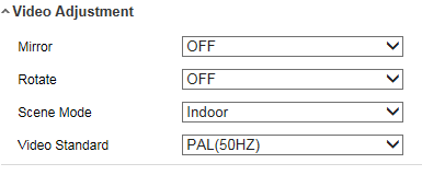

Numerous possibilities come to mind. Firmware not being up to date is always a good bet. If you want something to try immediately, change the Video Standard from the camera's webGUI.
2101
Hi StewartM,
Thanks for your reply. So this setting will be available when I access the camera via its IP address?

My first guess would be a cable issue.
Test a problem camera with a short/bought patch lead.
