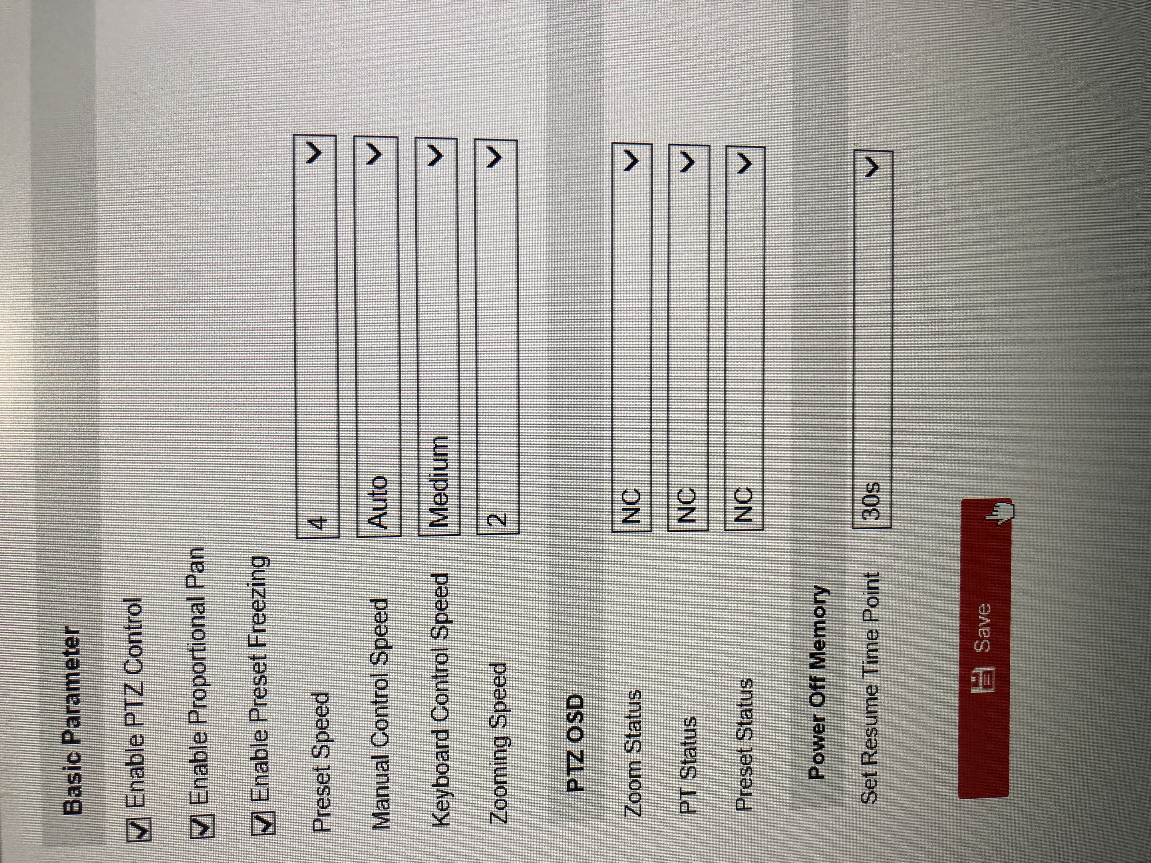

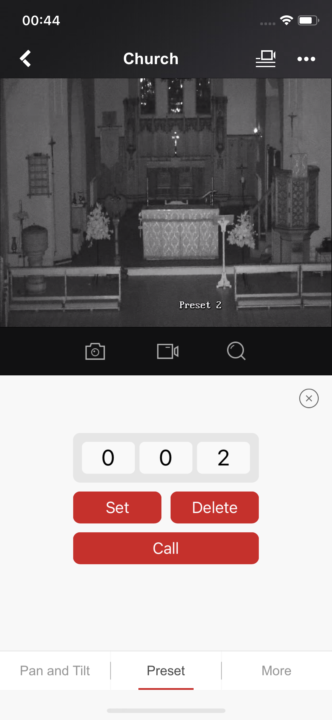

I've set up some presets - so that the local vicar can change scenes as he's working his way through the service - but have noticed that the 'preset' number appears on the screen of all streams when operated. Is there a way to switch this off? It's the first PTZ I've had that shows this info on screen - and I don't want to see it. Any ideas or suggestions?
I solved this - I finally found the right tweak to keep it off the OSD.
Hi @cymruchris
That's great, can you please share your solution? I am sure there will be others on the forum interested in this solution.
Hi @cymruchris
It was in plain view - although I missed it - ptz osd - although it’s not the ‘no’ setting from the drop downs but the ‘nc’ setting. This can be found when accessing the camera directly through its own IP address:
