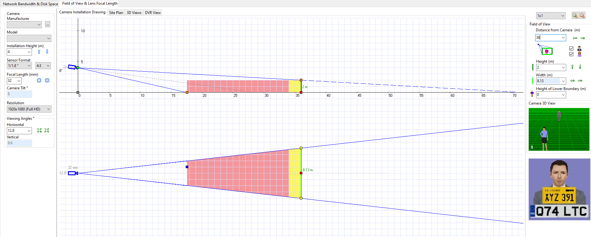

Phil Administrator Staff member Messages 5,170 Points 113 May 11, 2020 #2 Hikvision's 7A26 ANPR camera with its 32mm focal length option should be OK. Hikvision DS-2CD7A26G0\/P-IZS 2MP ANPR Varifocal Bullet Network Camera The 8m scene width at a distance of 36m is a bit wider than ideal, but the cameras function so well that I'm confident it'll be OK.

W webboc Member Messages 9 Points 3 May 11, 2020 Thread starter #3 Phil said: Hikvision's 7A26 ANPR camera with its 32mm focal length option should be OK. Hikvision DS-2CD7A26G0\/P-IZS 2MP ANPR Varifocal Bullet Network Camera The 8m scene width at a distance of 36m is a bit wider than ideal, but the cameras function so well that I'm confident it'll be OK. View attachment 3796 Click to expand... Hi Phil, that's great and thank you.
