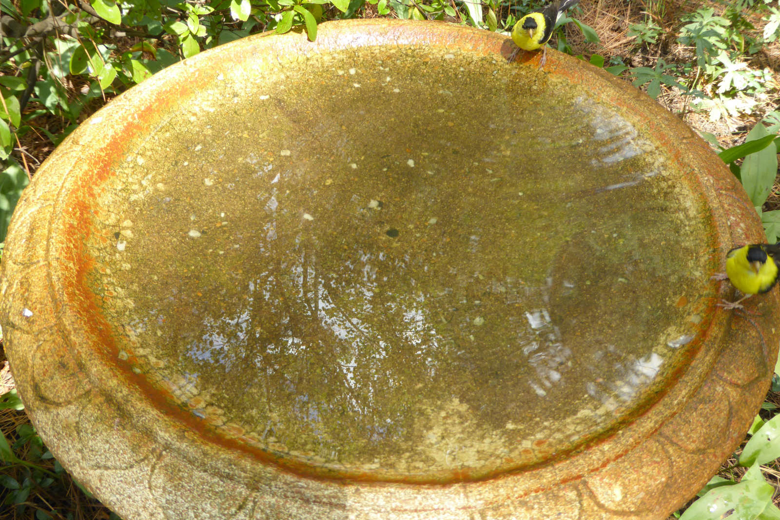

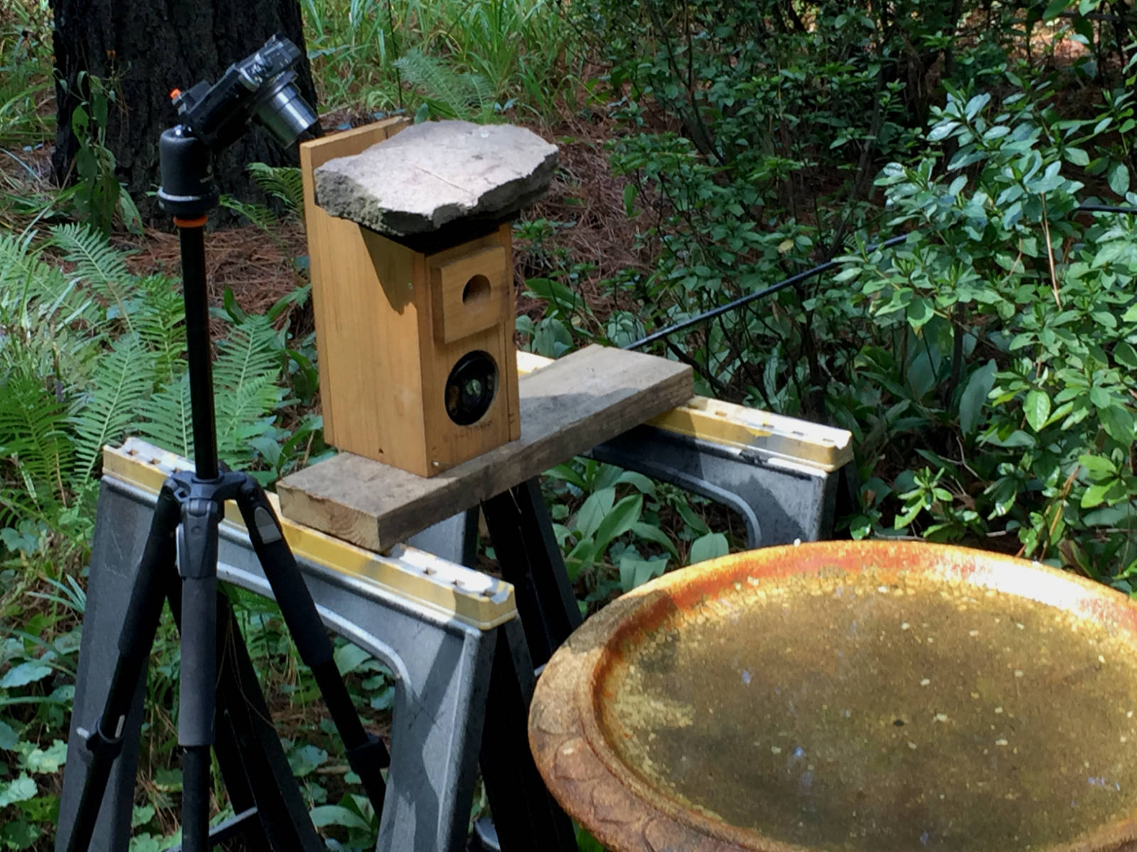

Focus... My response to the same question I asked myself was - 'Let's try something!' I tried a simple remote control via iPhone of a Panasonic DMC-TZ71. (I brick'd that cam with sand at the beach and replaced it for <U$70 off eBay...I liked it so much I bought a second TZ) You can see it on the tripod. The downside to the Panasonic - you have to be available to take the pic.

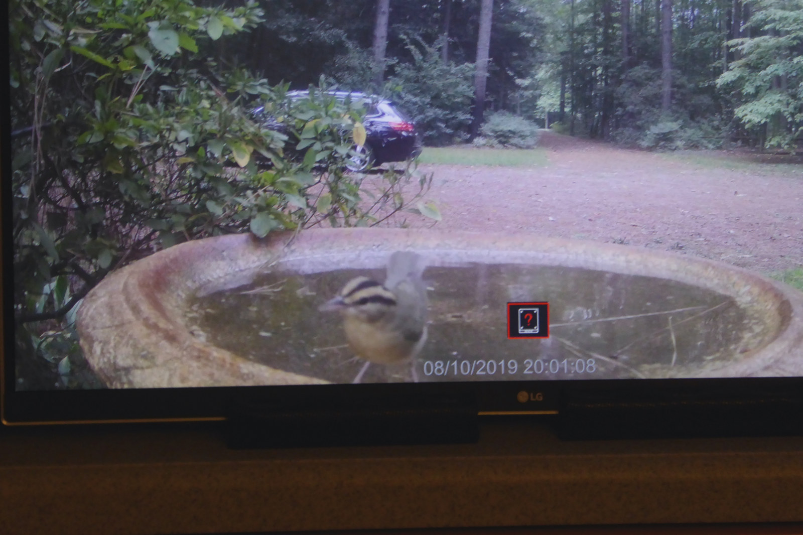

The second was a simple placement of an inexpensive IP cam in a box at the bath. It is a direct feed to a 27" monitor in the kitchen. I will revise that this Spring with 4K and am attempting to talk my wife into allowing space for a 43" 4K TV as a monitor; it eats a lot of room in a small house. Got for it ...we discovered a different crew comes to the bath vs the feeders about 5m apart? Birds are a pleasant diversion from the world outside our gate.
