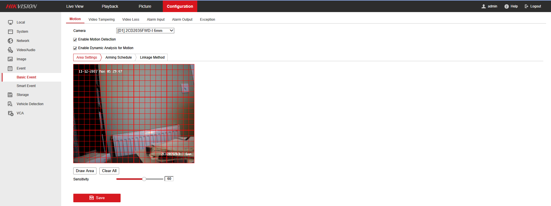

Have followed all that I can find, even though the documentation doesn't quite match the firmware
An explanation here on why the HikVision documentation (user manual) doesn't always match the settings you see in your camera / firmware:
https://forum.use-ip.co.uk/threads/motion-settings-help-required.1474
The online help accessible from the camera's Configuration area should be correct for the camera / firmware (Help button at top-right):
Lots of helpful videos at HikVision Tech Support's YouTube channel - Hikvision Technical Support
