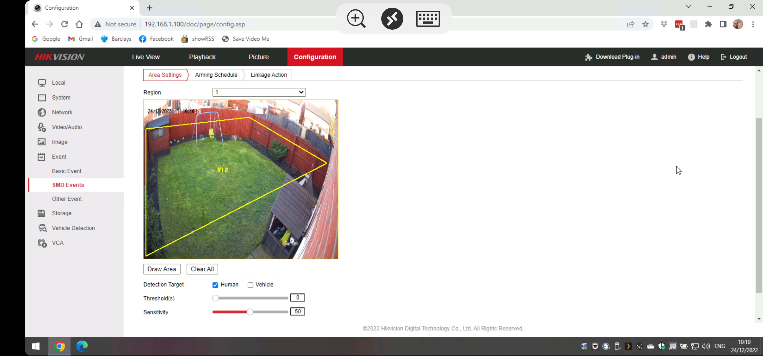

I've recently installed a DS-7604NI-K1/4P NVR along with 2 x DS-2CD2347G2-LSU/SL and 1 x DS-2CD2387G2-LSU/SL cameras.
I've setup intrusion detection for a defined area as shown on the attached image and ticked the human box but for some reason I'm getting instrusion alarms when the outside flood light illuminates and I can't work out why. There clearly aren't any humans or even animals in the playback when you look.

I'm not sure what would be causing the initial trigger. AcuSense isn't perfect by any means but it does eliminate a huge number of false triggers. Try altering your shape to exclude the swing seat maybe (anything 'Human' shaped could cause a trigger)
I wouldn't normally use Intrusion Detection with a Threshold value of 0. Threshold is how long the target object needs to stay inside the defined area before the event triggers. Having it set at 0 will be little different to using Motion Detection with AcuSense Try setting at 1 or 2 (seconds) and that could well eliminate the false trigger if the camera is triggering at the moment the light comes on.
Additionally if you log into the camera directly AFTER you have set the options via the NVR you can further fine tune it by setting a minimum object size for the target (make that minimum slightly smaller than a person appears while stood at the extent of the configured Intrusion zone) and a maximum object size (make it slightly larger than a person stood at the near point within the configured zone)
Thanks for the reply! You hit the nail on your head with the the last paragraph. I set the min and max size and it seems to have sorted the issue out. Light can go on and off and nothing is detected but as soon as I walk outside it detects me so seems like it's job done, cheers.
