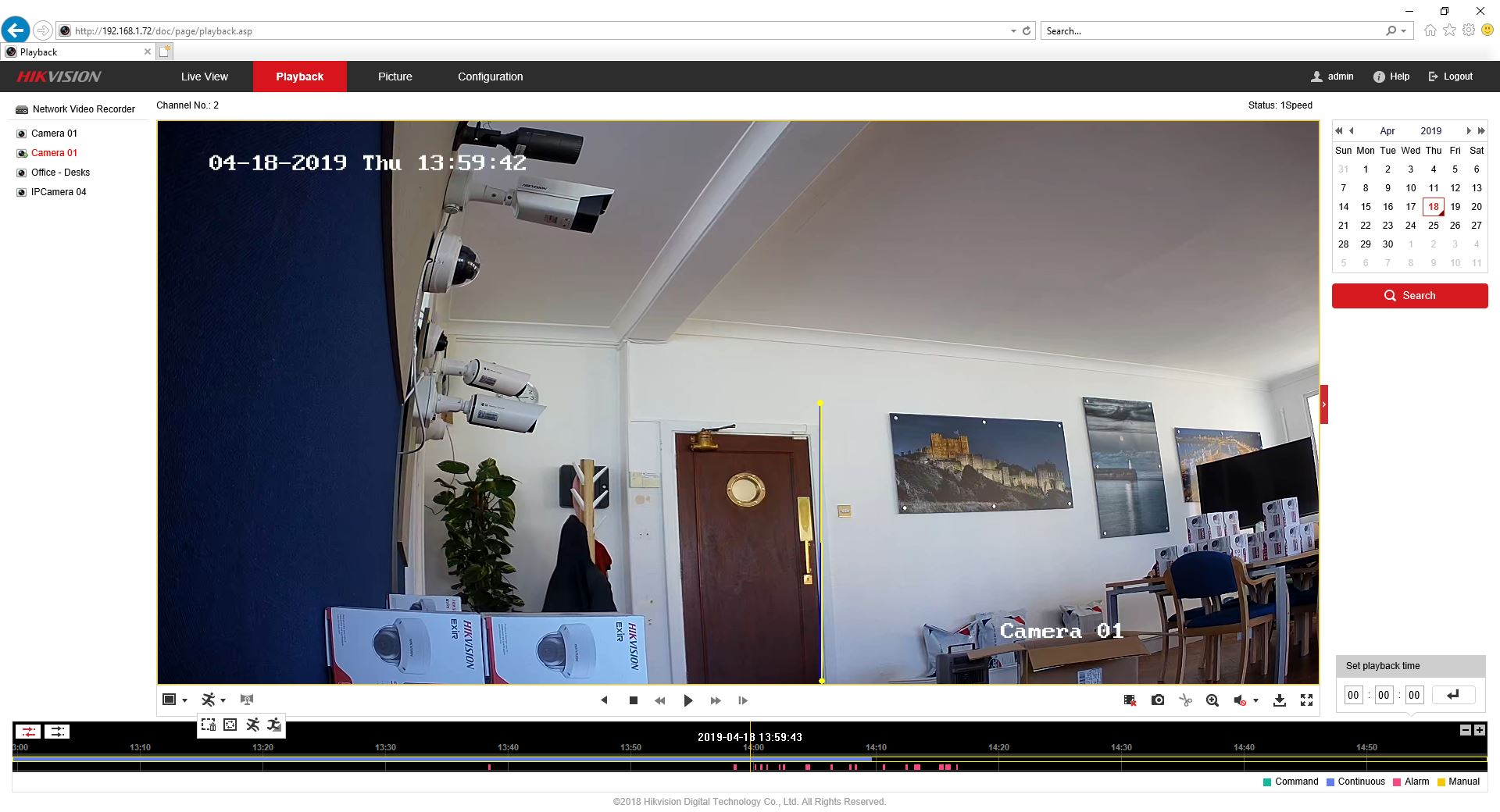

Dan, we're on two different channels. I'm not wanting to see the overlays for events. Let me see if I can explain a little better:
You go to the playback screen and pick camera 1. At the bottom of the screen is a long blue line at the bottom that represents 24 hours worth of recording. In that blue line should be little red lines that show every time a smart event occurred. That allows me to go right to that time period and view that footage.
My blue line at the bottom of the page does not have any red lines showing smart events. Yes I have rules enabled. Just no event markers in the playback mode like I do when using the monitor attached to the NVR.
I don't think we are on two channels - if you take a look at the above link I just shared with you you will see the below screenshot displaying exactly what you have just asked to achieve, as well as some text explaining how to do it.

Apologies, I think we may have answered this in another thread, Hikvision support reported to us that they were removing the event markers from playback to improve the stability of the browser access. So you can now only navigate through playback by events when you view from a direct monitor using the Smart/Custom playback options.
The only way to see event information in playback on the browser is to set the camera to record by event instead of continuous.
