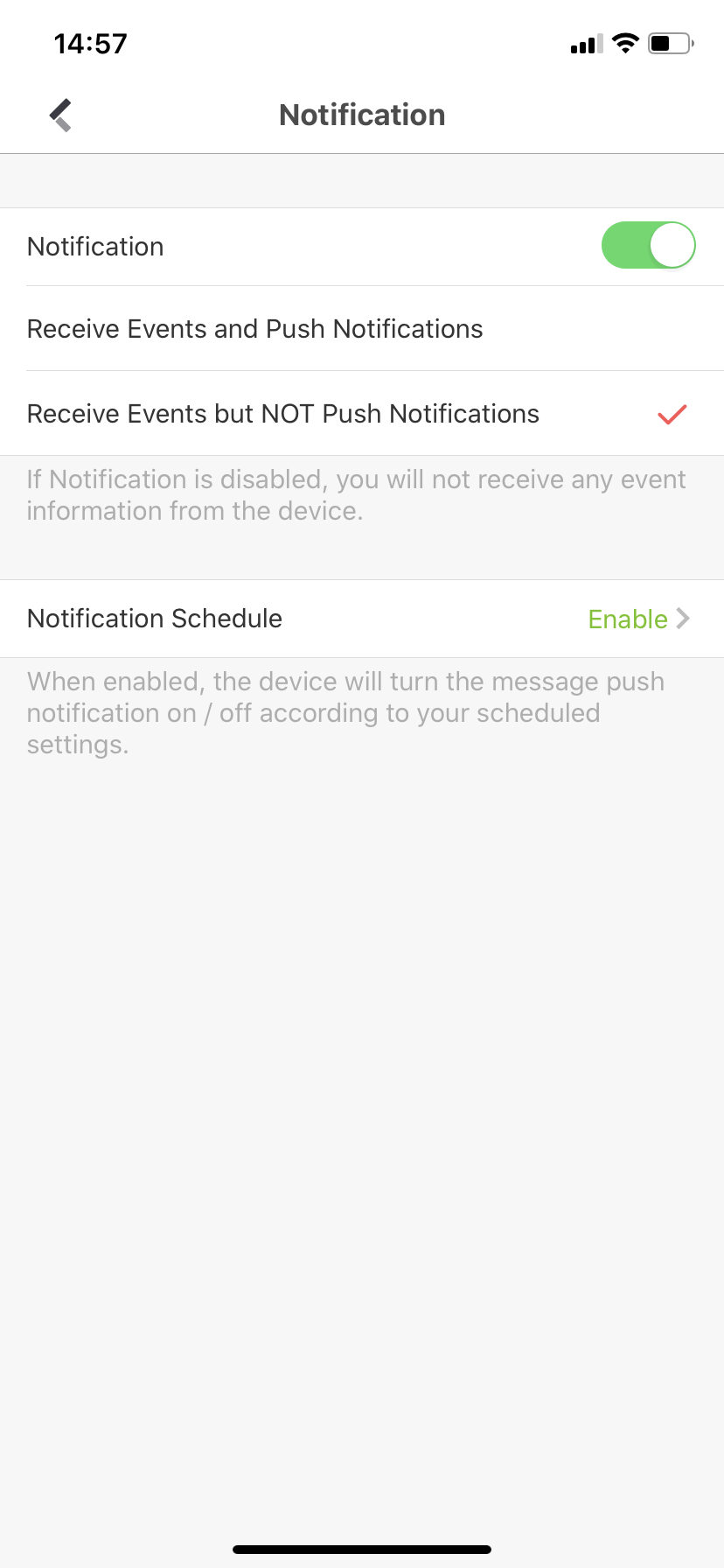

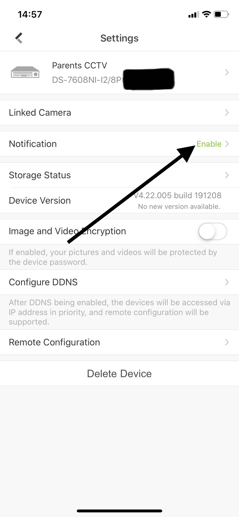

I have mine on NOT push notifications and mine has never reset back to notifications after midnight. Not sure how to get that on, this would annoy me to be honest having to turn it off every day. I would rather just go on the app and enable it myself as and when needed.

So, I've been testing this and the setting definitely doesn't reset overnight. Which is actually good (I would be annoyed if I have to keep switching it off every day).
I tried disabling push notifications (just kept "Receive Events but NOT push Notifications") or disabling Notifications completely. In all cases it stays that way
