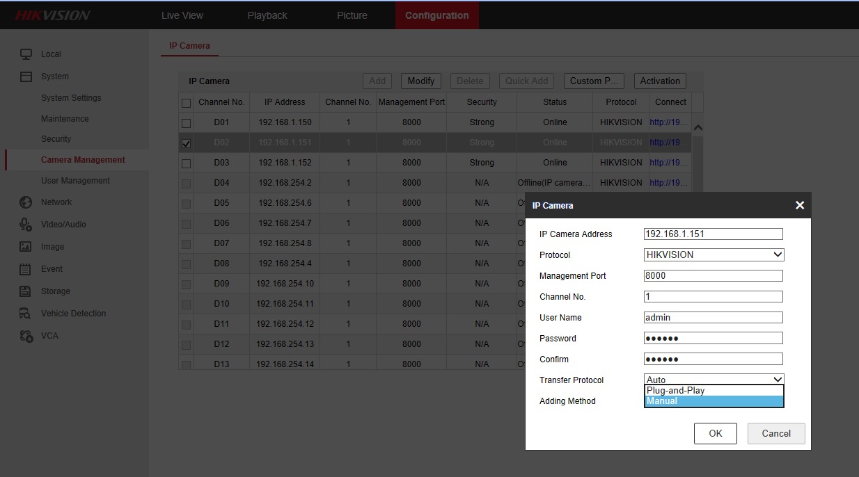

Ok I got the above and my nvr sees them but says can't add anymore ip cameras! ?
I only have 1 wired attached working
Hmmm can a wifi router be plugged into a camera port then connect camera to that wifi network ?
Connect them to your LAN (wired or wireless)
Add the cameras to your NVR by changing from 'plug & play' option to manual adding.
Thanks. Der me obviously just point the ip addy of the 1 of the 4 onboard ports to lan addy of cam worked straight away . How can you hide empty cam on scrolling screen view ?
