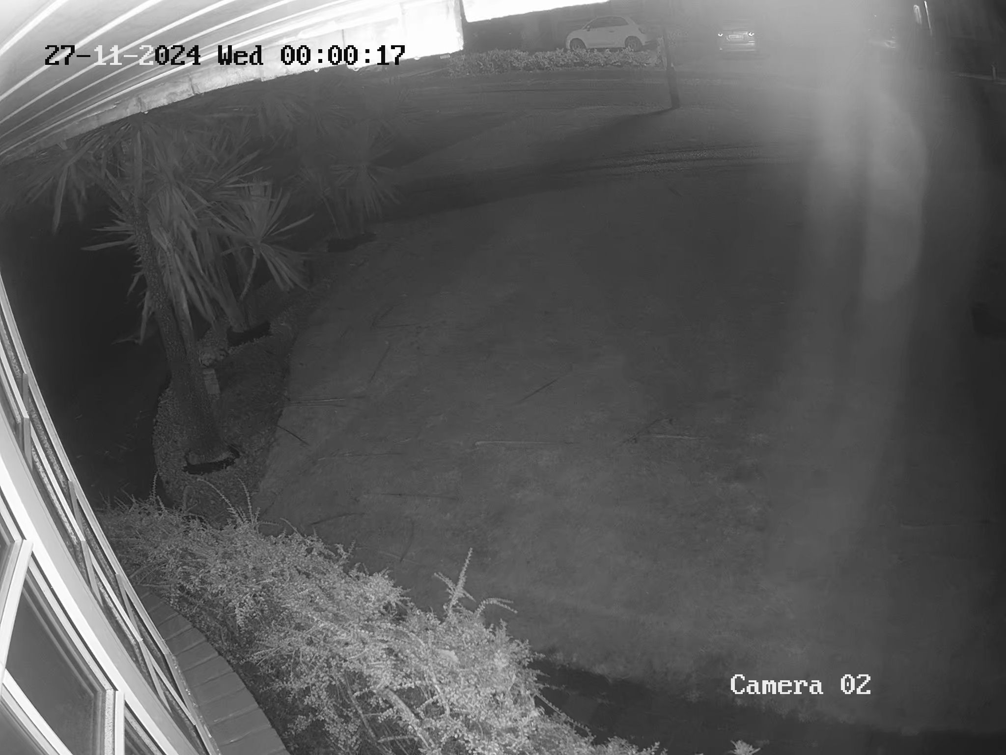

I think I've managed to insert a couple of images as requested. I need to pop out and give them a bit of a wipe over but that won't improve things much. I think that you can get the general gist of things.
Thanks @Bluenose1940
With the first image (Camera 02) I can see that a lot of the IR light emitted by the camera is bouncing off the edge of that overhang/soffit, any hot spotting like this close to the camera will definitely make the rest of the image darker.
If you could adjust the camera's angle and/or position to remove all of that overhang/soffit from the camera's field of view I think you would see an improvement in the camera's IR performance.

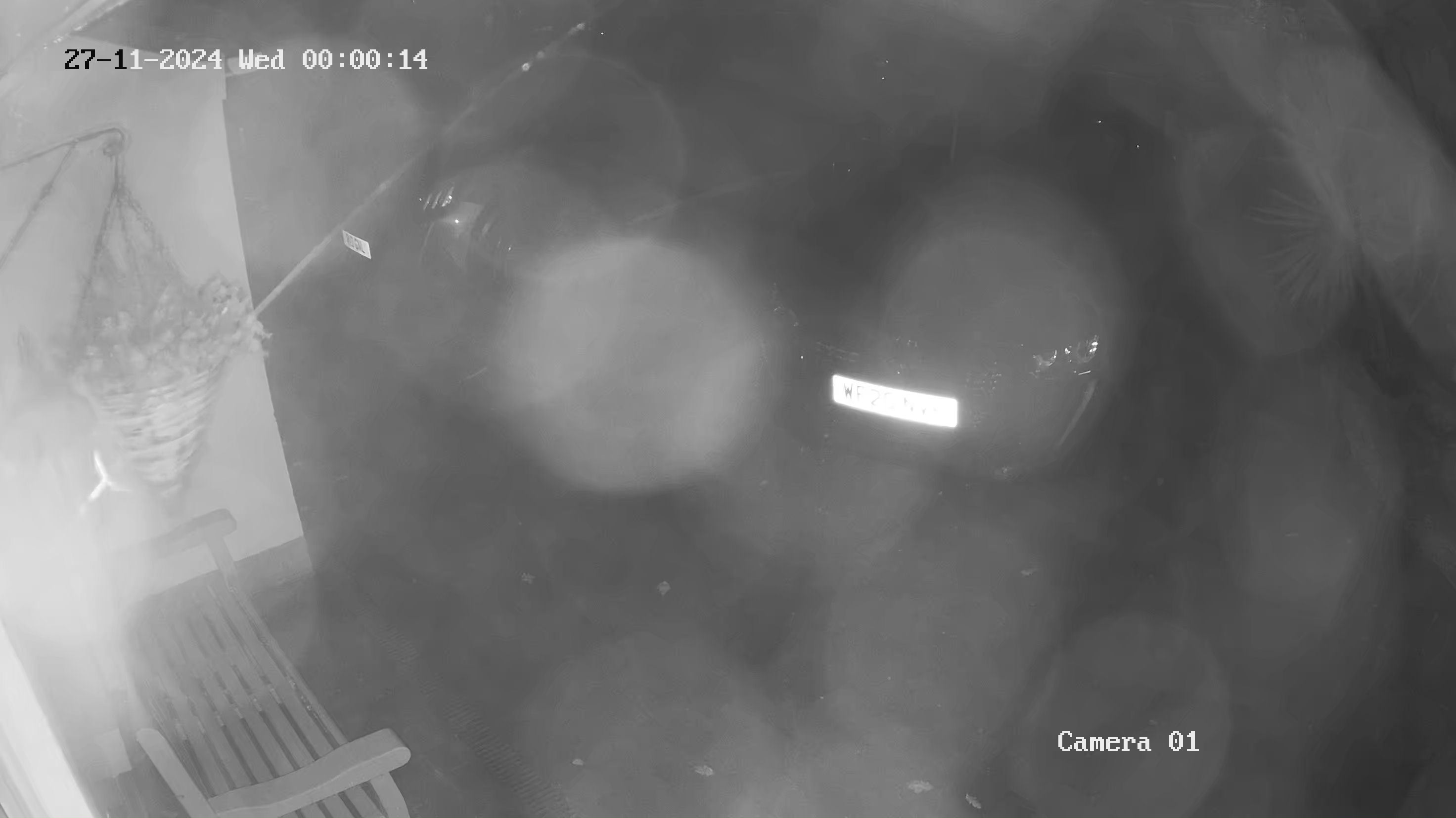

A similar situation with the 2nd image (Camera 01), that looks like the 2155FWD model because the moisture/dirt collecting on the curved dome is a common issue with traditional dome cameras.
Those marks on the dome will also reflect/bounce the IR light in strange ways, this will reduce how much light reaches the scene and like with Camera 02 make the whole scene look darker.
You could potentially add an IR illuminator, but these can be quite expensive and due to the resolution and specs of these older camera models I don't think the improvement would be as significant as if you bought new Hikvision cameras with improved IR, sensor, and lens technology specifically developed to improve IR/low light performance.
Thank you for your valuable input Dan. I will pop out to give them a bit of a clean and will also adjust the angles slightly too.
Thanks again.
