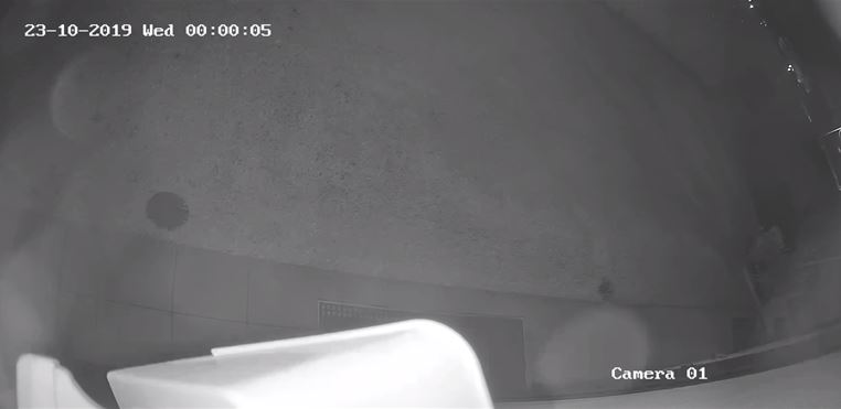

Hi both, I played around with WDR again. I realized that setting it "Auto", the results were really poor (I'm actually not sure if the camera was able to turn it on). I set WDR to "ON" and the result dramatically improved (the quality is great also at night). Now I still have a problem with two cameras because there is something reflecting the IR. The alarm's external sensors are very close to the cameras and are reflecting the light (unfortunately I wasn't able to install the cameras in a better place). In attach an example. I can obviously try to move them a bit but I doubt I will manage to completely remove them. Is there a way to avoid them reflecting the IR light (eg: painting them )? thanks a lot in advance. mc
If you can't move them out of the camera's field of view then painting them black or a dark colour is your best option to reduce the glare you get off those sensors.
Sorry for the bump, but that looks exactly like mine and I discovered there was plastic shielding over the IR sensors (a ring around the dome) that needs to be removed, I will see if IR is improved tonight on my DS-KB1003-WIP and since there is no configure option to turn off IR I may have to use a permanent marker over them if the glare is still overbearing, because I don't want to dismantle the bell to unplug the IR off the PCB.
