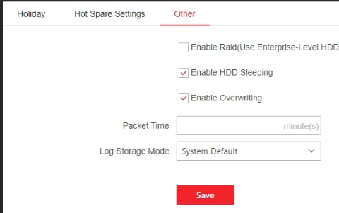

If it IS set to overwrite, then it should not stop recording.
Overwrite is the default, so, not even a setting that you have to implement.
Perhaps if you have set it off then on again it might cause an issue - clutching at straws; in which case cycling the power might prompt the NVR to pick-up the correct setting / work as expected.

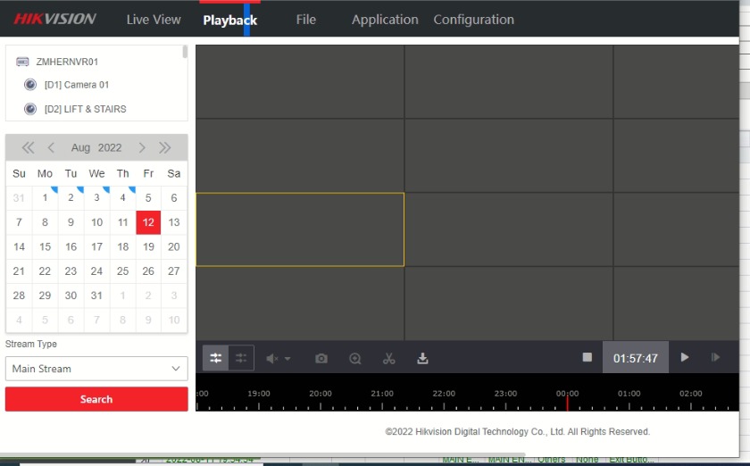

Firmware is V4.61.101 Build 220527, i upgraded it yesterday but still no change, i even reset all the recording settings this morning.
Perhaps share a screenshot of the storage / overwrite settings?
Yes, and can you also confirm that you have checked playback to confirm the recording has stopped? Can you share a screenshot/photo of your playback menu? Are there definitely no recordings showing today?
screenshot.
Hi @Nimrod
You have posted the same image in response to both questions.
It does look as if recording has stopped.
Can you share a screenshot that shows that overwrite is ticked please?
if you are unsure where to find the overwrite setting it is under Configuration > Storage > Advanced Settings > Other

Edit: One further thought...The last recording shows as the 4th. Double click that date in the calendar and make a note of the time it stopped recording. Then check the logs for the 4th to see what was happening at that time. You can view the logs from the web browser, but preferably you would do it from the local interface. The reason being that each abbreviated log entry can be expanded for further information (double click one entry to see the full details of the event then use the 'previous' and 'next' buttons to navigate. Filtering the log to show 'Operation' for 'Major Type' would highlight whether a user stopped recording.
