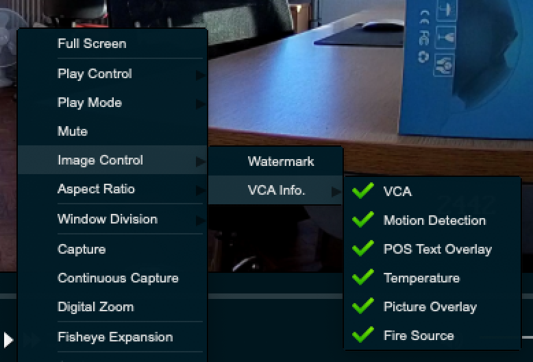

Removing the line crossing markers is not an issue we have come across before and so we don't have a solid solution, when testing VSPlayer earlier I found that if you right click the video feed you get a drop down and one of the options there is Image Control > VCA info. > this takes you to a list of image overlay information that it says you should be able to turn on & off (see below)
It didn't work on the clip we tried but it might be worth a try, we are still not sure why the downloads won't save to your computer and only to your USB, as far as we are aware downloading to the desktop has never worked but you should be able to save to any other custom folder.

I have managed to remove the line crossing markers as you suggested.

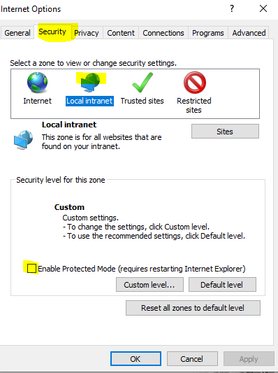

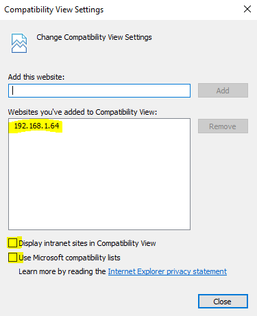

Try IE11 with Compatibility Mode set as below using your camera's IP. You might need to disable Protected Mode for Local Intranet too. This eliminated the error and saves the file for me.
Not sure about FF but Chrome works too provided you have the correct plugin installed.
