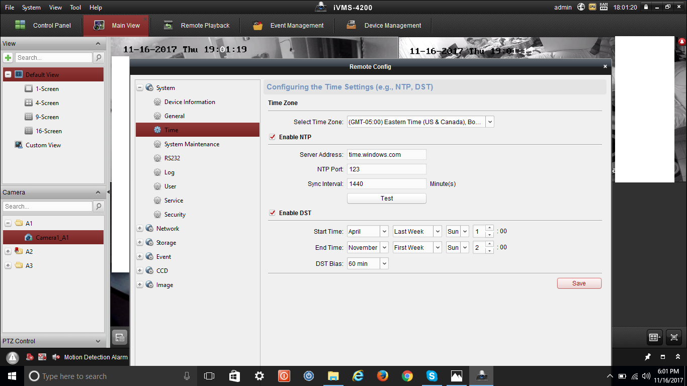

hi here, I did this DST setting still time goes ONE HOUR AFTER, so can you make me correct.
I did right click and Synchronisation, then stay current time for 30 seconds then goes back to ONE HOUR AFTER, so please make me correct.

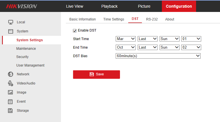

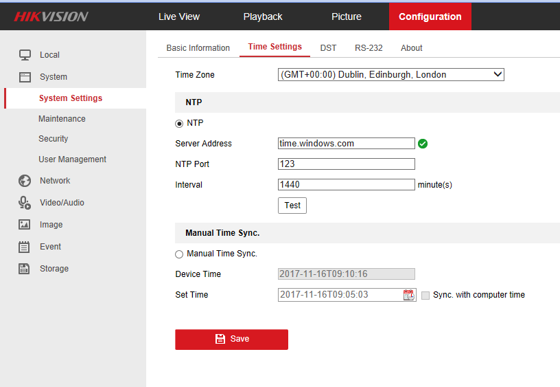

You may find that the ntp server that you are using automatically adjusts the time for DST, so your settings for DST are not needed (some do).
The below settings for Time and DST work well for HikVision products in the UK.
work well for

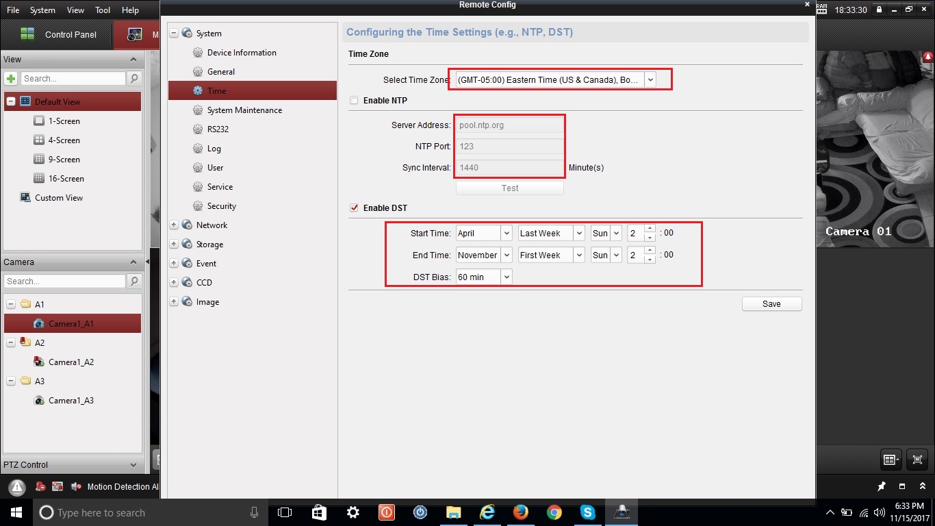

hi there,
1)--I did pool.ntp.org , when I save it, after that it will not stay this setting permanently, then again it will DISABLE by itself,.
2)--I did DST setting , still not get current time,.
3)--I did Manual Sync Time match with Windows, still not get correct time,
So please let me know, what else I have to do to get current time,.

Are you running the latest firmware for your HikVision devices?
I'm just not seeing other reports like yours.
hi there, yes I have nvr behind the camera, so I fix in nvr, after this it will getting current time,.
now every thing goes fine,.
thanks for all your help guys.
Thanks for the feedback.
If an NVR is within the installation, it always work as an "master clock" for the cameras. So it will overwrite all settings inside the cameras periodically. Just set the right time and DST at the NVR and you're done.
