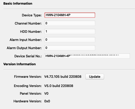

I'm from Philippines. I have bought the NVRs at different year. I can't check the box for now as they are on the deployment location which is not near on my area now. But I can attach the screenshot I got from remote configuration that I can access from a mac using IVMS 4200 software.
You can see the firmware version that I'm talking about. I also emailed the support already but still waiting for their advice:

Thanks @johnangelo
We are UK/EU based so you are probably best speaking to Hikvision or your original seller in the Philippines because as far as we can see that v4.72.105 firmware is not currently available for that NVR model in our region.
