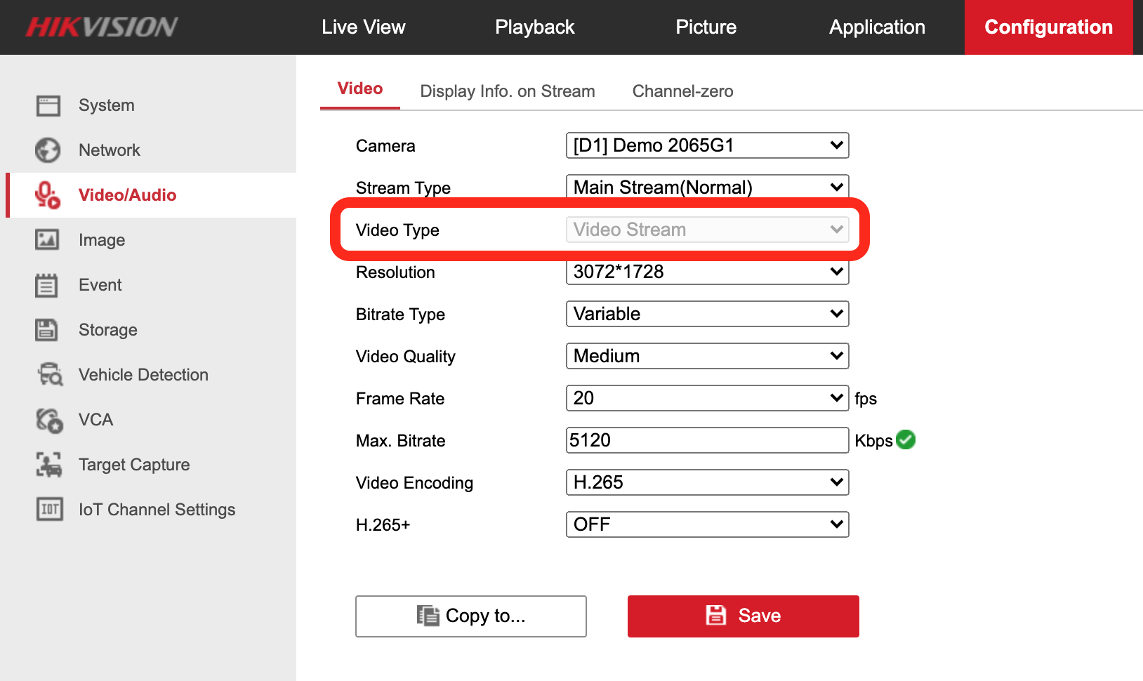

The only setting I can think of which it might be is:
Config > Video/Audio > Video Type
NVRs disable the 'Video & Audio' dropdown for those cameras that don't support it - maybe DVRs don't do this?
@Kyle That's correct. On DVR's it defaults to Video & Audio even if the cameras don't support it. It causes some static noise to be audible and a "pop" when switching between cameras in the apps.
Upvote 0
Hi @ROOPAN
See the answer above, you need to switch video type from video/audio to just video to remove the background static/interference
