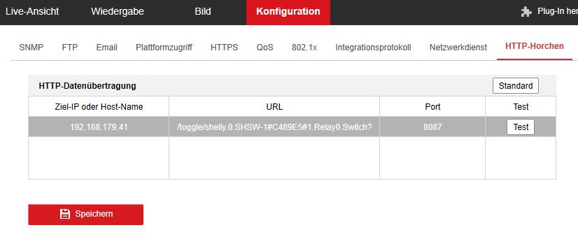

I'm trying to send out an alert using http. Concretely: A relay should be triggered when an intrusion is detected. Using a browser this works without problems. I can't do it from the camera.
This works in a browser: http://192.168.179.41:8087/toggle/shelly.0.SHSW-1#C489E5#1.Relay0.Switch?
The Settings in the Hikvision cam:

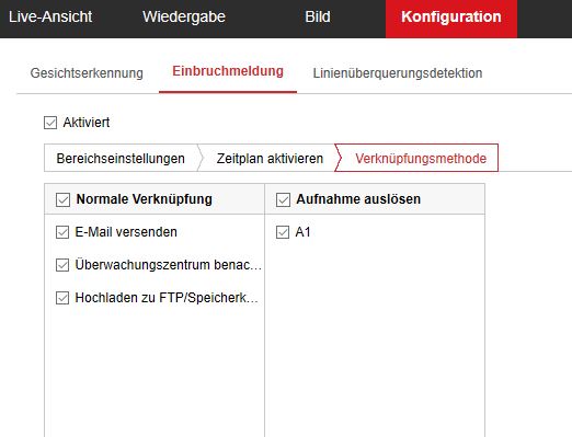

Intrusion Alarm Settings:
Recording or sending emails in case of intrusion detection works without any problems.

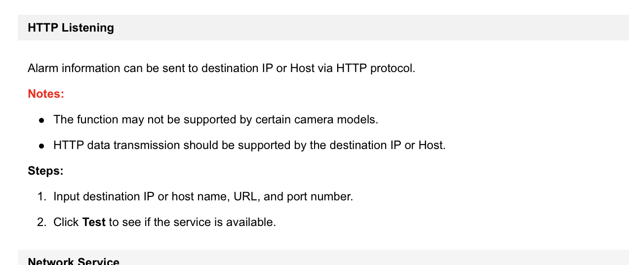

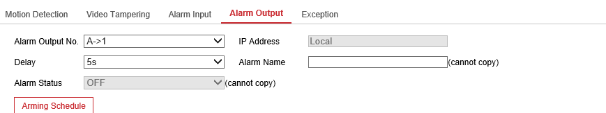

I could be wrong but it sounds like a limitation of that camera model. The image below is from the R3 series and it offers more options for Alarm handling. As @rompik mentioned, what is the function of the relay?

Actually an alarm should trigger the http command. But that doesn't work.

Thanks @tommi.
I have that option as well in my camera but it wasn't even mentioned in documentation hence my question.
