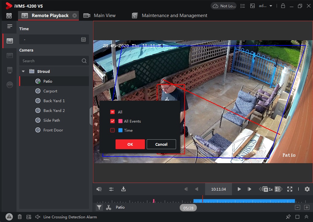

When the Storage Server Schedule Template set to an All-Day Template, the video from the camera is recorded continually to the Storage Server (all good), but I cannot see any detected events (Motion Detection/Line Crossing/Basic Events) in the timeline at the bottom of the Remote Playback window.
When using an Event Template in the Storage Server config, you can see the individual detected events easily in the timeline and quickly scrub through the timeline and playback will start at the next event. This works very well.
Not being able to search for or see events easily in the timeline within a continuously recorded video stream is a deal breaker. I would have thought that superimposing any detected Events (light red) together with the light blue bar would have been the way to go... but it seems not.
Even when I use the Filter tool in the Remote Playback window to remove the light blue Time recording, I still cannot see any events even though I KNOW there were events occurring during that time.

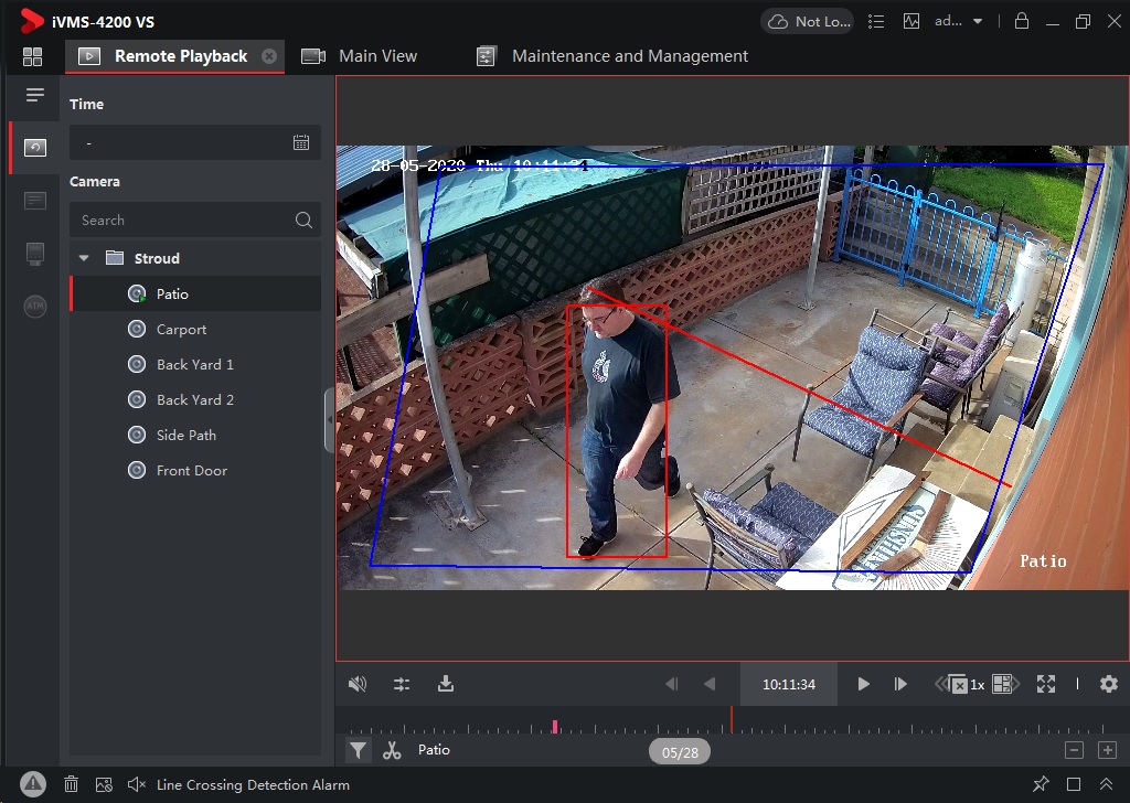

I have attached three screen captures of what I am seeing. The first is during a time I was using an All-Day Template in Storage Server for a test (the light blue in the time line). You can see me creating a Line Crossing Event. I then deselect Time the Filter Tool... but in the same part of the timeline, the Line Crossing event is not there!
During the time of the All-Day Template testing was being used on the 28th, I must have created dozens of Line Crossing and Motion Detection events, none of which seem to have been recorded/saved on the Storage Server. Having days and days of recorded video and not being able to see the events in not good at all.

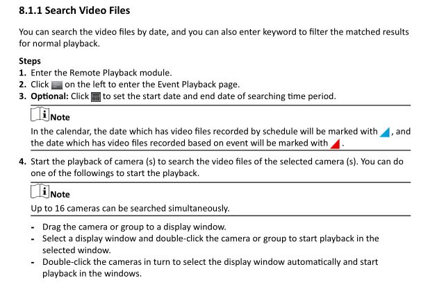

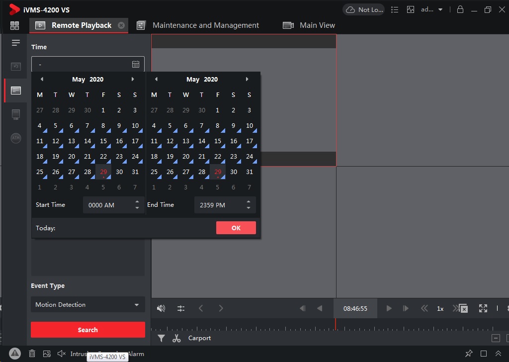

The other strange thing I don't quite understand is that when I go to search for events (as above in Remote Playback Module/Event Playback Page) and click on the calendar to select the dates... the days have light blue triangles in them.
The iVMS-4200 VS manuals states that dates which has video files recorded by schedule will be marked with a light blue triangle, dates with video files recorded based on events will be marked with a red triangle. No mention is made of what you see if a day has video files with both Schedule based and Event based files in it.
Apart from the short testing I did a few days ago, ALL of my video files have been recorded based on Event Detection (Basic and Smart). Why don't I see any red triangles? Why are the detected events on my cameras not recorded as events?
Could it be that Schedule recording and Event recording are mutually exclusive? When I play back video in Remote Playback/Camera Playback, the timeline is littered with red Event recordings (not blue as you get with Continuous recording), but the calendar once again only shows blue triangles. Confusing indeed!
Michael.
