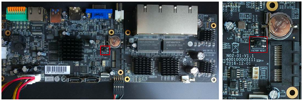

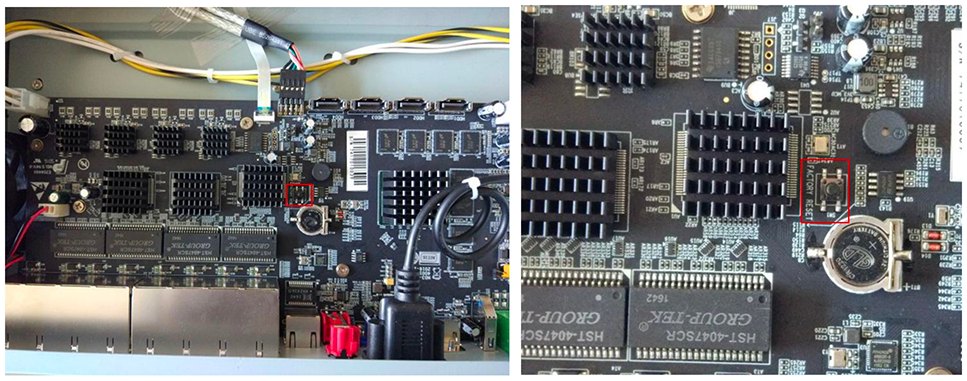

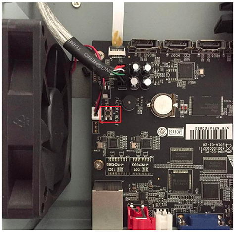

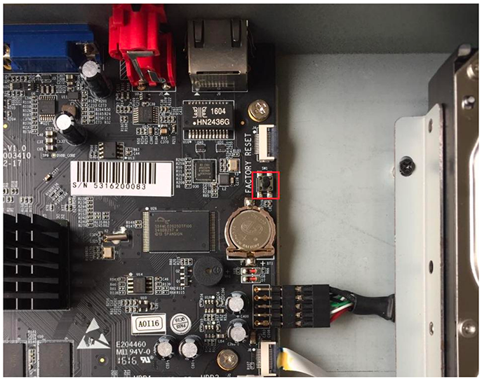

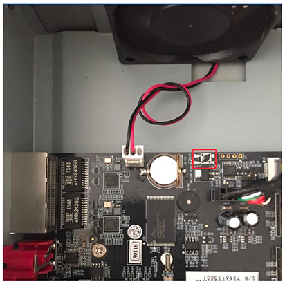

Step 2: Find the physical reset button on your NVR (the position of the reset button varies between models, see the pictures below for where you can find the reset button on each model)
Step 3: Hold down the reset button and then, while holding the button down, turn the NVR back on (keep holding the reset button until the NVR stops beeping and starts making a continuous noise)
Step 4: Release the reset button and the NVR will begin to reset and reboot (it will take about 1-3 minutes for this process to be completed)
Step 5: Open Smart Tools and go to the NVR list, you should now see the NVR you just reset on the list but with the Milesight default IP address (192.168.5.200) - If this hasn't worked then try repeating the steps

Where to find the reset button
UI-1009-NA
UI-1009-PA
UI-50xx-B
UI-5016-PB
UI-70xx-B
UI-7032-PB
UI-80xx-B
