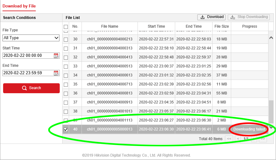

However, when I go to the web interface area where you play back recordings (which works fine)
And I try and save a selected file. I get:
I selected just the last segment recorded and tried to download it, and got this error:

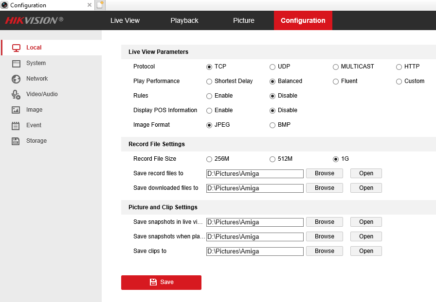

Wow, this really is puzzling me. Something on the face of it, I thought was simply browse to a folder, and files get saved there.
I have to giggle a bit how not knowing how something works is just mind blowing, yet I'm sure there is a simple explanation.
A little more experimenting has shown me, if I try and browse to and save a actual real location on my PC's drives. The recording will fail.
In live view also, press the Record or Snapshot icons and it pops up a fail message.
If I however change it to a non existent folder on my PC (not sure how I can see it in Hikvision browser, when it does not actually exist on my drive, but hey!)
Then it will seemingly record, but this recording does not exist in real terms. Crazy man! :)

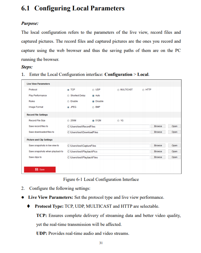

If I enter the following paths as shown in the manual below:
The recording functions appear to work, however those locations don't appear to actually exist in reality on my C: Drive.

Little update. Managed to find the answer to my problems above :)
And indeed, I'd never have guessed the answer in a million years, but now I know it's simple (as most things are when you know!) :)
My thanks goes out to "digger11" on another (The Other?) Forums/Site for his post, which I'll add below, simply in order to perhaps help someone else, new, one day who is stuck and confused as I was.
The solution from 6 years ago!
"Files created by taking a snapshot, recording video, or downloading saved clips, go into their respective sub-folders under the C:\Users\%username%\Web folder.
BUT if IE is running in Protected Mode, these folders get virtualized, and show up under C:\Users\%username%\AppData\Local\Microsoft\Windows\Temporary Internet Files\Virtualized\C\Users\%username%\Web
AND I think they get removed immediately.
The easiest way to address this is to add your camera's IP address to the list of trusted sites.
Open the camera's GUI in the browser.
Click on Tools (the little gear symbol)>Internet Options>Security>Trusted sites>Sites>
Clear the checkbox for "Require server verification (https: ) for all sites in this zone", and then hit the "Add" button to add the camera to the list of trusted sites.
You'll probably have to close and restart the browser for it to take effect."

Thanks for the tip. I could not figure this out either. It does work. I have spent a couple of nights trying to figure out how to download from a Sony SNC-VB635 camera SD card. Thanks
I also found out, if I just "Enable" the SSL (Secure Socket Layer) function for HTTPS in the camera it works without disabling the "Require server verification (https: )" under Internet Explorer.
