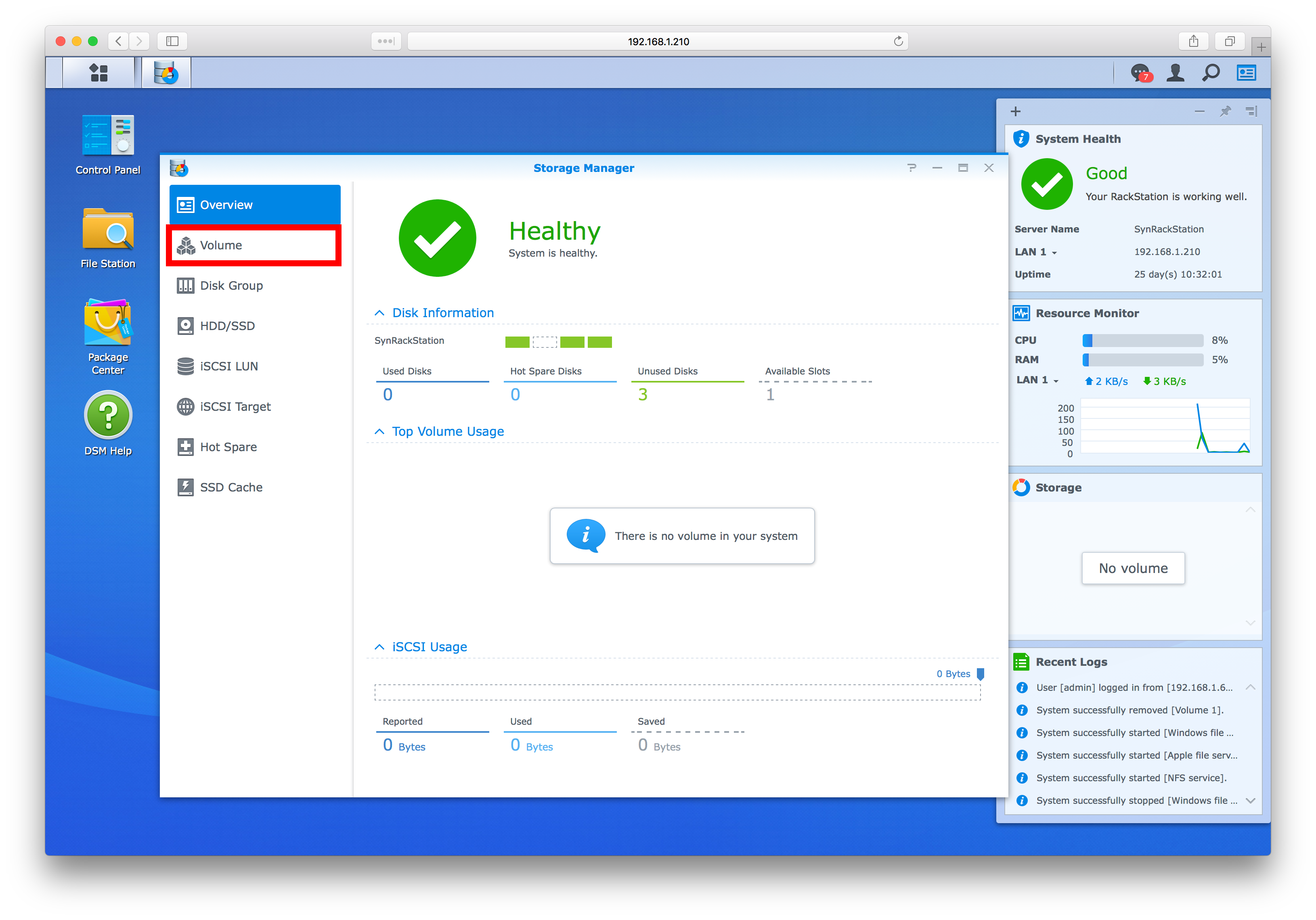

Step 3: Click the Volume tab from the menu on the left of the storage manager window​

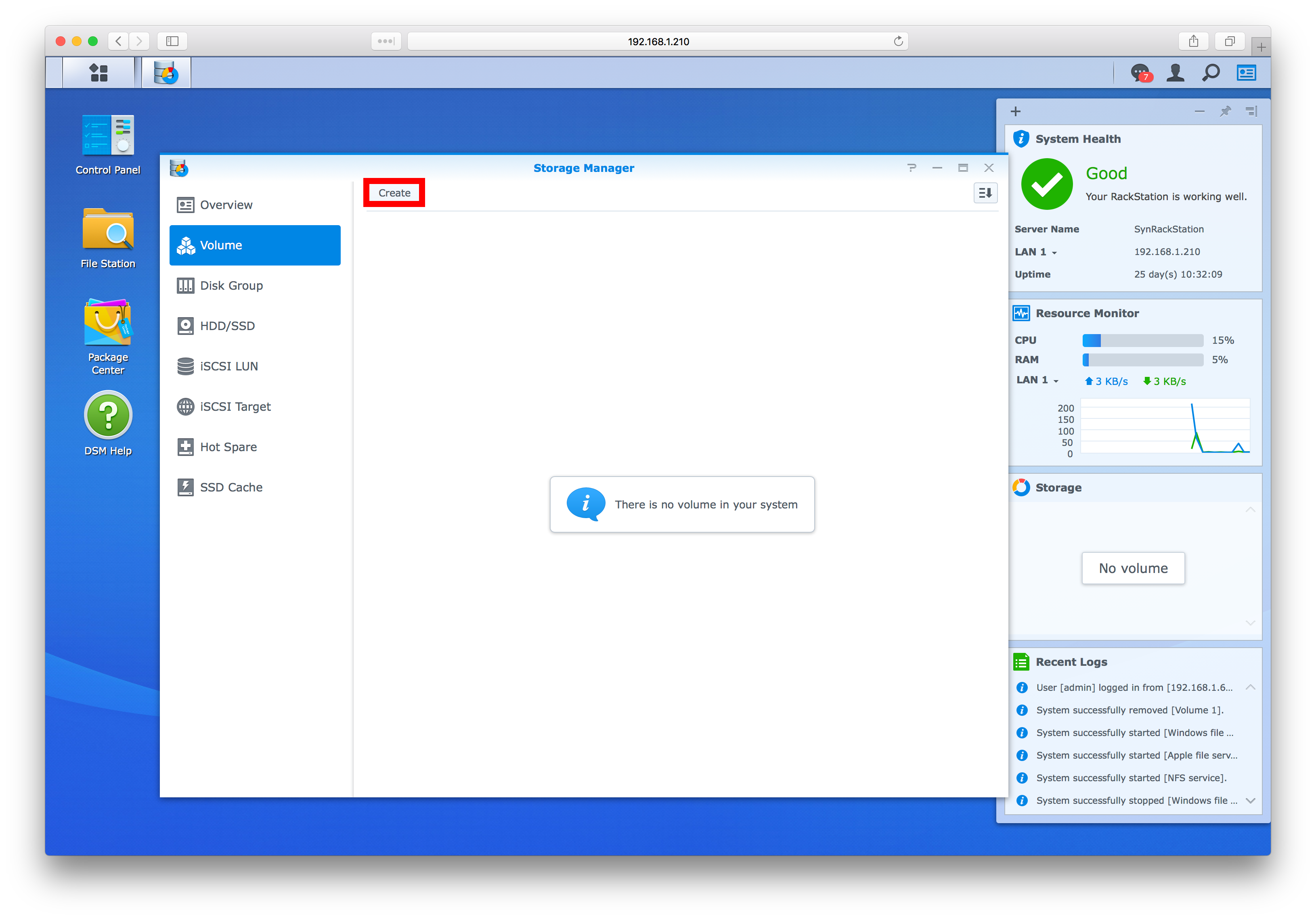

Step 4: Click the Create button at the top left of the volume window​

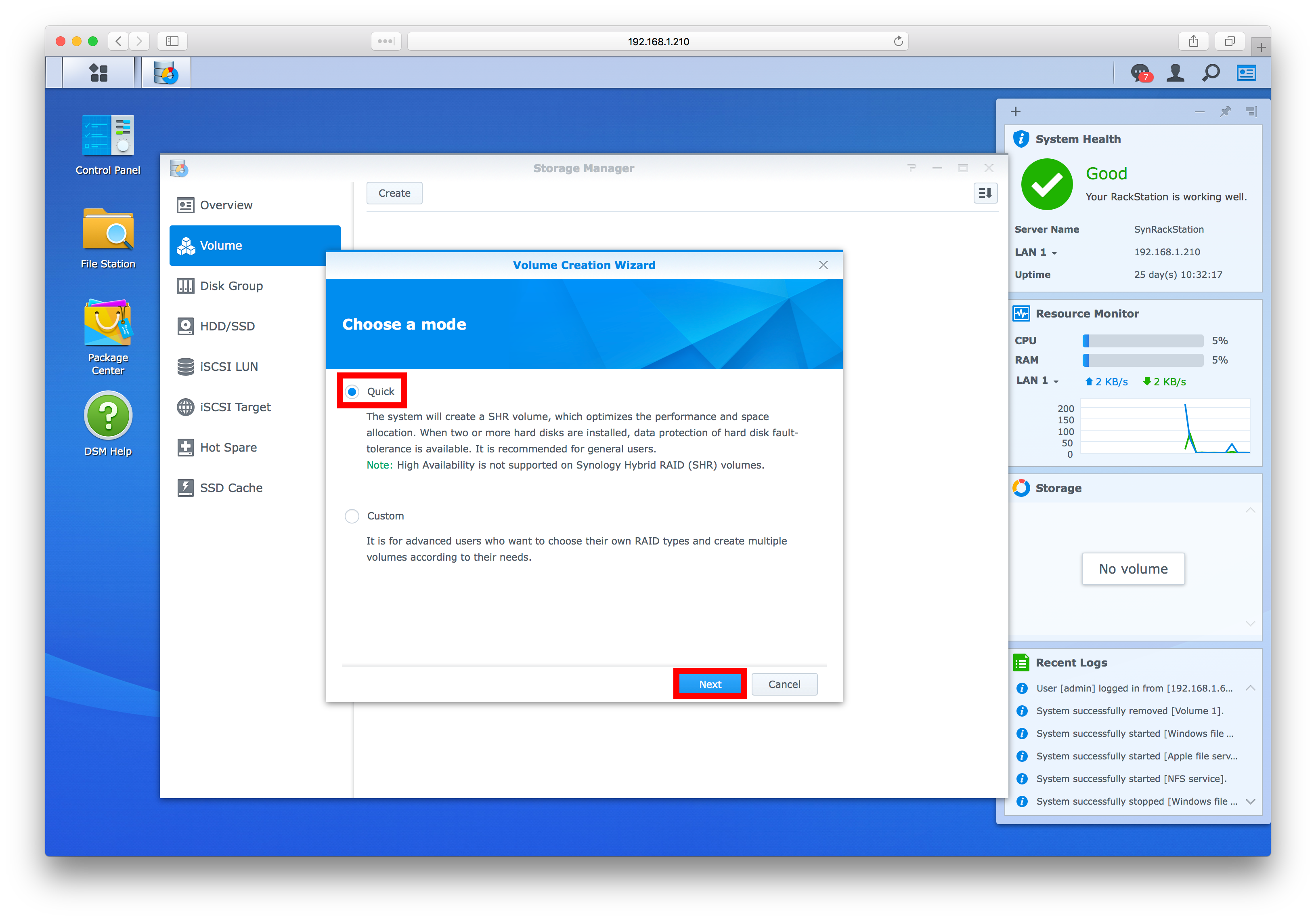

Step 5: When the Wizard opens select either Quick Setup or Custom Setup and then click next (If you're new to this we would recommend just sticking with quick setup)​

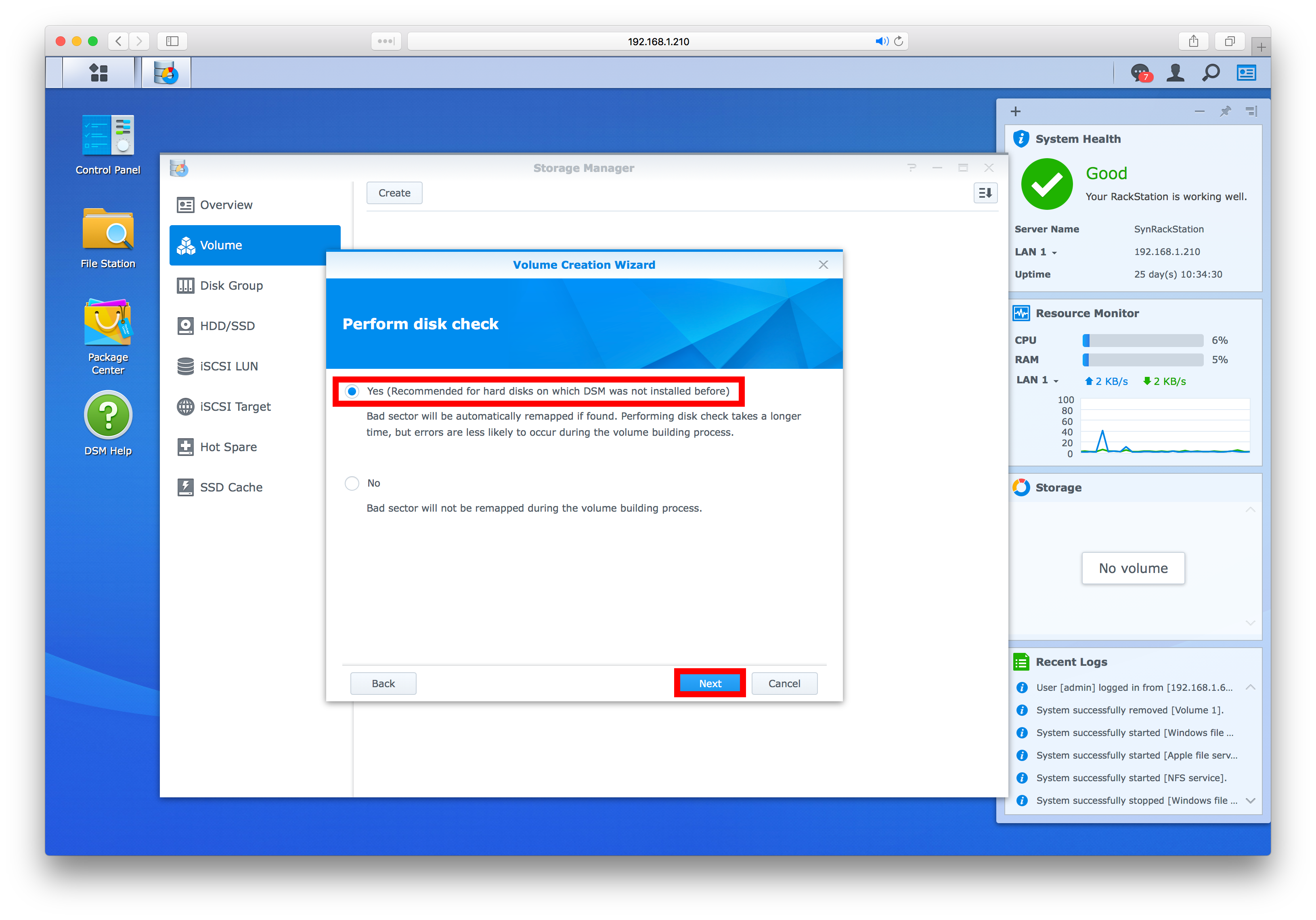

Step 7: Select Yes to do a disk check of the selected hard drives and then click next (we recommend doing this all the time, but especially if the HDD is new or has been repurposed from another storage device)​

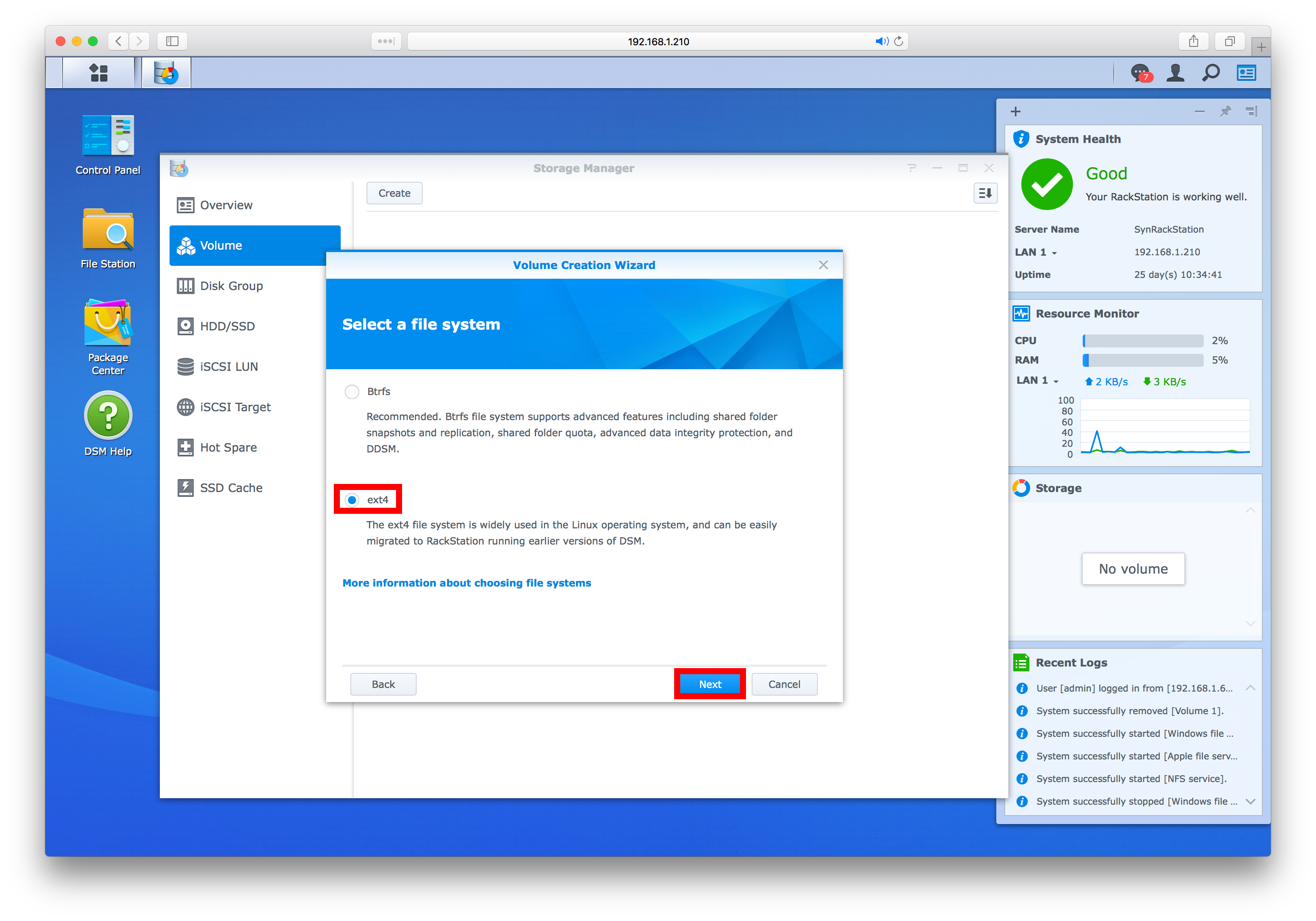

Step 8: Select the file system you want to save your files with, ext4 or Btrfs, and then click next (we recommend ext4 as it is the established standard)​

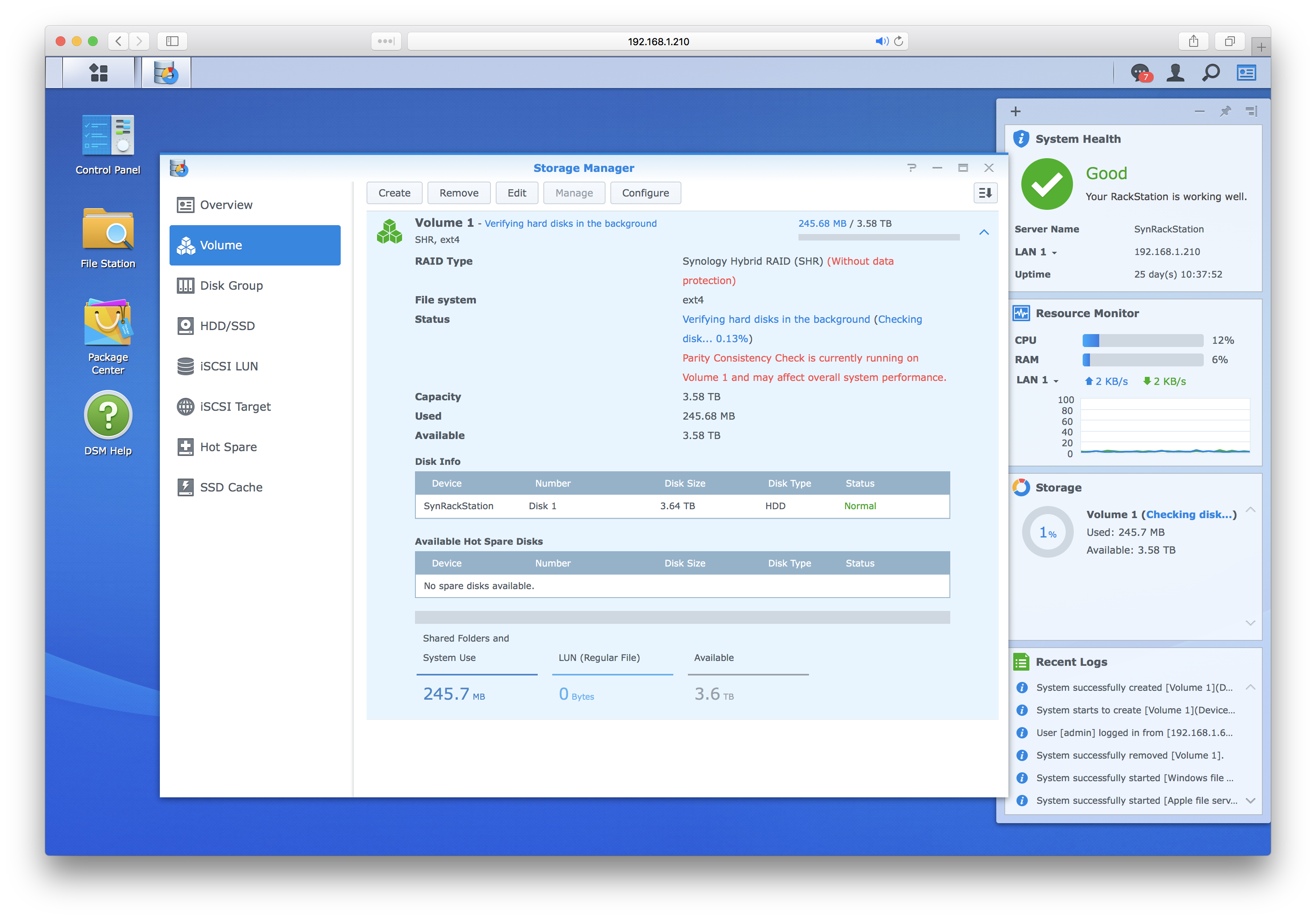

After a few seconds, you will be taken back to the volume page and the newly created volume be created and ready to be used for whatever storage you want
Be Aware that after creating a volume the NAS device will want to do a Parity Consistency Check which can take a while and can affect the devices overall performance while it completes the check
