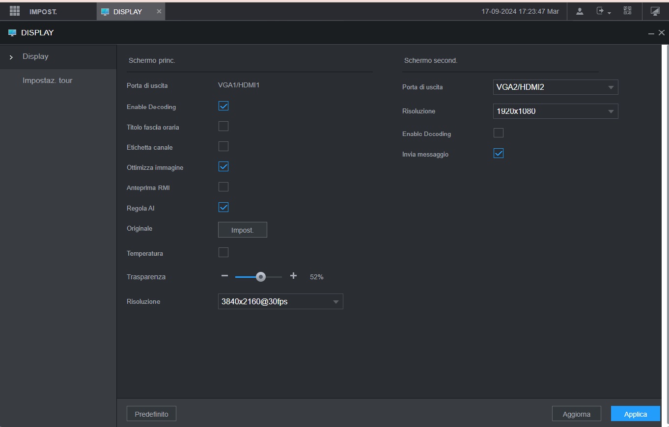

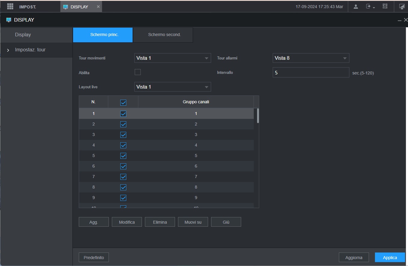

HI,. I couldn't find the menu you describe, even the manual page has nothing to do with my problem
Hi @19ciccio77
Have you checked that your NVR is running the latest firmware? The Dahua website appears to list a V4.002.0000000.7.R.240717 firmware that looks like it was released a couple of months ago.
If you are not running this version, try updating to this version and then check the DISPLAY settings again (the above user manual came from the Dahua product page I've linked above so those are definitely the correct instructions for the model you have but you could be missing these settings because you are running an older firmware.
