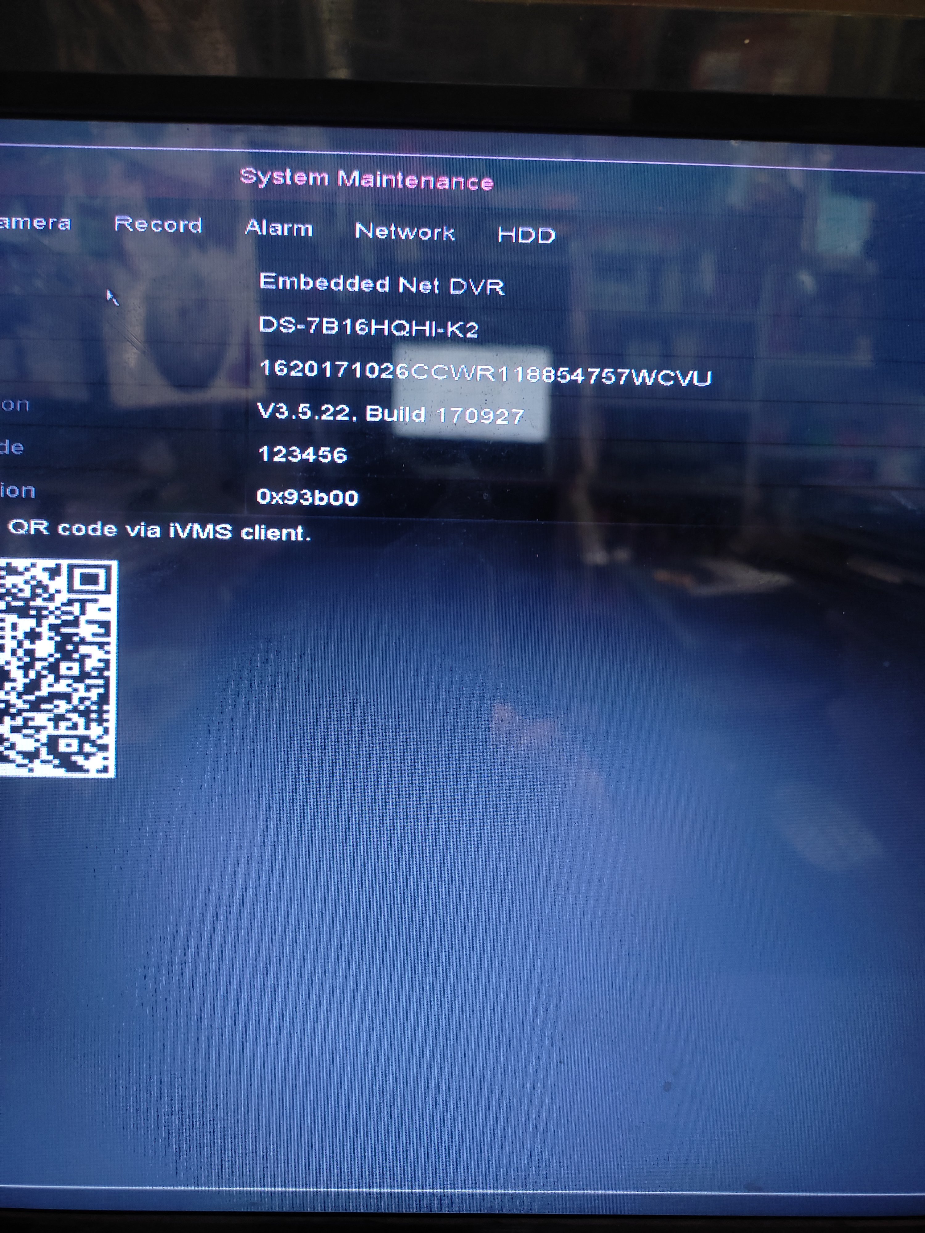

Hello my dvr currently running on the V3.5.22, build 170927 is it the latest version is there a newer version available. If available can i get the firmware download link.
Cause I was unable to find for my DVR model DS-7B16HQHI-K2

I'm not familiar with that model. When you said '7B16' I thought maybe it was a typo and you meant '7816'. We've never had that model in the UK so I can't advise.

Found it on Hikivision's India site.
Found the specs on Hikvision's India site. Maybe search there to see if there is updated firmware.
