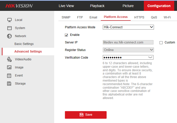

Since you don't need to configure ddns I suspect it is an app on the NVR doing this

You can enable the use of the Hik-Connect portal from the Configuration settings of a camera or NVR.
