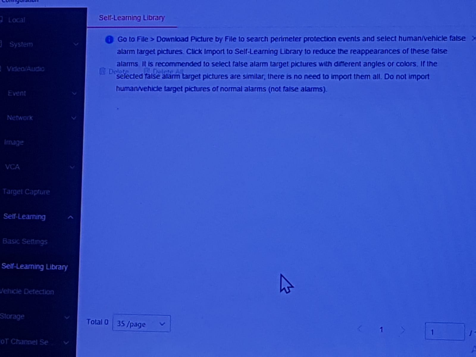

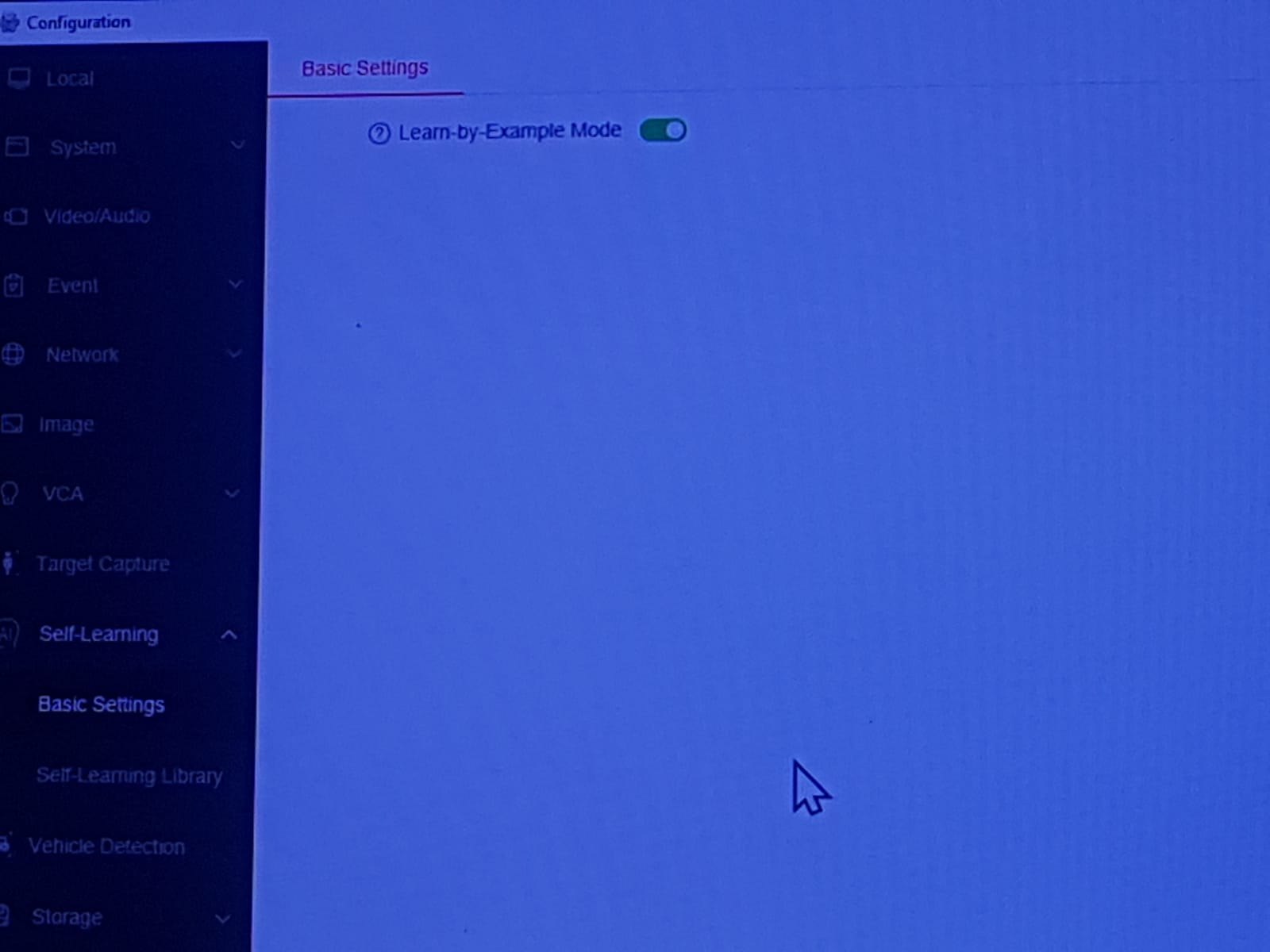

Hi does anyone know exactly how to use the "self learning tab" to get the best use out of it.
Hikvision NVR Model:
DS-7732NXI-I4/S
Sorry for the poor pictures.

The Self-Learning feature on the AcuSense NVRs is used to help improve the false-alarm filtering.
For example, if an object that isn't a car/human incorrectly triggers an event, you can upload a file of the object to the self-learning library.
Doing so should then help the NVR to recognise this as neither a human/vehicle, preventing that object from triggering an event in the future.
I guess the feature only applies where AcuSense is being carried out by the NVR itself as the NVR can use that library during analysis. Where AcuSense is being carried out in camera the NVR engine is not used.
