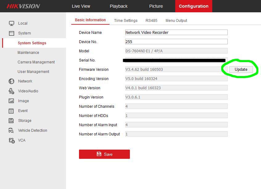

4. Take the Configuration option as shown in the image below (Serial No. hidden in case there might be a security issue if it is shown)
5. And then take the "Update" option as outlined in green. I presume that if I do this then I will be asked where the unzipped firmware update is and proceed accordingly.

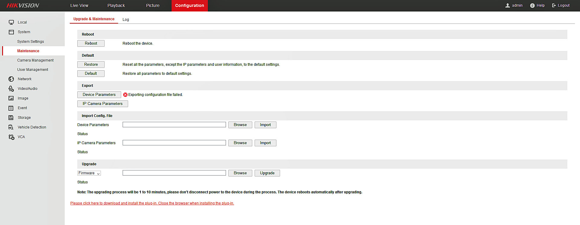

I don't normally use IE anymore, sometimes I use Edge and Chrome but I mostly use Firefox. Using the IP address I got to where I needed to be but it went wrong when trying to export. When clicking on either the Device Parameters and IP Camera Parameters option I got the error message seen on the image below.
I had the same error message as well, don't know why. I even tried internet explorer with admin privileges but no luck.

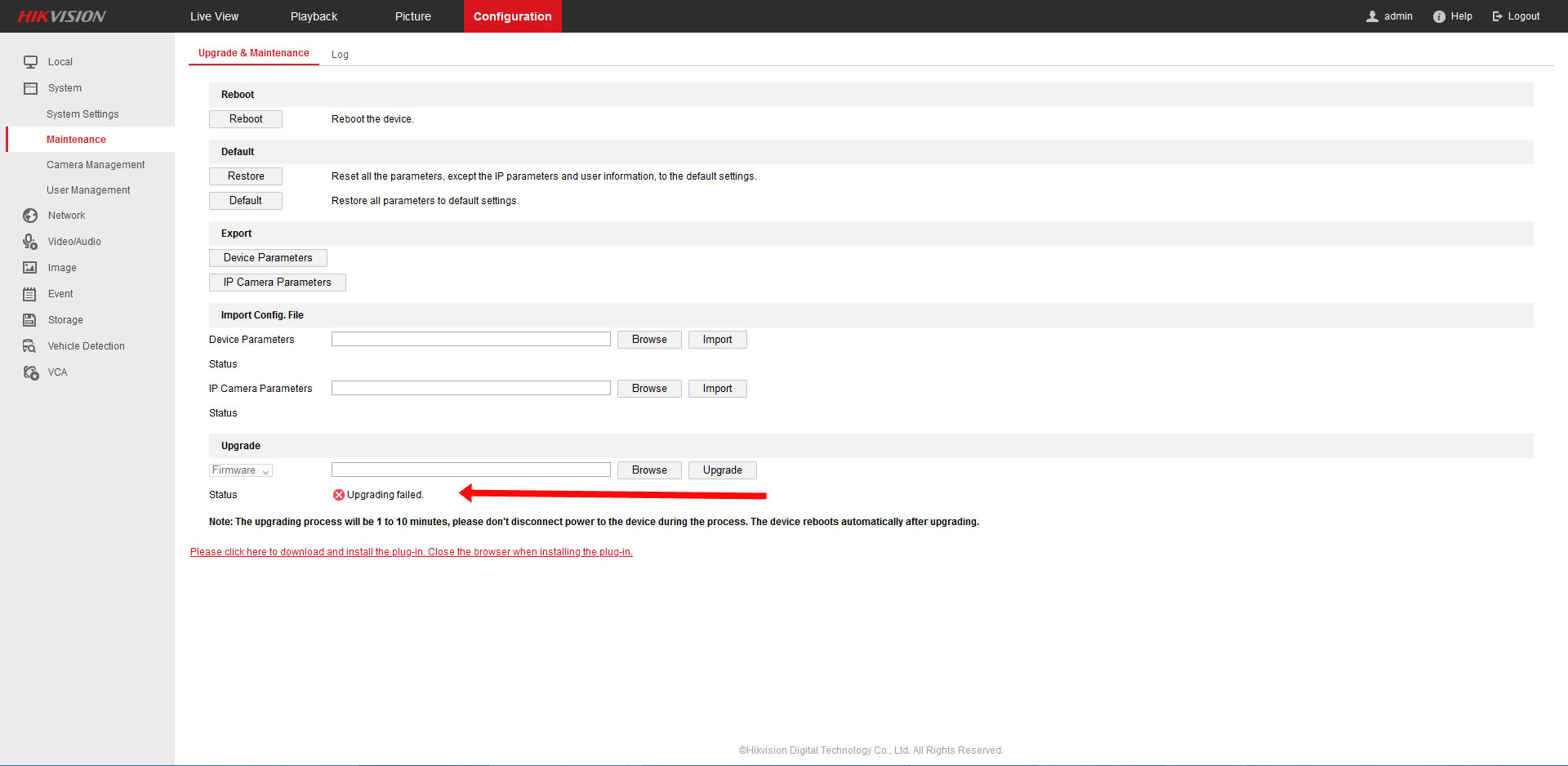

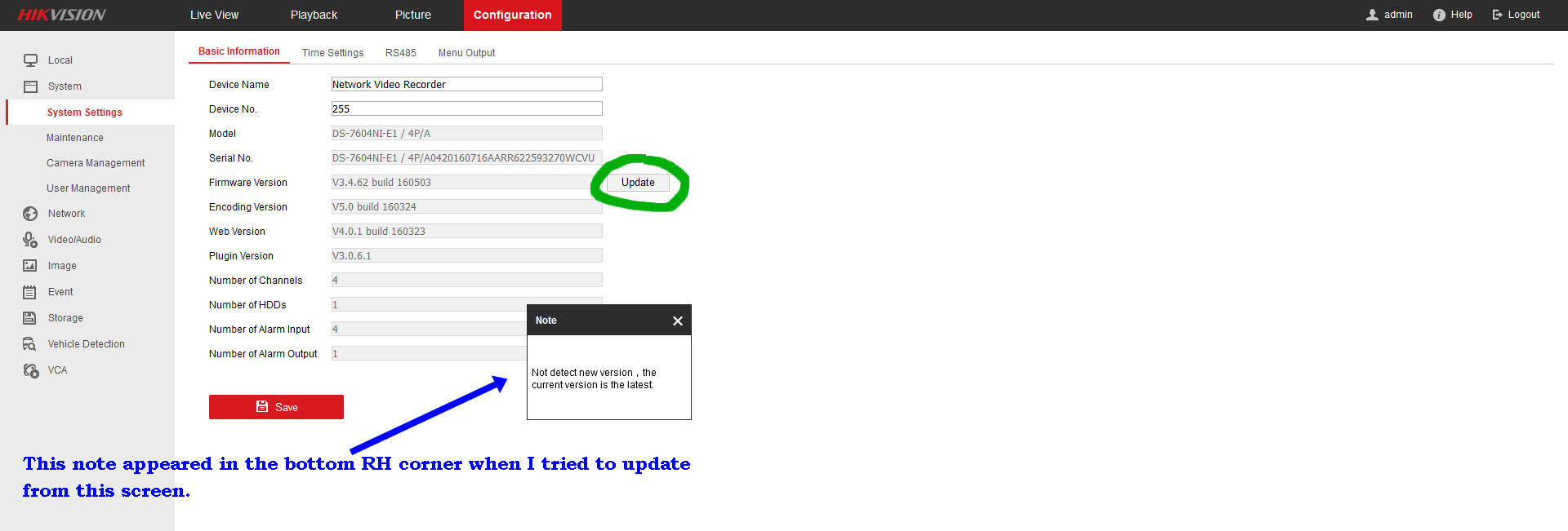

Ooooh, I wish I could have a beer. This job is getting to me, despite your much appreciated help and patience. I have just attempted to update to 3.4.80 The dgicap.dav is in my C:// root directory and the file is showing 15.4Mb in size. I have tried to update in two places, both after inputting the IP address and logging in. and then going Configuration>System Settings and then Maintenance which is just under System Settings. Screen dumps below but I got error messages both times !
I’ve never known the one with the green ring to work. Are you clicking the browse button and then select the digicap.dav file?
delete the digicap.dav file and download it again.
reboot your NVR and try the upgrade again.
what version of windows are you using?
