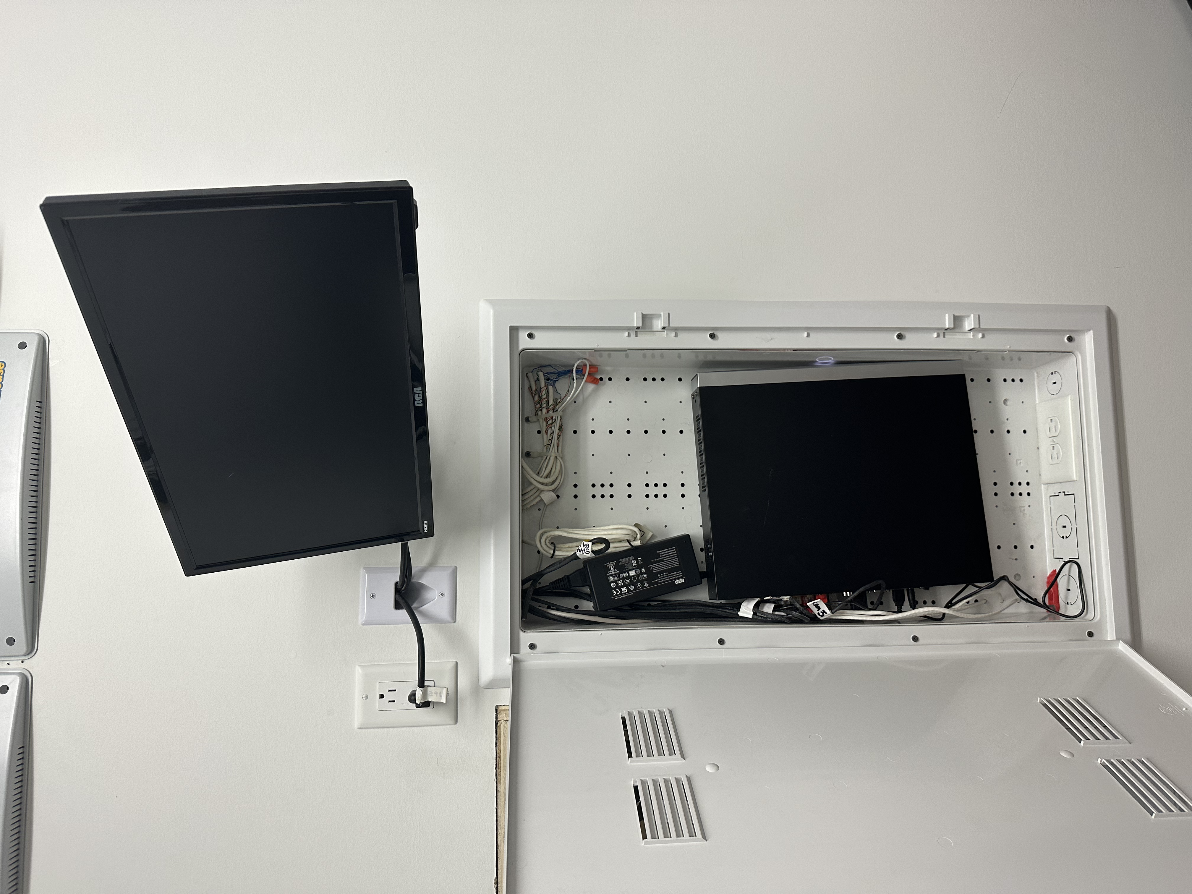

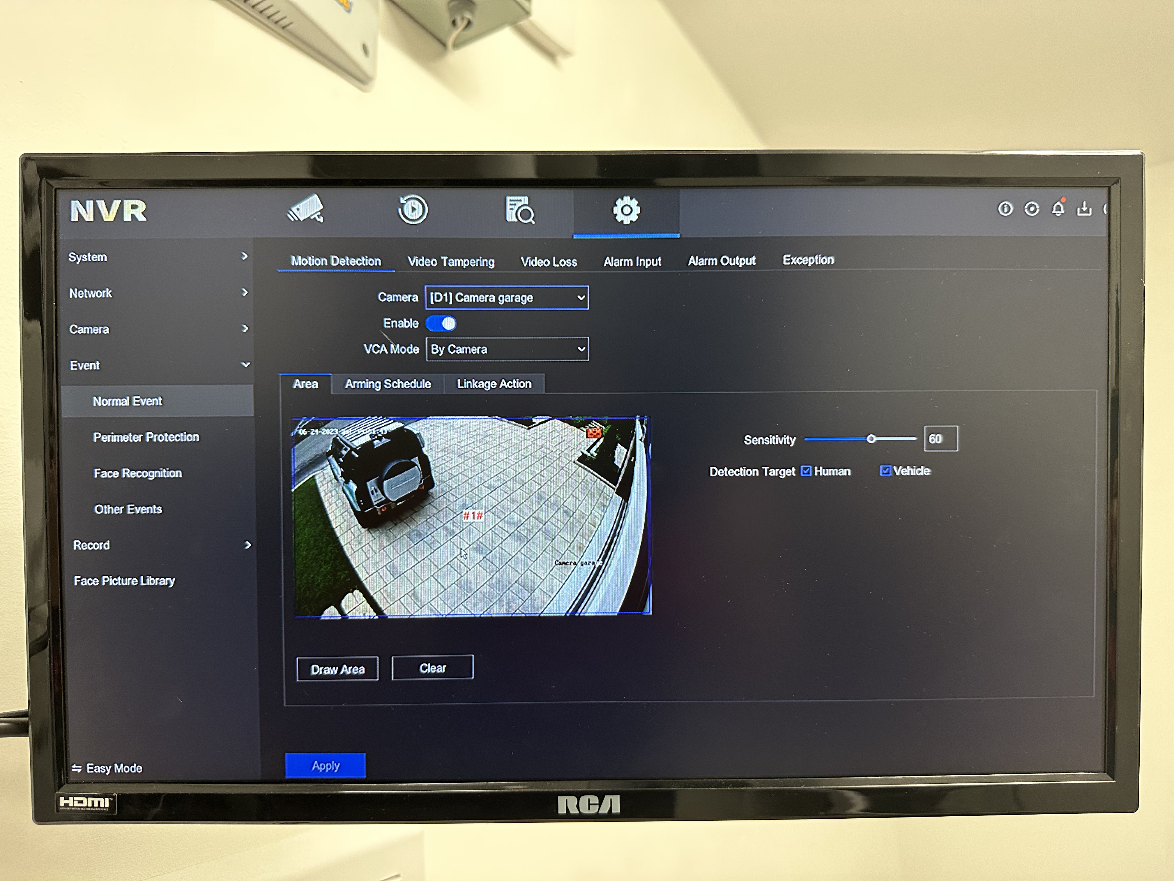

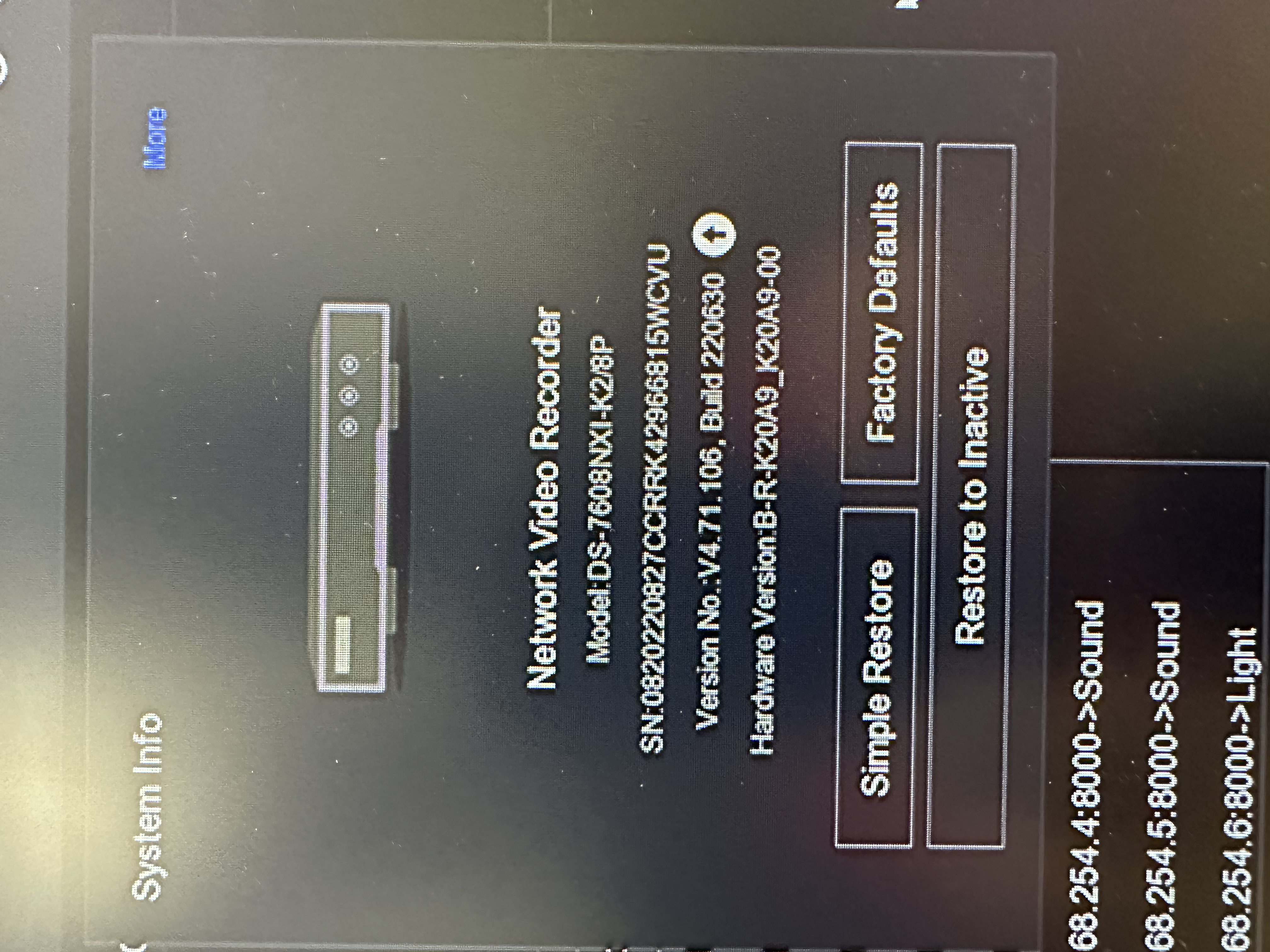

My installer have just installed the Hikvision NVR DS-7608NXI-K2 version V4.71.106 Build 220630 + 3 DS-2CD2543G2-IS + 5 DS-2CD2387G2 cameras. Everything works but he didn't have the time to setup the advanced functions (AcuSense, Strobe light, alarm siren...) or upgrade the firmware of the cameras. Here are the questions:
1) How do you check which firmware is on the cameras with the NVR and how do we upgrade the firmware with the NVR or with the PC or MAC?

3) I have an old 1080p monitor plugged in to the NVR. Will the video resolution be better 4 MP or 8 MP on my iPhone 14 HikConnect if I upgrade for a 4K monitor plugged in to the new NVR?

1) If you go to the camera menu and scroll to the far right of the camera list the final column should show the current firmware version of the connected cameras. You can update the firmware on the direct monitor by loading the firmware onto a USB stick or you can log in to the NVR with a browser and then use Virtual Host to log in to each camera and update the firmware.
The latest firmware for both the NVR & cameras is below (scroll to the bottom of the linked product pages to find the firmware files):
DS-7608NXI-K2 --- V4.74.017_230418
2543G2 & 2387G2 --- V5.7.13_230504 (both cameras use the same AcuSense/Color Vu camera firmware)

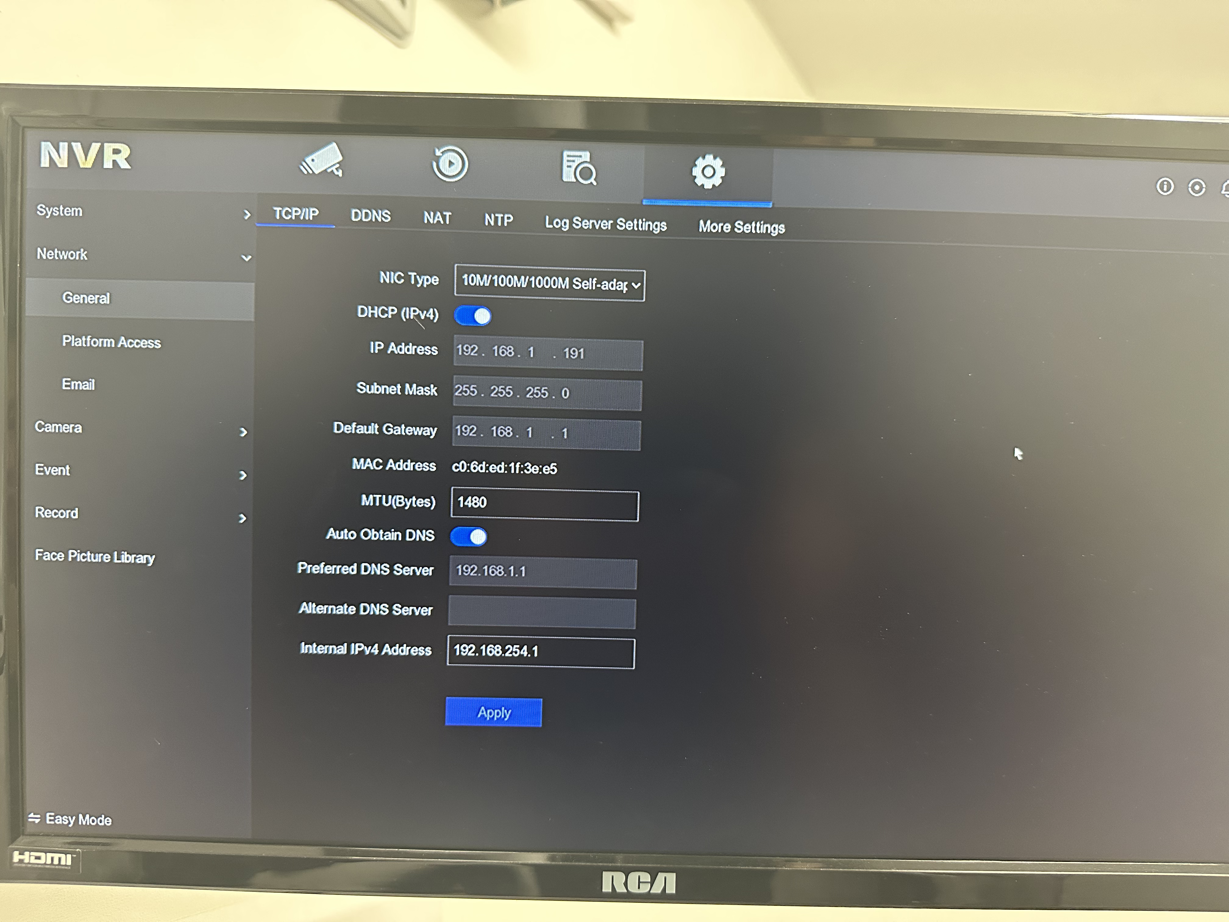

I don't see the Virtual Host option on my NVR network...
Is it easier to upgrade the firmware with the USB stick or with Virtual Host?

Hi @ian1975
Apologies if I wasn't clear but you would need to log in to the NVR using a browser on a PC to access cameras via Virtual Host.
If you want to stick with accessing via a direct monitor, you can load the firmware files (the unzipped digicap.dav files) onto a blank USB stick, plug that into a USB port on the NVR, and then click the little upgrade arrow next to each camera on the camera management page.
If you do it this way, we would recommend trying one camera first and waiting till it has rebooted and reconnected before moving on to the other cameras, just to make sure there are no issues after updating.

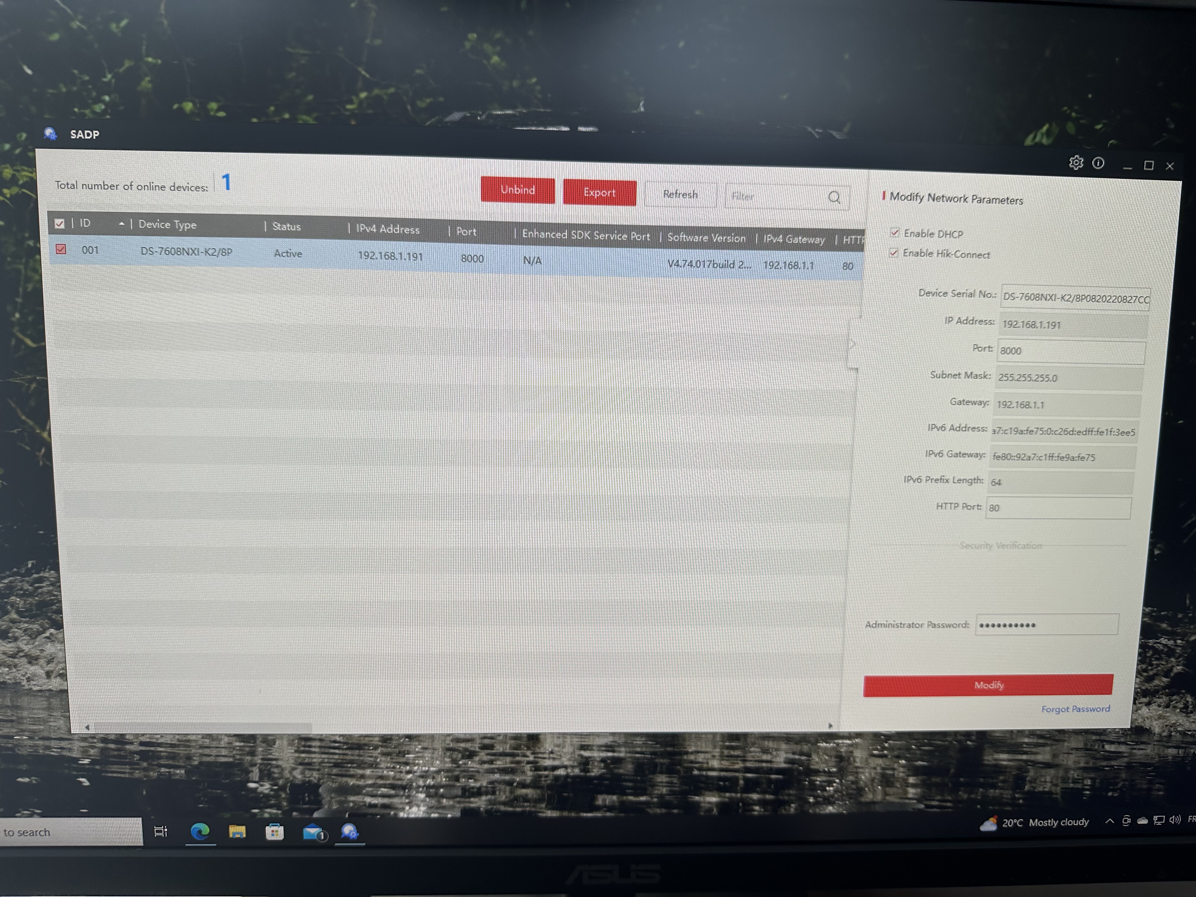

Hi Dan,
I see my NVR in SADP and IVMS. How come I don't see the 8 cameras plugged-in directly into the NVR?
I update the NVR firmware successfully with SADP but I didn't see the cameras so I can't upgrade the firmware yet.

Hi Dan,
What should I do to see the cameras?
Thanks!
Ian
If the cameras are directly connected to the PoE ports on the NVR then they will be using the NVRs subnet IP range (192.168.254.xxx) which is not visible/accessible from your local network range, this is why you need to use the Virtual Host feature I linked you to earlier in this thread to gain direct access to the settings of each camera.
Did you update the NVR firmware using the USB stick or by logging into the NVR with a browser? This information will help me guide you to the easiest way for you to update the camera firmware.

I was lucky yesterday. I don't know how I was able to update the firmware with SADP software and a browser. After that I can log in the SADP and I can see only the NVR but I don't have any access to the settings of the NVR in SADP software. But I've successfully installed the IVMS-4200 which I have accessed to every settings and the virtual host feature was enabled but I can see only the NVR and no cameras.
I can't use the USB option because the installer puts the NVR in a small area and it's impossible to but in a USB in front of the NVR. The back USB port is used by the mouse.
One option is to plug the pc directly into the back of the NVR but I don't have any PoE port left because they are all occupied the the cameras. Do I unplug one camera port to but the pc in and alternate the port after to update the first camera port? How do I specify a close ip address to the camera in the pc to detect the cameras if plugging in the back of the NVR? Also it will be a hassle to bring the pc/monitor upstair to the basement to plug into the back of the NVR..
Is there another solution to access to the cameras with Virtual Host?

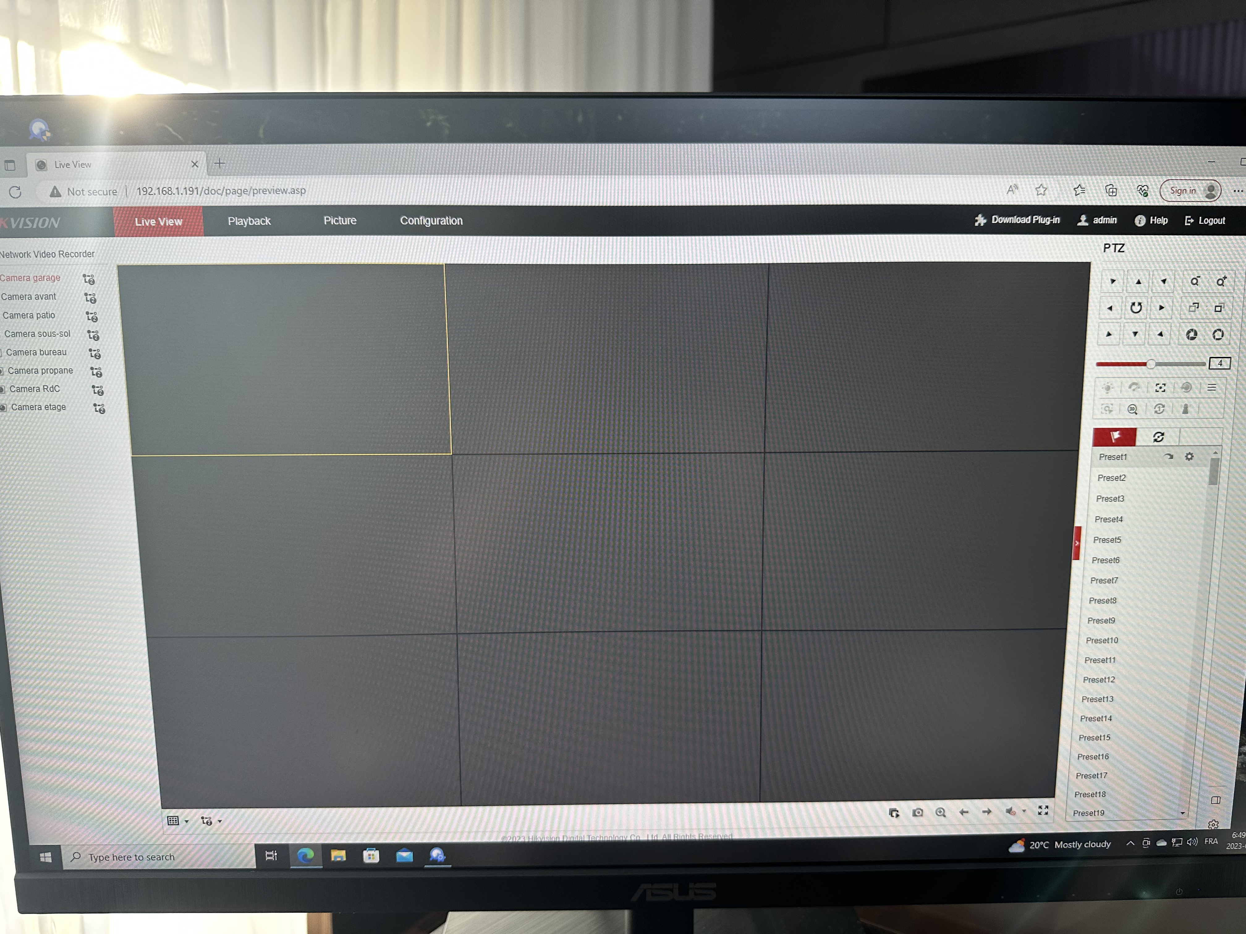

I think the easiest thing to do would be to take the NVRs IP address from SADP, enter it into the address bar in your browser, log in to the NVR, and then go to Configuration > System > Camera Management where you will see all the connected cameras. With Virtual Host enabled you should now see virtual host links for each camera in the "Connect" column, when you click each of these links you will be taken to a login page for each camera.
The password for each camera will likely be the same as the NVR because if cameras have been activated by Plug & Play they are usually assigned the NVR password (unless you set a different activation password when going through the NVR setup wizard).
Once logged into each camera you should be able to update the camera firmware in the same way you updated the NVR firmware.
If you add the NVR to Hik-Connect then you should be able to access the NVR HDD recordings, a MicroSD card is only required in the camera if you are adding the cameras individually to Hik-Connect.
Thank you Dan! It's working and I will update for each camera...

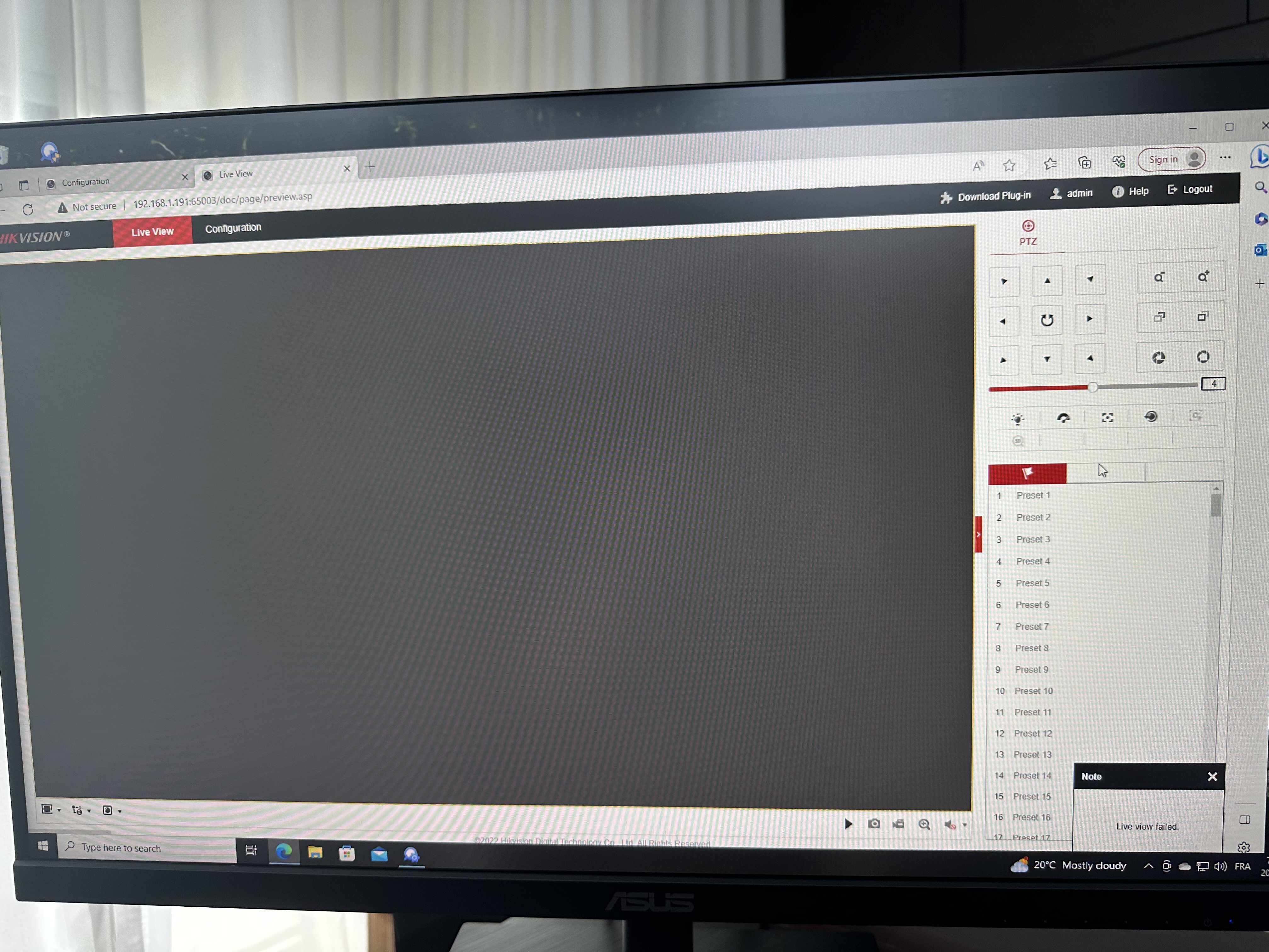

How come I receive an error message "can't play live view in SADP"? What should I do to be able to watch live view cameras in SADP?
Ian
Hi @ian1975
That screenshot is the browser access and not SADP, I wouldn't expect you to get an error code that mentions SADP when you try to play the live stream in the browser.
Can you please try double-clicking one of the cameras from the left of the screen and if it doesn't stream can you please confirm exactly what the error message says?

Hi Dan,
Live view failed with Edge in internet Explorer mode & Chrome too. Is there any setting to be done to be able to live view in SADP.
I can live view with the NVR and with IVMS...
Thanks!
Okay,
Is it only when logged into each camera directly that you don't see the live view? Can you view the live view of each camera when just logged into the NVR?
