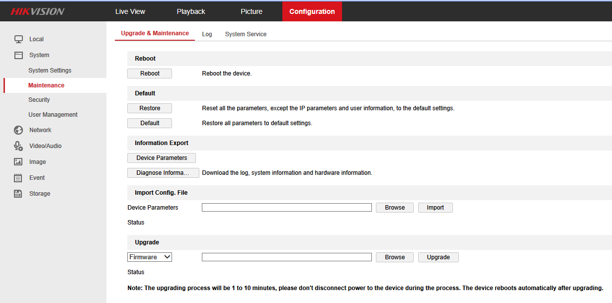

See also:
How to reset a Hikvision camera to factory default settings via your browser

See also:
