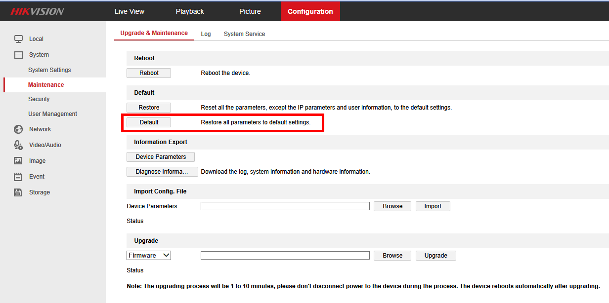

Step 2 - Navigate to Configuration -> Maintenance
Step 3 - Click on the Default button:

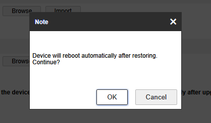

Step 4 - You will be asked to confirm your selection, and warned that the camera will reboot.
NB - All settings will be reset AND the camera will be inactive.
