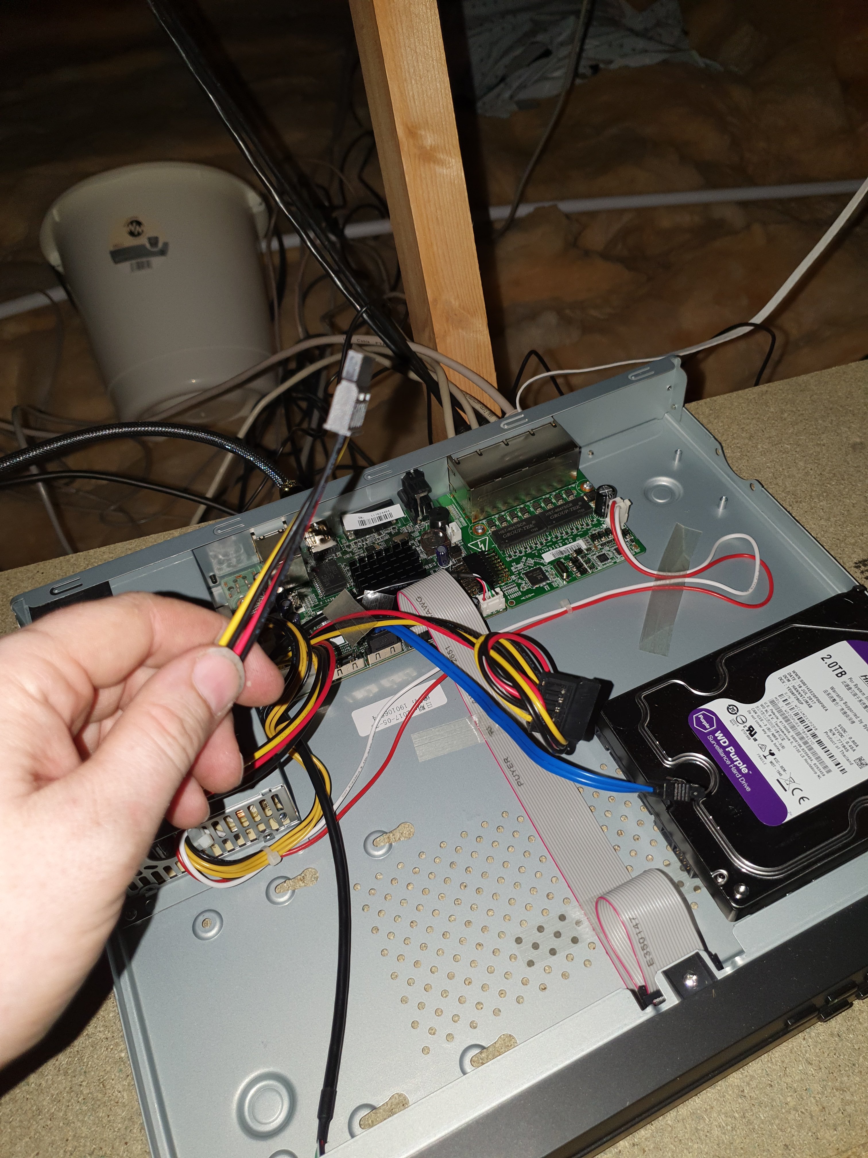

As you already own it, look underneath for the mounting holes.
And/or take the cover off and see whether you have the additional SATA & power sockets and cables for a second drive.
I've had an email back from the supplier, he says it only holds one drive, so I'll have to buy a 6tb and replace the 2tb.

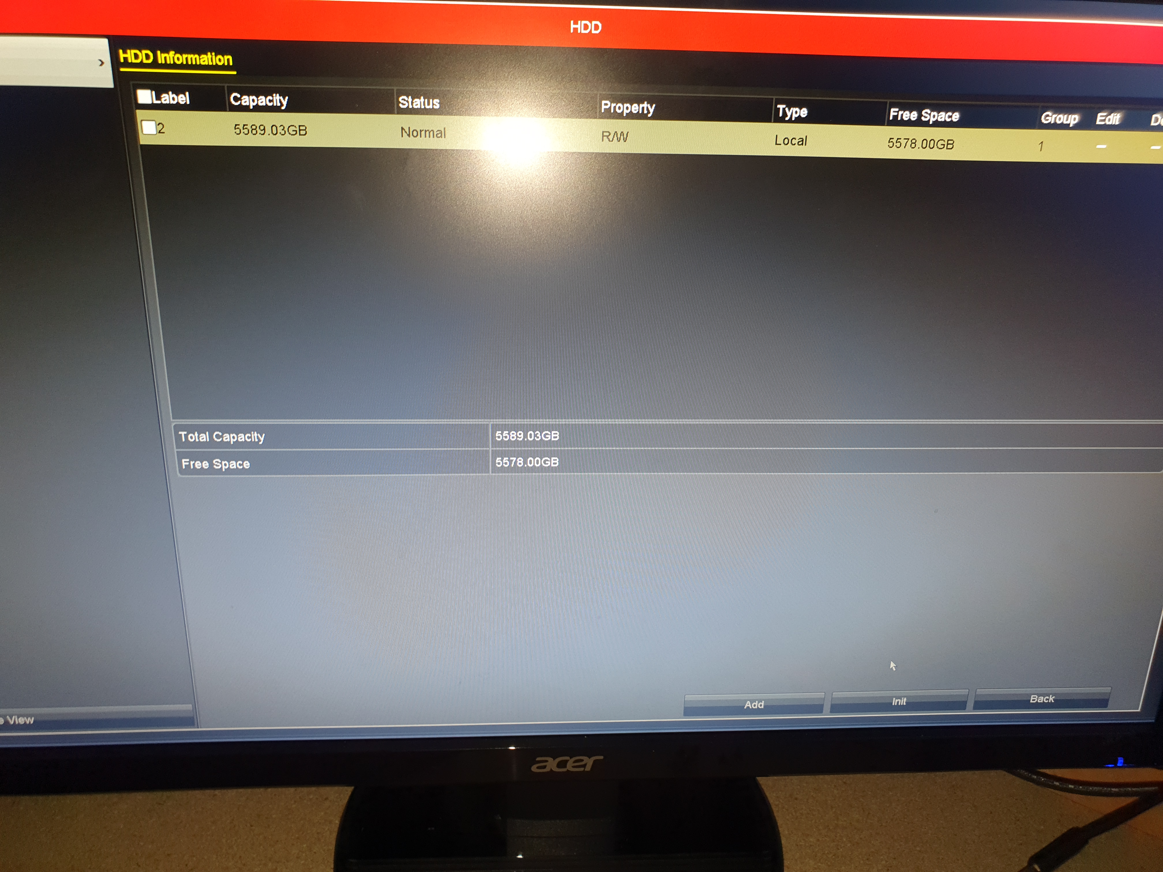

Got around to installing the new drive today. Surprised to see that it seems to have the slots and sockets for 2 drives.
Makes me wonder if it can manage more than 2tb. I suppose I could have fitted the 6 and the 2 and see what happened but I just swapped them over. Job done though.
