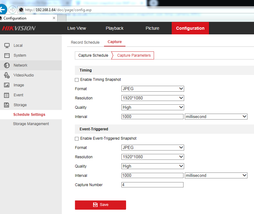

have a 6MP camera 2CD2463G0-IW
the camera is set to 6MP 3072-2048.
The snapshots attached to the email are however 1200x900
i can not find any setting to change this.
Is this default for attached snapshots?
will the triggerd by event setting perhaps overrule this resolution.?
i can probably make snapshots locally and send those but i like to do it without internal storage
here are my settings

at first the snapshot attachment was 1200x900
the i enabled the event triggered snapshots and the attachments went to 3072x2048
after that i disabled the event triggered snapshots and i still get a snapshot attached with size 3072x2048.
i think it uses 1200x900 when you never have selected anything. after selecting and deselecting it works.
trange thing is the amount of snapshots is 3. it does not matter if i enable event triggered snapshots en use capture number 4. it sticks at 3
