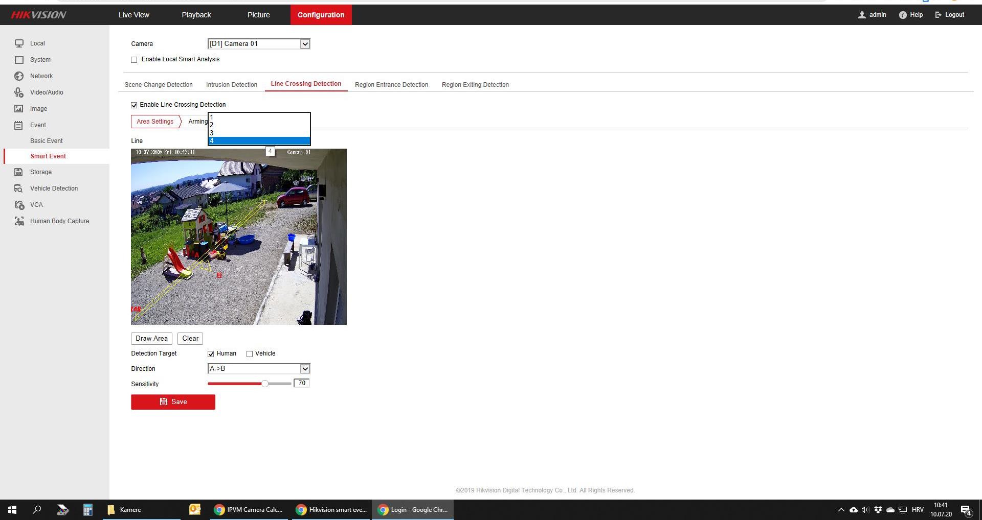

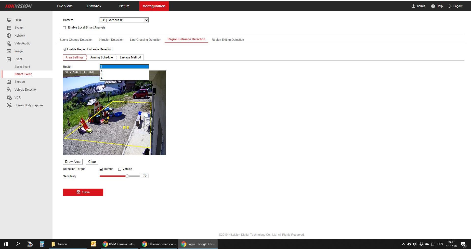

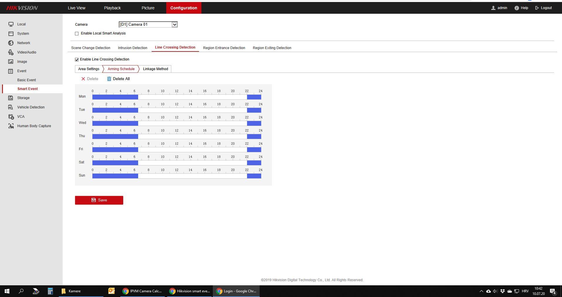

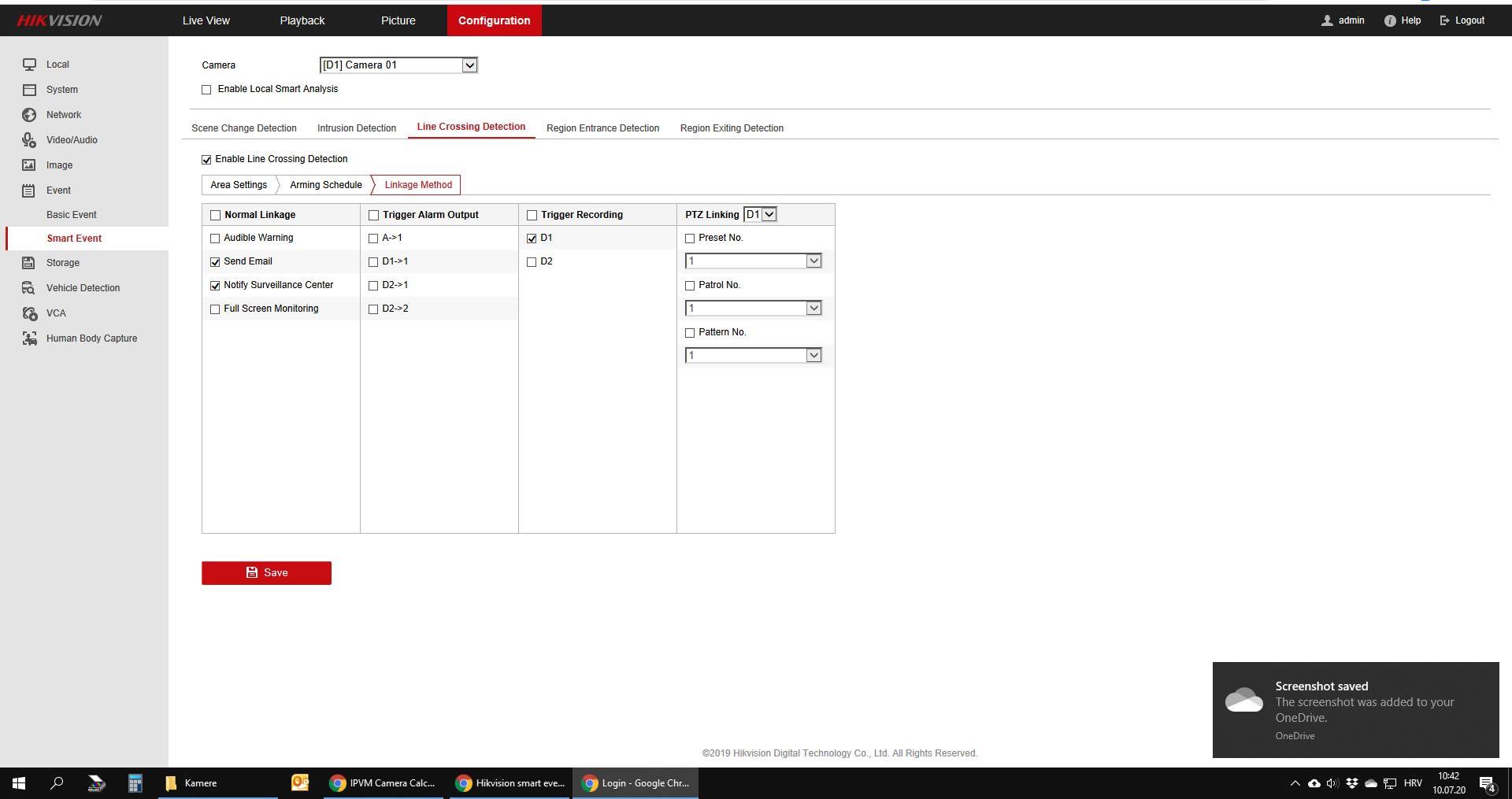

Just to clear this out, even I own acusense NVR (7616 NXI) it seems that it is better to set all on camera itself. In NVR you dont have option to draw min and max size. Yesterday I logged to camera directly and disable all smart functions and than set them through NVR (without min and max size). That didn't turn them on so I need to log to camera again. Through NVR you can draw lines, set arminng schedule, change sensitivity etc but it seems that is better to set it on camera like I said above. For example, arming schedule on camera is set 0-24h and after that on NVR is 00:00-06:30 and 22:00-24:00 and camera still keep here own armin schedule but You will be notified just in period scheduled on NVR. Please check the pictures attached. Regards.

@KamirZG I use IE addon in chrome, otherwise I will not get picture at all. Same situtation is even if I change settings locally using IVMS 4200. Just checked with Internet Explorer under Windows 10 (not Microsoft Edge) with same result. I am almost 100% sure that there is no option to draw min max size under smart settings on NVR which will aplly to camera. I will check once more when I get gome and will post results.

@KamirZG yes, I have monitor attached to NVR. I was playing with setting yesterday and for sure there is no option to draw min and max size through NVR. One more thing is annoying. If you change settings on camera itself (for example lines under line crossing, shapes under intrussion etc.., through web gui or IVMS 4200, they will not be stored to NVR until NVR is rebooted. On other hand, if you change them through NVR, camera will synchronize.

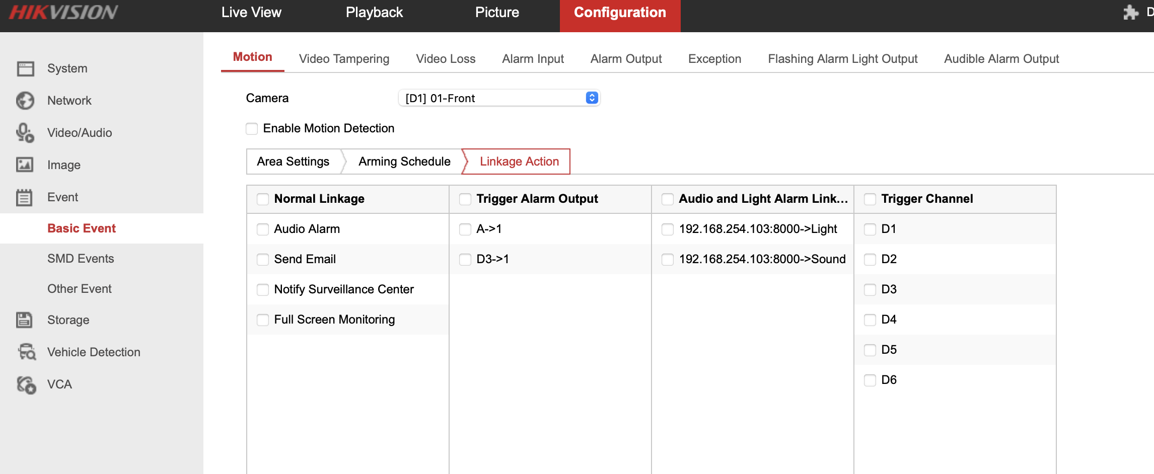

Plus, all my cameras has white light, and there is no way to link the D1 light tirgger when an event on D2 happens.
You've not been specific about your camera models. If they end LU then the white (ColorVu) LEDs can only be triggered on the camera with the event regardless of where you set it. If they end in LSU/SL then you can configure the strobe light on one to trigger from an event on the other as the image shows below (came 1 is selected but cam 3 light and sound are displayed for linkage):
