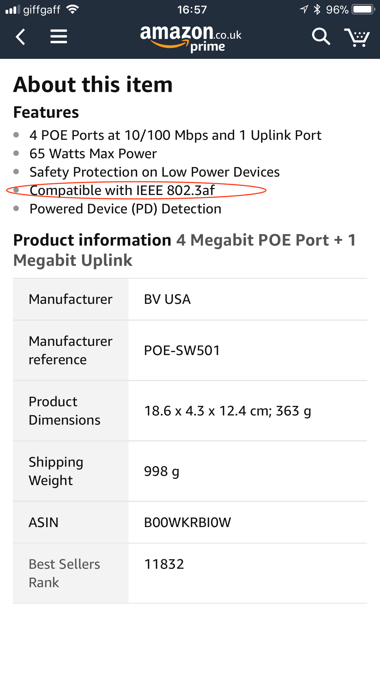

It says compatible see attached. Have spoken to Tara Brown this morning and she has suggested this
