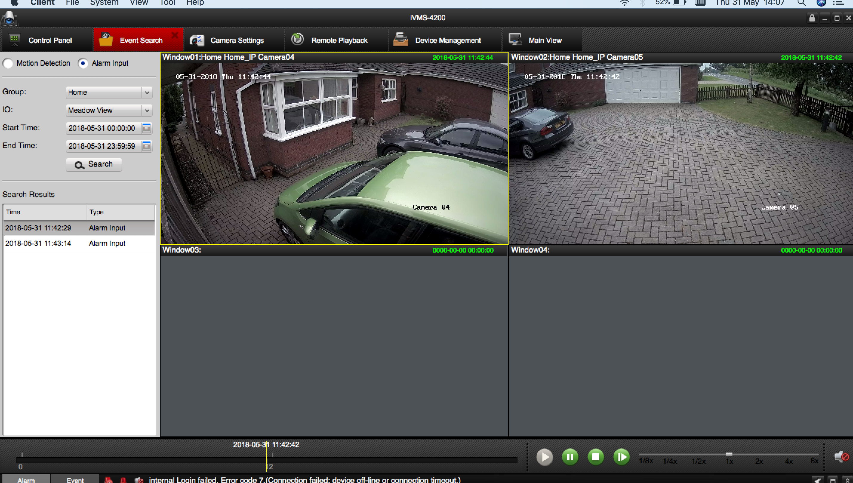

On a Mac you can search the alarm triggers independently of the cameras, as you will see in my attached screen shot. Just select the sensor and it will list all of the triggers. You then simply double click the search results and it will play back any recordings associated with that trigger. The sensor on the attached triggers 2 cameras.

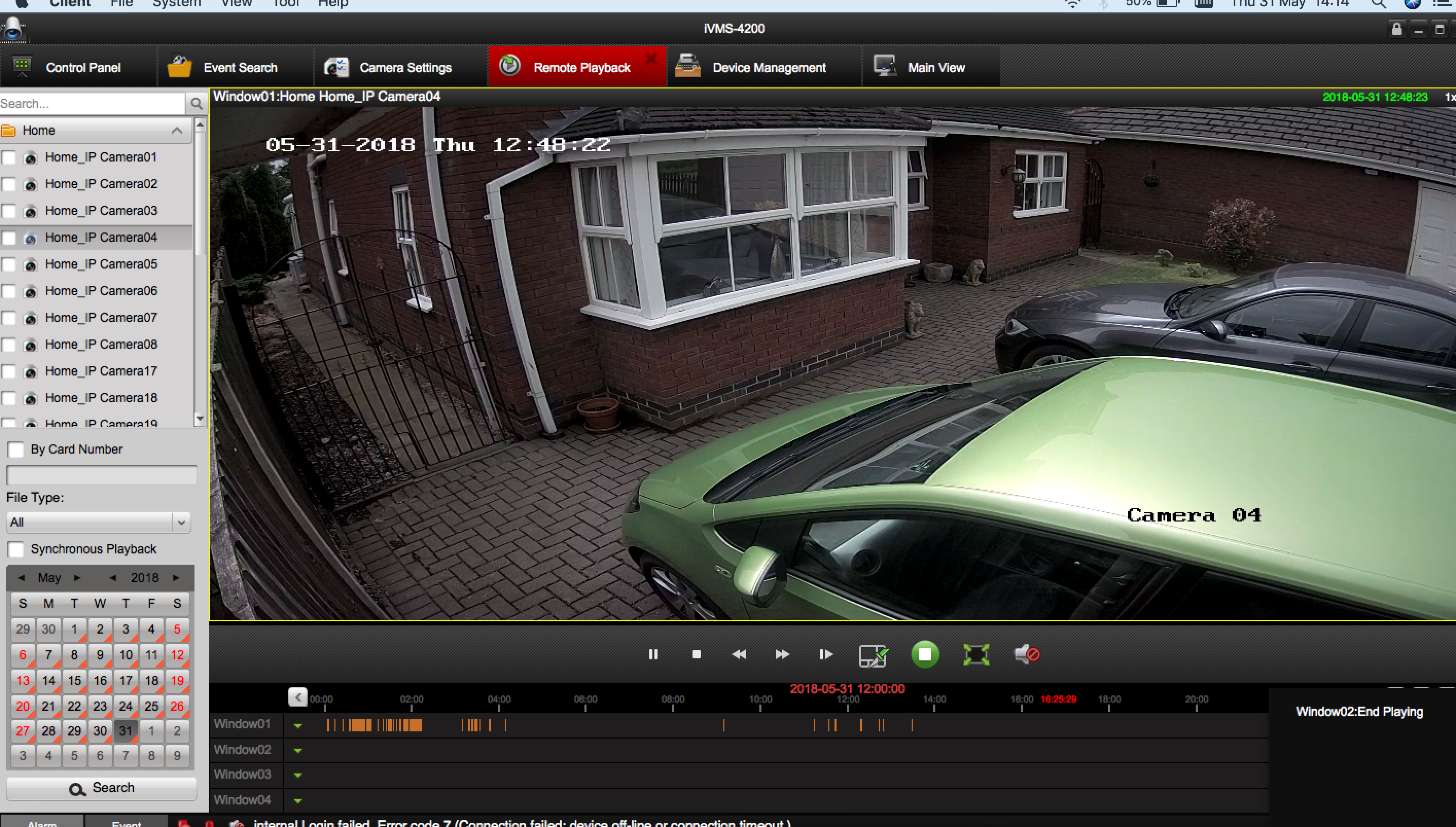

If you look at the recording timeline for the individual cameras then you will see its triggered throughout the day and even more in the night with every leaf the blows past etc. This is good enough for me rather than continuous recording.
The PIR's help me to narrow down onto a meaningful event which I believe is what you are after.
