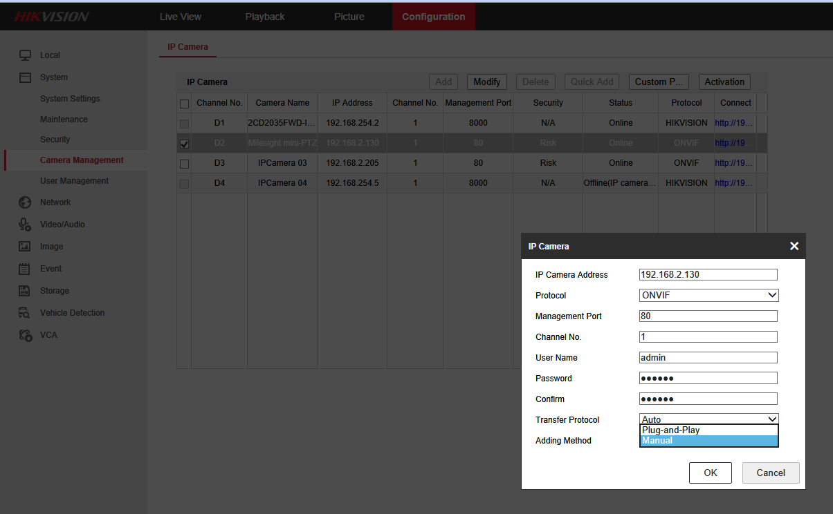

In Camera Management in your NVR you'll need to select each camera and check your settings.
If they were on a separate POE switch they will have been set to 'Manual' and their LAN IP addresses will have been entered.
You should be able to set them to 'Plug-and-Play'.
Select ONVIF.
Enter your user name and password for those cameras.

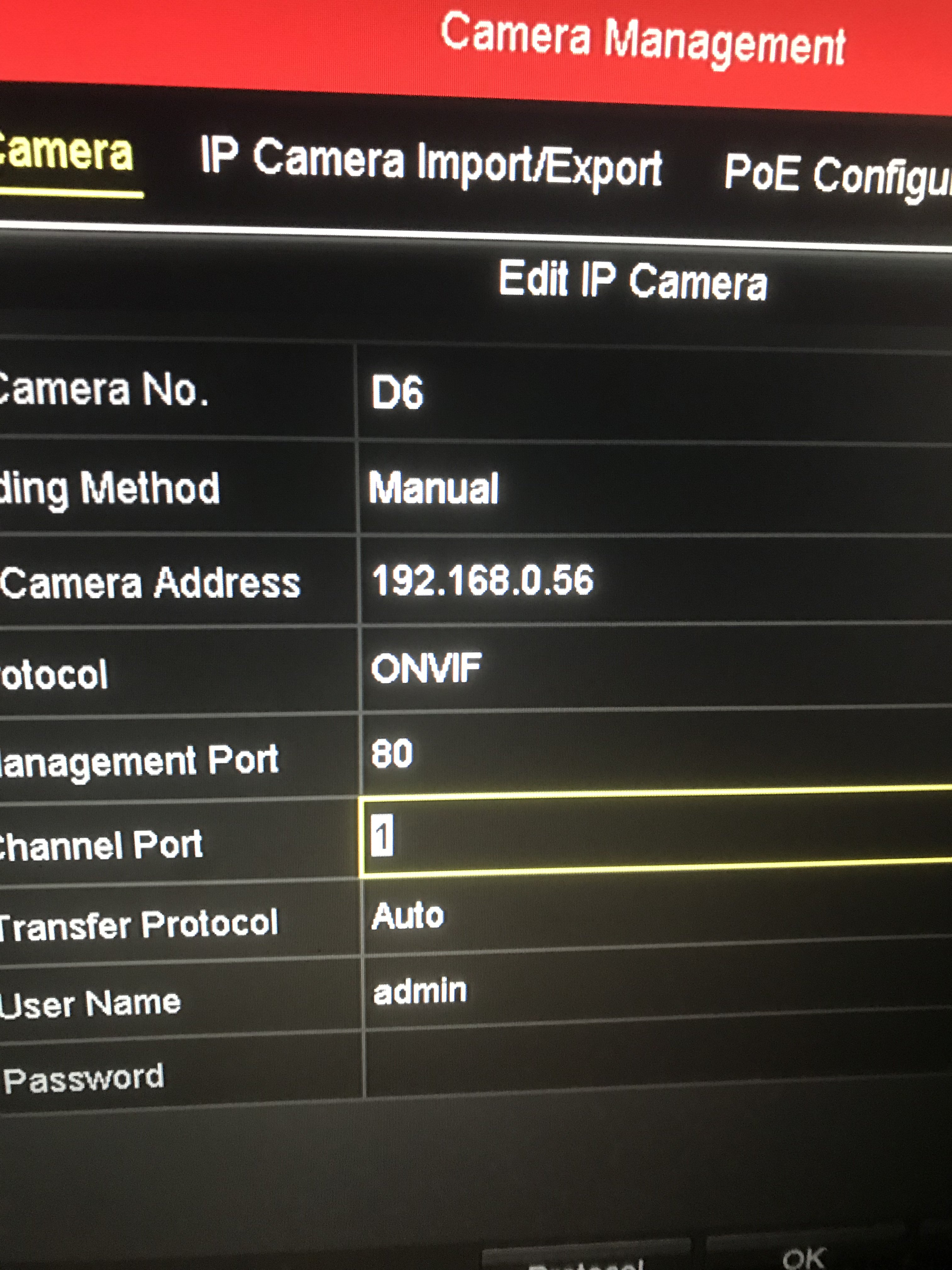

noticed that i have channel port ?
should this be changed to represent each input
as an example if have a picture here of camera no D6
and channel port is 1
should i change that to 6

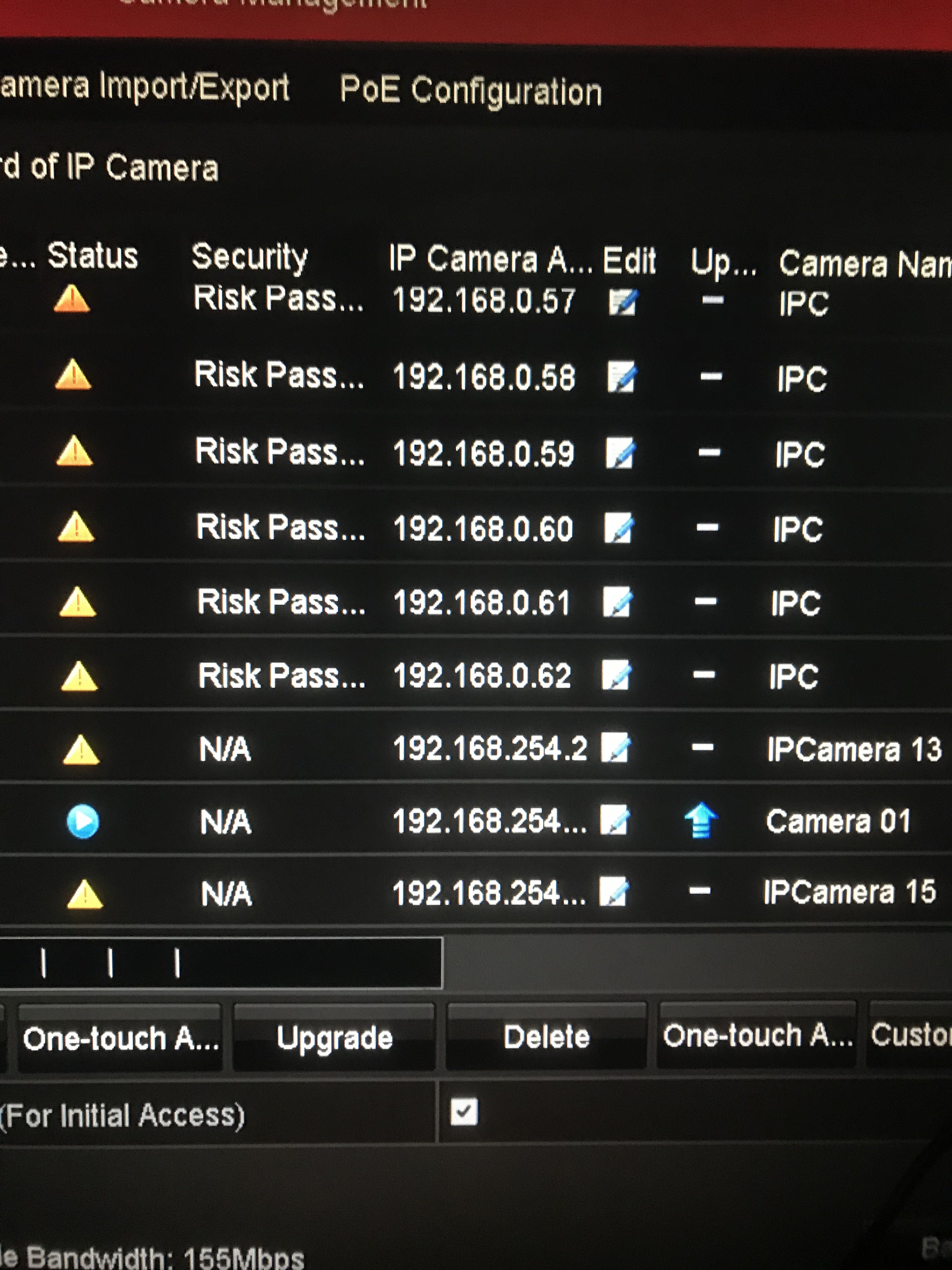

picture showing all the cameras that's without the cat5 from camera input to switch
confirmed yesterday if i take out the cat5 from camera input 16 to switch i loose all cameras bar the hikvision
so it appears i need to make sure each camera is in the correct relevant input
so cam input 7 needs to be ip 192.168.0.57
input 8 needs to be ip 192.168.0.58
easier said than done when i don't know which camera has been set to
but least I'm getting somewhere
