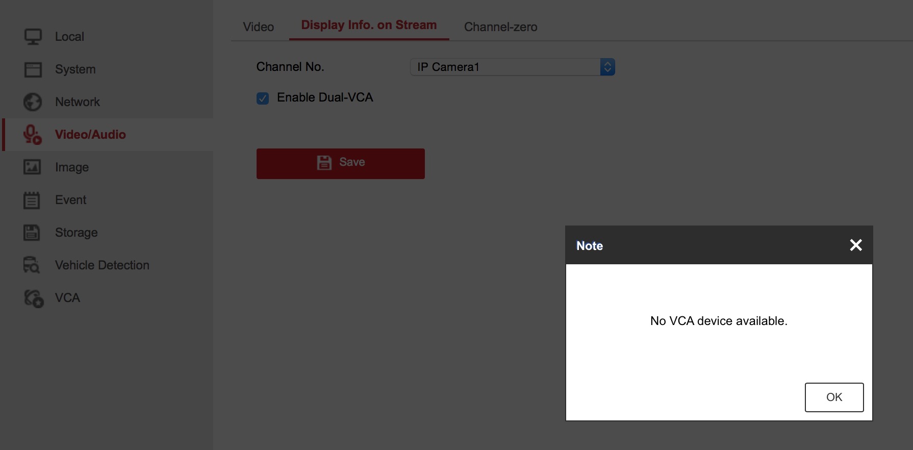

I've search around and one thing I found was to make sure Enable Dual-VCA is ticked, I have done this on both the Camera and NVR but still no joy with with VCA search however I can see the alerts come up in Maintenance > Log Information
I also read somewhere (can't find the source now) that for VCA Search you can only have recording set to event, VCA search will not populate with continuous recording. It's no big deal though
Also via the Web Browser Configuration > VCA I get the message 'No VCA Device Available'
