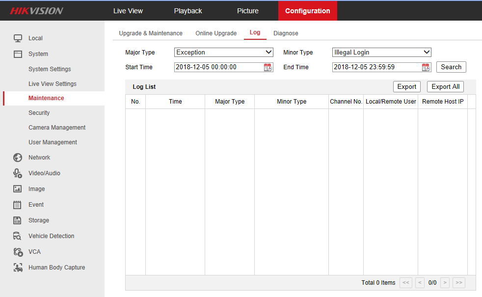

I've checked the logs on one of our demo NVRs here and see no such alarms:
(set your start date to search a much longer period than the 1 day my screenshot shows)
