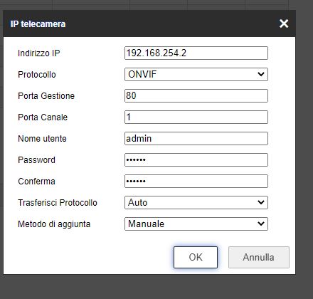

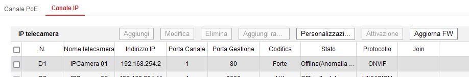

I did as you advised me: I set the first ip address indicated in the poe channels of the nvr to the ipcam. I also set the same password of the nvr, but the poe port continues to remain off. What protocol should I set to the ip cam?
Hi @gnesper
If ReoLink and/or SIMICAM don't appear in the protocol list, use ONVIF instead.
nothing to do ... it does not detect it and the port LEDs do not light up

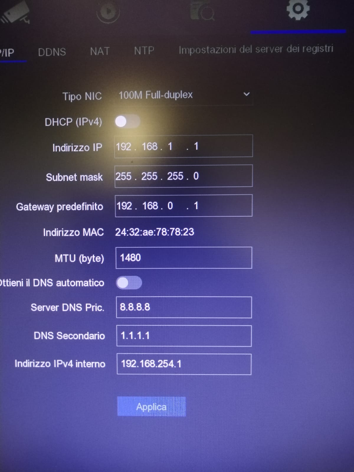

Can you go to the NVR network settings and confirm the NVRs "Internal network card IPv4 address"?
If that address is definitely 192.168.254.1 then the only other things that might be causing an issue would be:

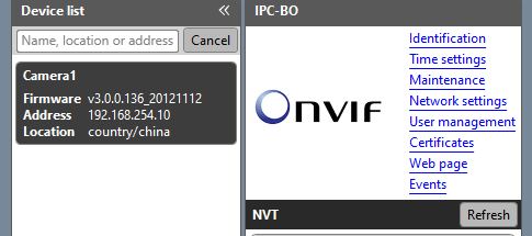

Hi @Dan
I confirm that the internal ipv4 address of nvr is 192.168.254.1 (picture1).
The camera's password is strong, it includes lowercase, uppercase, numbers and one special character.
I can confirm that Reolink is Onvif compatible and you can see the ip address (192.168.254.10 ) is in the same range ad nvr (picture2).

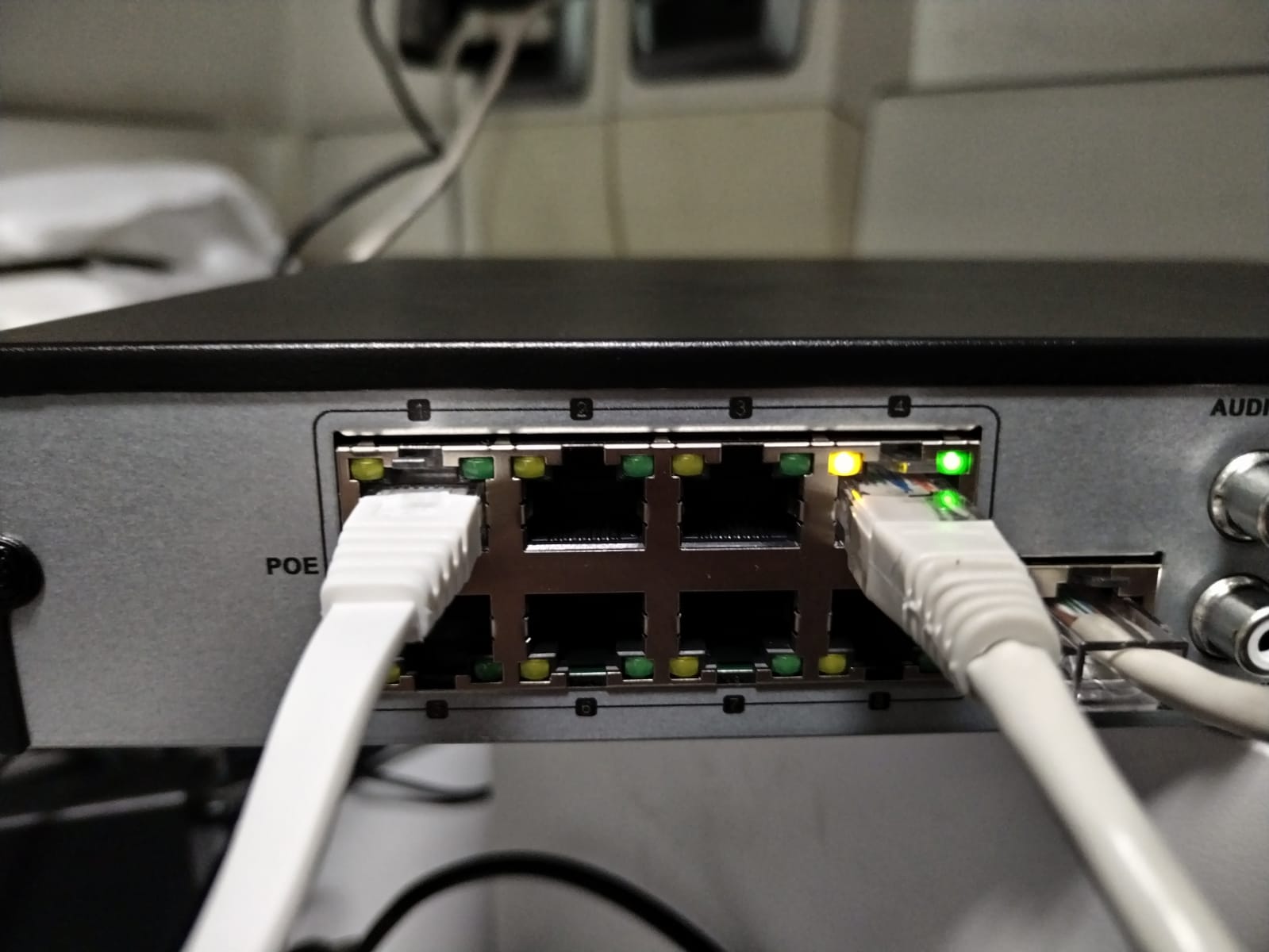

The problem I have isn't in the configuration part (infact, I can make it work without any problem through external poe switch) but when I connect the ipcam directly to the nvr's poe ports.
As you can see in the picture3, in the port1 there's connected the ipcam poe but there's no lights on, as if there wasn't nothing connected
meanwhile in the port4 there's a switch connectec and the lights turns on without problem.
To me it seems like the nvr can't turn on the device connected, but it works only like a classical switch.
I want to know if the poe ports are malfunctioning or the ports light turn on only it connect a original hikvision ipcam poe.

(I should also point out that in the first screenshot of your network settings, it looks like your IP address & gateway address are on different ranges - 192.168.0.xxx & 192.168.1.xxx - I'm not sure which is the correct range so you are probably best off enabling DHCP at the top of the page, save settings, and then once the network details have changed you can disable DHCP and save settings again)

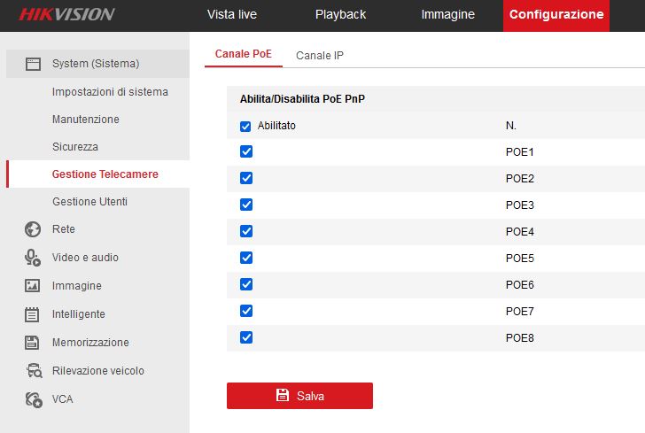

I tried to connected only ipcam to the nvr's poe ports (without external switch) but the lights remain off and the poe ports settings are enable (picture1).
Don't worry about the ip configuration, it was just a test without internet

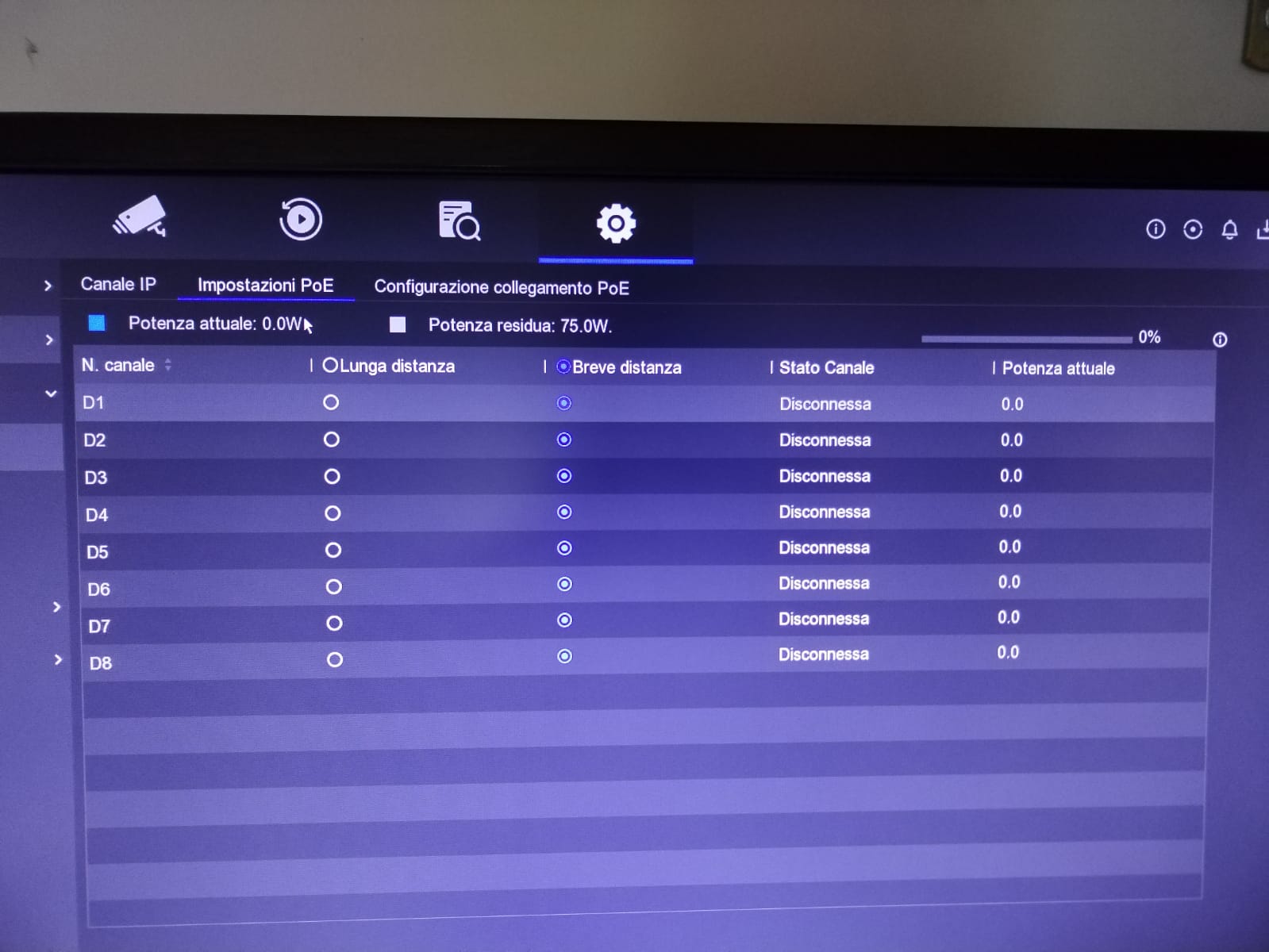

I just did it.
After doing the first configuration, still no sign of life coming from poe ports.
In the picture you can see that there's not power going out, it makes me think there is something wrong with nvr.
What do you think?
If you are plugging cameras into that port and you are not seeing any PoE power being used then that probably suggests a fault, we would recommend speaking to the supplier you bought it from.
