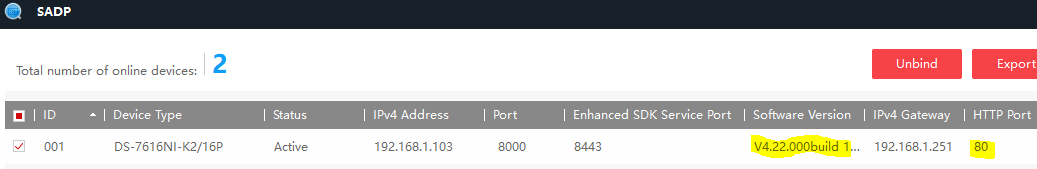

Just to make sure we go the right route please get back to me on the following:
What does SADP report as the Software Version and the HTTP Port as?
When you originally setup your NVR, it prompts you to save a GUID file to USB. Do you remember doing that and if so, is it still available?
Sounds like you tried this but please confirm - Are you able to connect the NVR via the HDMI or VGA port to a monitor and access the system directly?

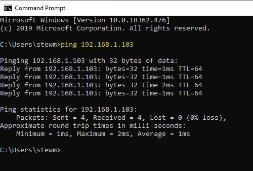

When connected to the same range, open a cmd prompt in Windows and ping the NVR. Do you get a reply?
Software version
V4.21.005build 190509
http Port
80

When connected to the same range, I can ping the NVR. Just not able to get IE to display anything at all.

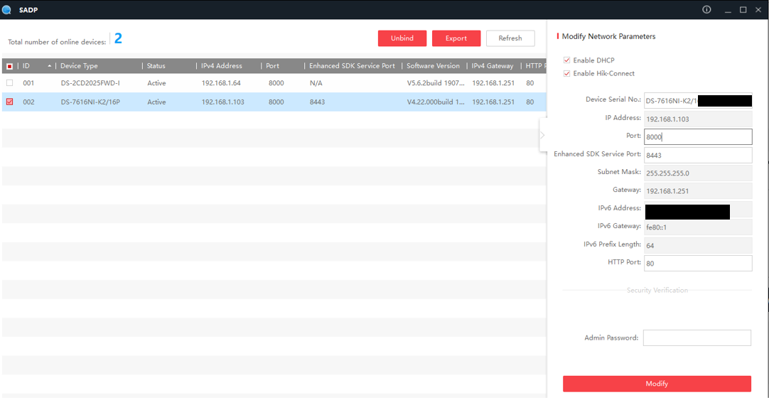

Forgot to ask you earlier - in SADP, are you able to modify the IP setting (or any setting) using the admin password that worked prior to the firmware upgrade? What error does it report when you try? Highly unlikely, but try the old default '12345' too.
It doesn’t allow me to change IP addresses and when entering password, SADP said incorrect password even though I know it’s the right password.
Not being able to authenticate limits the options going forward. It pretty much excludes Hikvision's Batch Configuration Tool V3.0.2.6 which is able to reset the NVR but needs a working admin credential. Give it a try anyway.

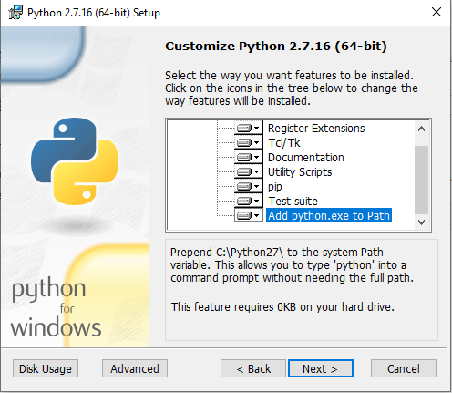

Make sure you have Python 2.7 64bit installed. The socket error may be related to bitness. Uninstall your current version if so. If you have the 64bit version installed make sure you have 'Add python.exe to Path' set.

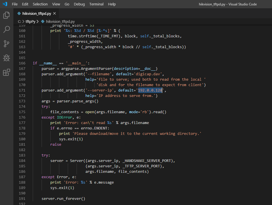

Install a editor like VSCode as you will need to change the server settings in hikvision_tftpd.py
Line 171 needs to be set to 192.0.0.128

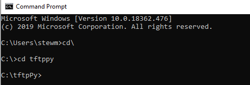

Open a command prompt and navigate to the folder you saved Scott's tool to.
Make sure you have the digicap.dav file (v3.4.xx) in this folder.
With the NVR connected directly to you laptop's Ethernet port run:
'python.exe hikvision_tftpd.py' from the prompt.
Let me know what happens.
