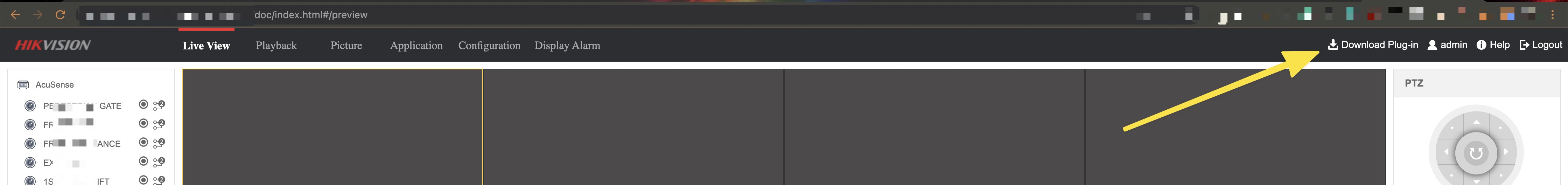

Is Apple not supported, simple as that, or am I missing something?
When I navigate to the NVR's browser page, I can see there is the option to download the plugin, however, it is a .exe file which is windows.

Hi @Thor
Can you please clarify the browser that you're using (looks like Chrome?), and also the NVR and firmware installed on it?
Hi @Thor
Safari, Chrome, Firefox, all the same on MacOS.

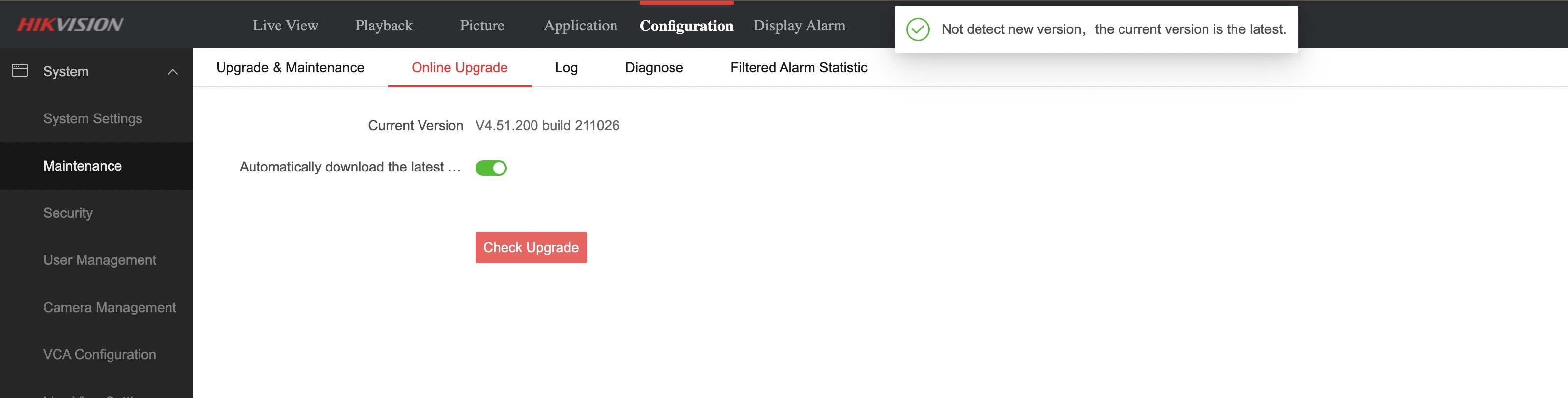

Mmm, my NVR says V4.51.200 build 211026 is the latest firmware, so unless there is a bug in the Hikvision system?
I tried that plugin, does not work, unfortunately.
It isn't, the version I linked is definitely latest - that "Check Upgrade" button has unfortunately never worked properly.
You need to manually load the firmware file on via the "Upgrade & Maintenance" menu, see the guide linked in my last post for the full instructions.

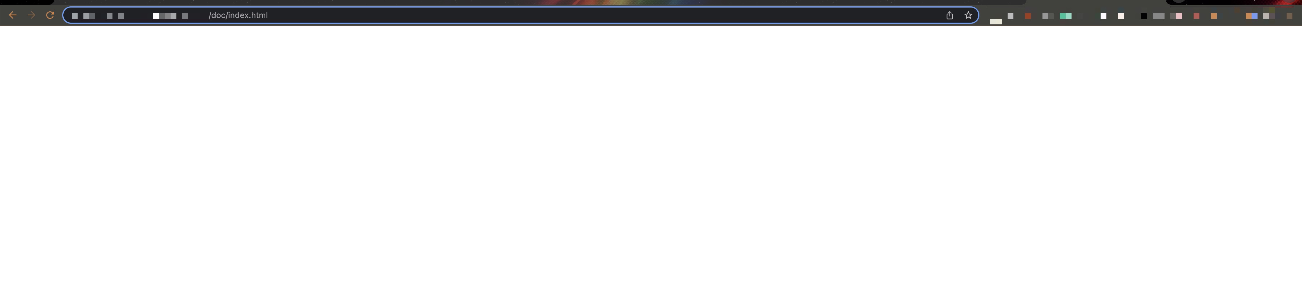

Browser access no longer works.
Fun.
Just a blank screen now

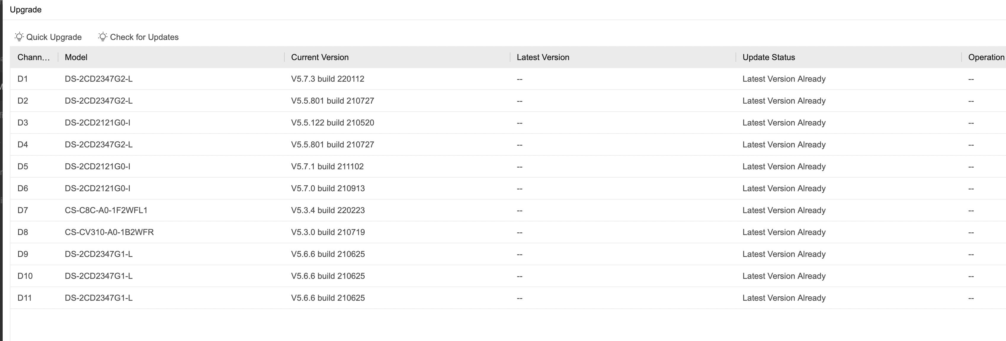

Managed to get in on Safari, the playback / video / vca still doesn't work but I see a new option now to upgrade cameras from the NVR !
Although... it says they are all up to date, but I think Hikvision is lying, so the feature is essentially useless?
Yes, you're right - you need to log into each camera directly to upgrade them.

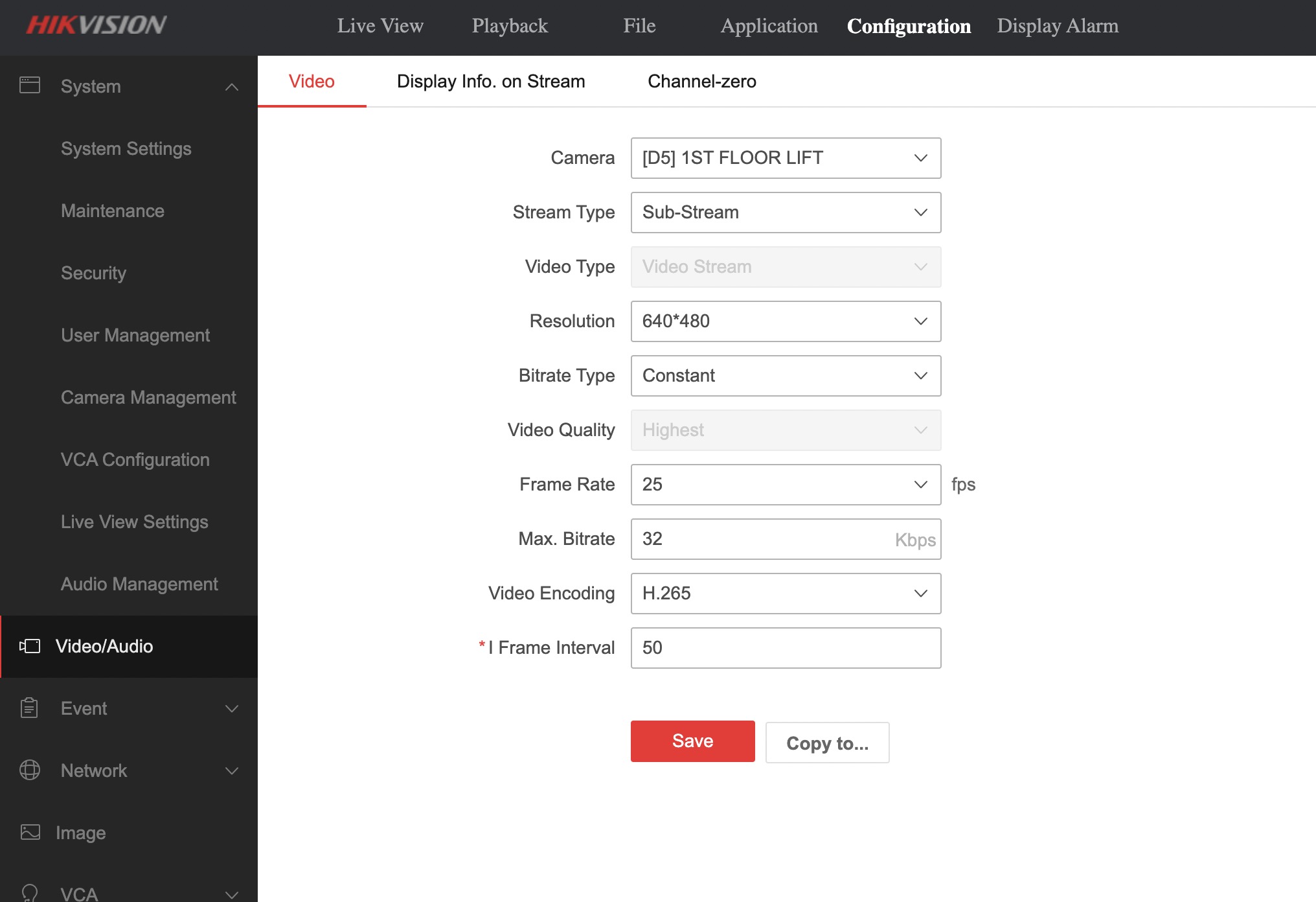

If I set the Max Bit rate for the substream in the NVR, will that stick?
Somehow every now and again, the live view on the Monitor gets fussy and then I notice the Max Bit Rate went back to 32 instead of 512 that I saved it to.
Can it be the cameras reset it? ( Ignoring the NVRs setting? )
Yes, you should only change those video settings at the NVR level.
If you change them on the cameras (when logged in to them directly), the NVR settings will return to the default.
So, change it on the NVR, leave those settings alone on the cameras, and it should stick.
Very odd, because that is how I understand it and exactly what I did ( I never actually logged into any camera yet ), so something is overriding those settings for whatever reason, it happened on V4.51.200 as well, kind of was my motivation to upgrade the firmware, I know live playback on Apple will be a long shot, but I figured maybe it solves this issue.
Back to the drawing board for me. Unsure if the installer's Hik Pro Connect, could maybe interfere, they won't deliberately change it back, I am more thinking maybe that app has some persistent setting that overrides the NVR periodically?
