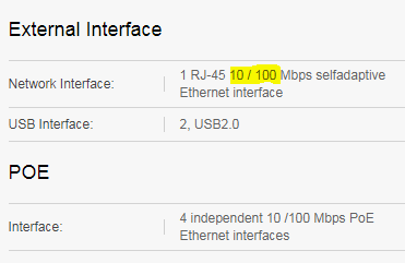

I have a "Hikvision DS-7604NI-K1 /4P" and 2 x "Hikvision DS-2CD2055FWD-I" 5 MP bullet cameras, but have had this issue since I installing it over a year ago.
I currently have the NVR connected to a Linksys unmanaged gigabit switch, which is connected to a Fritz!Box 7490 using CAT6 cabling.
For testing purposes, I even connected the NVR directly to the Fritz!Box, using a brand new CAT6 ethernet cable and still the NVR is stuck @ 100M Full-duplex.

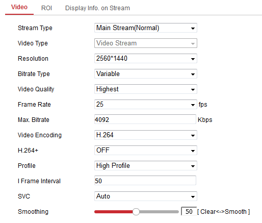

Also, both cameras have started to go "blocky and flicker" when selecting HD in the Hikvision app
